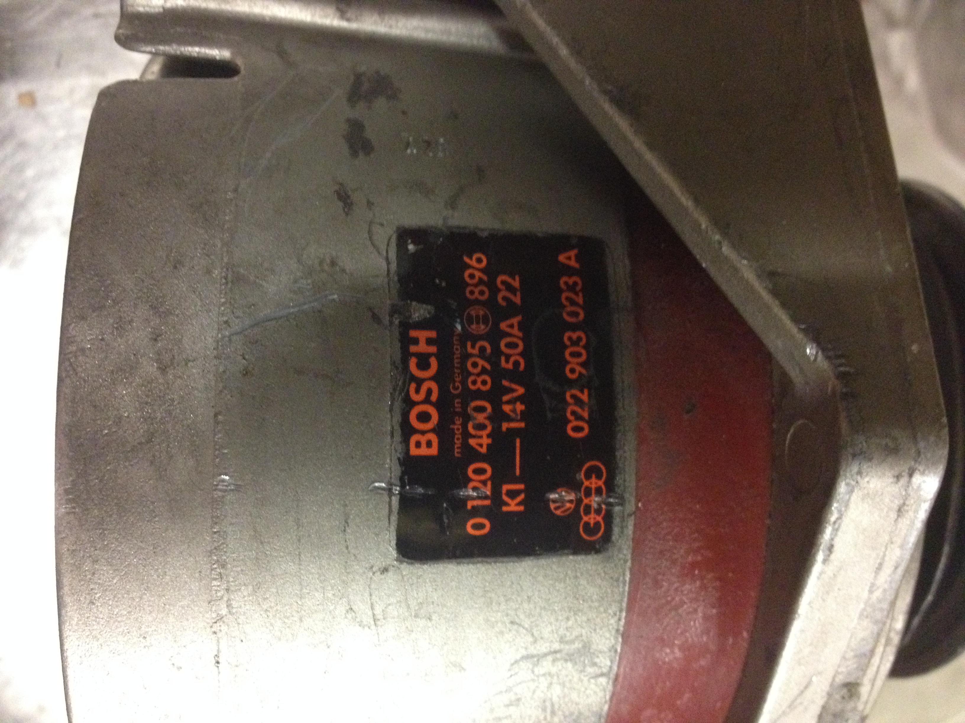

Click to view attachment Ok she is OUT.
BTW: if you have FI and heat exchangers and aux fan it ain't near as easy as McMark makes it in the "914 info". But his post certainly helped.
HE has to come off then the cussing gets really loud!
Ok it says 50 amp. Everything i saw today was talking 55 amp.
Do I need to upgrade to 55?
