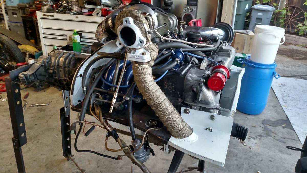

Biggest issue I see is he is running the stock fuel injection.

I've prepped plenty of T4 heads for turbo engines. The heads aren't well suited for it, but with a small bore and low revs they can be made to work for a while.
T4 heads are inherantly weak in the ex port area and as a result are extremely vulenerable to elevated EGT's, which all turbo engines are prone to. This is why small bores work better than big bores, as the bigger the bore, the weaker the head.
Thermal coatings are a must!
Can the MPS take positive pressure?

Seems to me that when Jeff Shyu was doing his, he used a rising rate fuel pressure regulator.
He also was playing with the reference air pressures of the MPS to get it to work with the turbo. In stock configuration the MPS references intake manifold pressure and ambient air pressure on either side of the diaphragm.
For the turbo set-up Brad Anders suggested to him to use intake manifold pressure and some other condition...I want to say it was to close up the two ambient air vent ports for more of an absolute pressure reference, but I could easily be wrong and that does nto sound right. I don't understand how the correct pulse width could be attained using an MPC based system.

Seems to me that when Jeff Shyu was doing his, he used a rising rate fuel pressure regulator. ... I don't understand how the correct pulse width could be attained using an MPC based system.
If the fuel pressure is right, you don't really need the correct pulse width. But fuel pressure is a pretty coarse adjustment, I think...

I agree. Granted people have been doing it on Honda's and other 4 cyls for years. They generally all blow up though.. Its not a long term solution.
I think the only real solution is a standalone system like Megasquirt. Being able to adjust the timing will really help low end torque and the ability to run lower boost for a higher power gain.

No intercooler that I can see, that it going to be some hot air going into that motor for sure!
