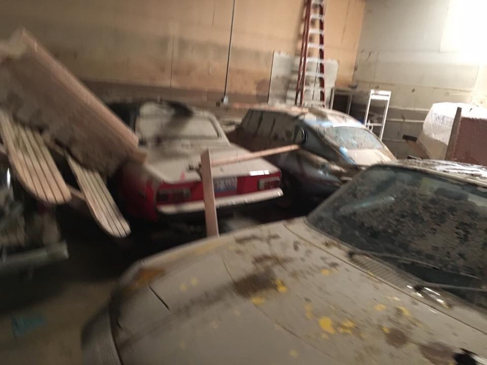

A friend of mine just moved down to Baton Rouge, LA last month, and had his cars in storage as they were having a large garage built at their new home. Of course, they were involved in the flooding up to the top of the windows. Besides his 914 2.0 and his Porsche tractor, he last a Jaguar XKE, Jensen Healy, 67 Ford Mustand, and a 35 Ford Coupe. At least their home is on higher ground and didn't flood so they are OK!
Has anyone ever had any luck resurrecting a flood car? Since his was nice and straight, I wondered if it could be stripped to a bare chassis then rebuilt? Same ? about he Porsche tractor.

The mechanicals of the car can be salvaged if they are dealt with quickly following the flooding. The issue with most cars is the wiring and the electronics. No way to really assure yourself that moisture hasn't done any damage to these items.
Since the 914 is much less complicated than other cars, it is possible that the car can be resurrected. I would be more concerned about the XKE and Jensen Healy since they are much more valuable cars,and parts are relatively harder to come by for them.
The Porsche tractor can be easily resurrected. I believe that you simply have to drain the water and then fill the block with oil to guard against corrosion.

I just got my friends 2012 Camry back up and running from the flood and will start on his 993 next week. He only had about 18 inches though. He was smart enough to disconnect the battery on the 993 so I hope his computers will be ok. With the Camry the air bag module is in the center console and it was full of water but I was able to take it apart and let it dry fully and it is working good now. The key to a flood car is you must take it down completely to let everything dry out. If not the upholstery will stink. If not the electronics will continue to short out or corrode. You also must ensure you have all new fluids if water entered the sumps. We got lucky with the Camry as the water was not higher than any of the vents to the trans or engine. If I can be of any help let me know.

It's hard to find straight cars. Strip the 914 down to bare bones. Build it again.

it might be a good candidate for the e-coating process, the dipping is suppose to get everywhere. just need to remove air mufflers in the longs

save it. Every one of those cars should be stripped of their interiors as quickly as possible, fluids drained from the crankcases + transmissions, refilled and turned over by hand if nothing else. Get oil on all the internal surfaces as soon as possible, including in each cylinder. The next thing would be drying out the wiring looms, but not as time-sensitive as the upholstery and metal bits.

Yep. Since that flooding was freshwater they absolutely can be saved.
Anything that can hold water has to be taken out immediately
Anything that is metallic needs to be dried out. Anything that s mechanical needs to be oiled.

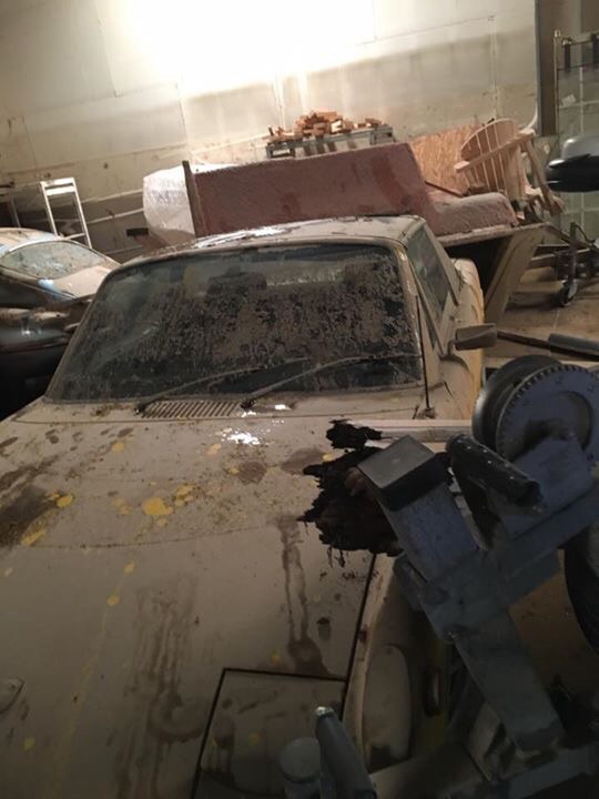

Looks savable, but with lots of cleaning. Again if you or he needs help with these let me know. The 997 and 991 Porsche is the only model I have not yet worked on so I know Porsches. I have also restored many other makes including British cars. Am currently restoring a 1951 Jaguar XK120.

If he can get those cars gone over soon it's always better than a flood car 8 months or a year after the fact.
I'd take a flood car project over a rust bucket any day.

It's not water alone that's the problem, it's water + time. I'd keep the cars(s) I wanted to spend immediate time on, and get the others to people who had immediate time to rescue them. Best of a bad situation, rescue the cars, make some friends in the process. Cash that chip in on another day when you can build your collection up again.

strip it and redo it.
The inner heater baffles are wrecked, so open up the longs and remove those, then dip the car and start again..

So let's think about this is purely economic terms. Let's say the car is a primo 2L and worth $15k, and is insured for $15k. Ins co pays out $14k after deductible, you're down $1k. Let's say you can buy it back for $1k, now you're down $2k.
How much work, time, money, parts, effort, repairs are you going to have to do to that thing to get it back to a $15k level? Can you completely strip and restore a 914 2L for $13k just to break even?
Maybe you're bored, maybe you look forward to doing that and it's a hobby, but how much in repairs and parts are you going to spend out of pocket? I mean you're talking major disassembly here, maybe even an engine overhaul, just to get it back to a level of what you could buy if you took that $14k and bought another one. And then you have a car on a salvage title.
I cannot even imagine the value of taking on such a project, unless it's just something you want to do.
Just jet it go. Put the VIN in the database with that photo and walk away from it. There's another one just like it around the corner.

Sorry Guys, but as an insurance adjuster I disagree. If the owner wants to get another car of the same make and model and the insurance company will allow the owner to keep the car based on state laws. It all depends as well on the salvage value that the insurance company has determined for the car. In his case, the salvage lots most likely are flooded as well, and it will be
6 months before the salvage yards are anywhere close to handling business normally. This affects directly how the insurance companies are able to handle these vehicles when it comes to flood losses. If the new/used replacement car needs parts, the owner already has a resource. Of course, this is also implying that the owner has properly gotten the flooded car dried out in short time frame. In my experience, there are several factors to be considered...
Take lots of pictures of the car before doing anything! Document the water line, and how high the water was on the car. Use a tape measure, and show the tape measure in the photographs. Make sure the photographs are well lite, and sharp (in focus). Provide the adjuster photos of the car prior to the damage, otherwise the adjuster will use average values unless you have an agreed value policy. Stated value policies are useless. The adjuster most likely will use a evaluation from Mitchell, or one of the other valuation providers. If you don't agree on the evaluation amount, request a copy of the evaluation, and ask them to provide photographs of all the comparibles that they use. Most likely they can't, and you will be able to use that fact to your advantadge when negiotiating a settlement.

Fresh water and limited electrical. Piece of cake. With all the repop parts available now I would save it. I will be sending a 914-6 to the e-coater soon. I will document the prep on the site. If it was a solid car save it.

Nothing is impossible. Just don't roll it outside and let it sit for 5 years.
