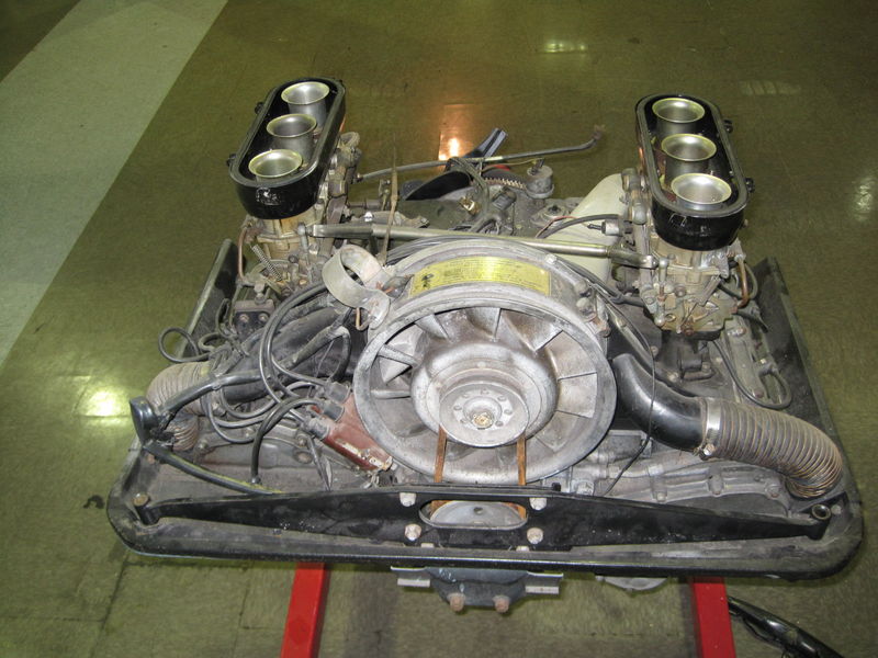

I have the chance to buy a 2,2T motor.
Is this a good motor for a 914 6 conversion? Its not cheap so I want to be sure that its not wasted money. There is also a 2,4 available and its a bit cheaper. Advice required

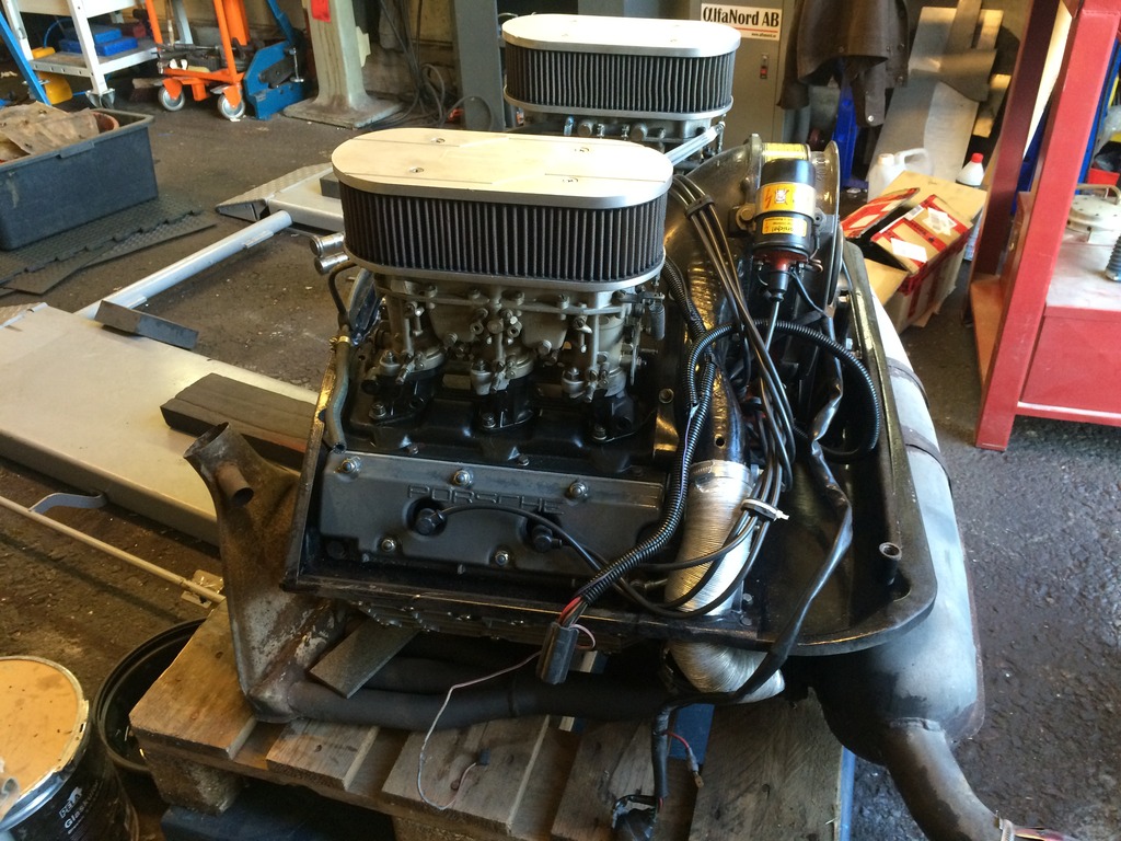

I picked up the motor for my 6 conversion . Its a 2.2T motor # 6110444.
It seems to weigh a lot, stupid question but i have to ask it, will I need to upgrade the springs?
IPB Image
IPB Image
IPB Image
Probably. Maybe try 140# Not very expensive. $100-120
