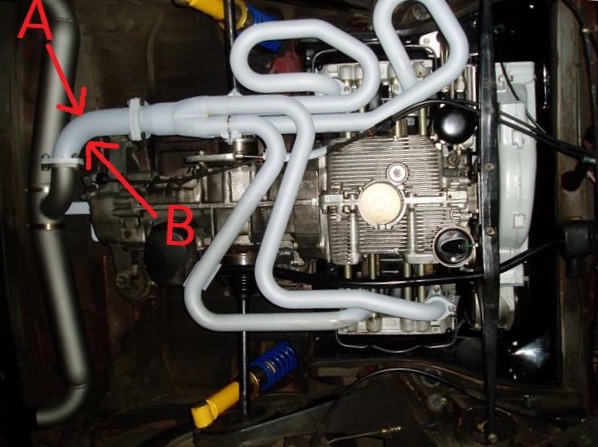

Finally about to get the green car on the road! I'm in the middle of purchasing the final bits I'll need to finish her up, one of those things is the "t-bar" looking mount for the full Triad system I've got- mounts to the transmission where the boomerang would normally be and then uses hose clamps to attach to the muffler to give the whole system some support. My pre-owned system didn't come with that piece, so I'll need to fab something up, anybody have a picture or measurements for that piece?? Here's the only view of it I can find....

Philip, when using the 4-1 headers from triad (eurorace style) the boomerang bar doesn't get used, there is a different method of supporting the exhaust system and that's what I need to see/buy/fabricate...

good luck, post some larger pictures, im wondering what the header and the muffler look like with out the stock flanges that normally are used to attach one to the other
And the only larger pic I can find, from another thread here...

Dave doesn't build the headers anymore from what I understand, and says he never really found a "good" bracket setup...
I've found eurorace brackets that they sold to go with their headers, but only to use with a megaphone, not sure it'll really do what I need it to do with the Triad.

The 75-76' brackets are the widest and might give you enough to bend the ends rearward to fab something up.
Cable spacing so it doesn't burn up looks like a hassle.
