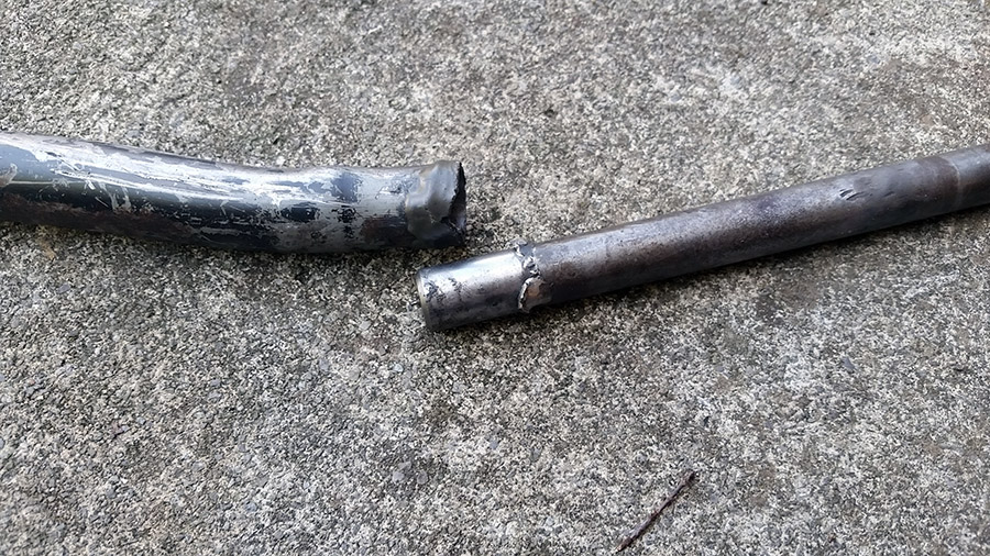

Another possible source is the weld at the rear of the shift rod where tube meets shaft. This weld can break. The rod stays pretty much in position but can rotate somewhat. I had this happen to me.

Yep, this happened to me and I just got done swapping shifter rods last weekend. Shifting slowly deteriorated over a couple weeks time. Finally couldn't hit R and 1st.
