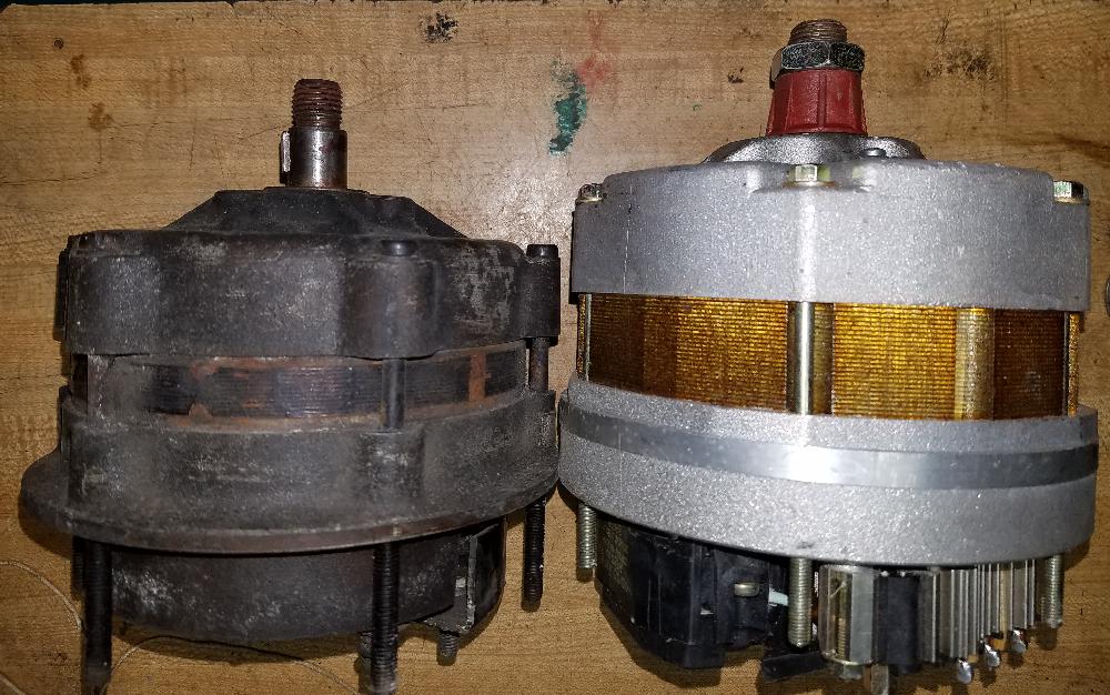

Sep 13 2016, 02:57 PM
To illustrate Jeff's point
bosch 914/6 next to paris-rhone (used 1984-89)

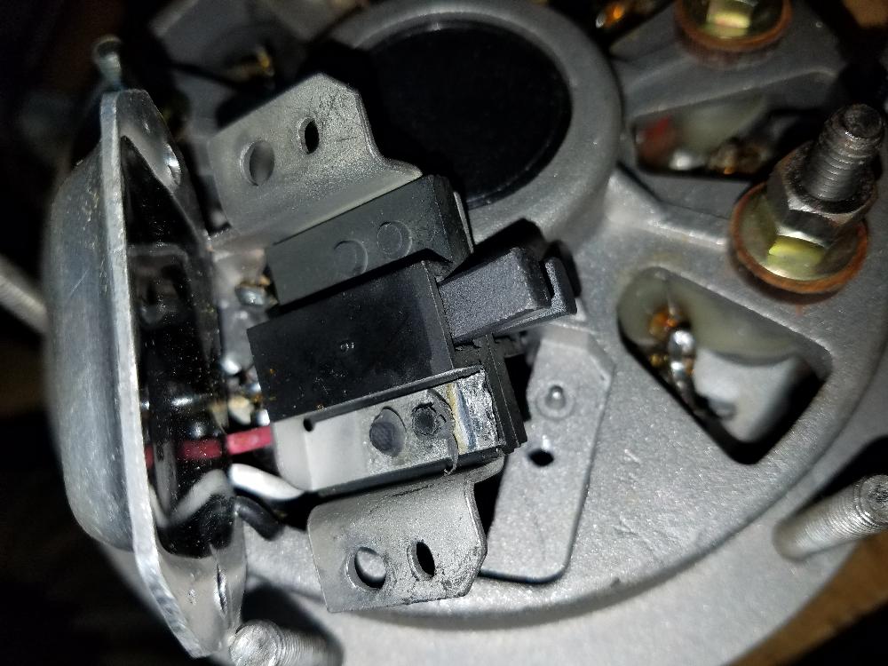

Sep 13 2016, 03:05 PM
many years ago i found a source for internal regulators that I used on the SEV-Marchal units when I rebuilt them. I just opened one up but there is no information on it.
click here.
