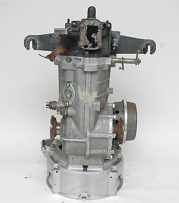

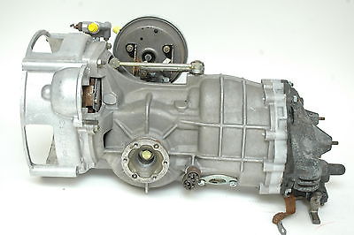

Did a quick google search and found a few things..
Here are a couple of pictures of a 914-6 sportomatic.
Externally, the rear cover looks very similar,
so it may be the same ?????

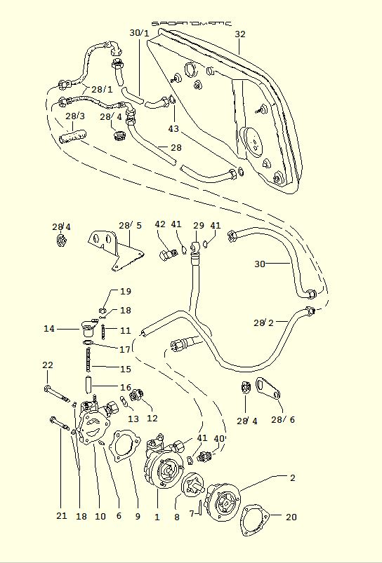

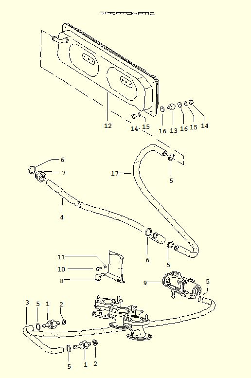

The one thing that everyone here is forgetting is there is no "transmission fluid" for a sportomatic. It uses the engine oil. You will have to figure out how to send oil from the engine to the trans. The 914-6 and 911s with sportomatic transmissions have extra fittings on the oil tank that hook to the transmission.
And aftermarket carbs are out too. You have to have a vacuum tank and special manifolds for the webers on a 6.
The flex plate would be easy. The sportomatic is the same tech as the VW automatic stick shift. Get the flexplate from a bus with the automatic stick shift.
ClayPerrine
Here is the PET diagram of the oil system.
And the Vacuum System.
This is not a trivial task on a six. You have to find all the parts before you can start.

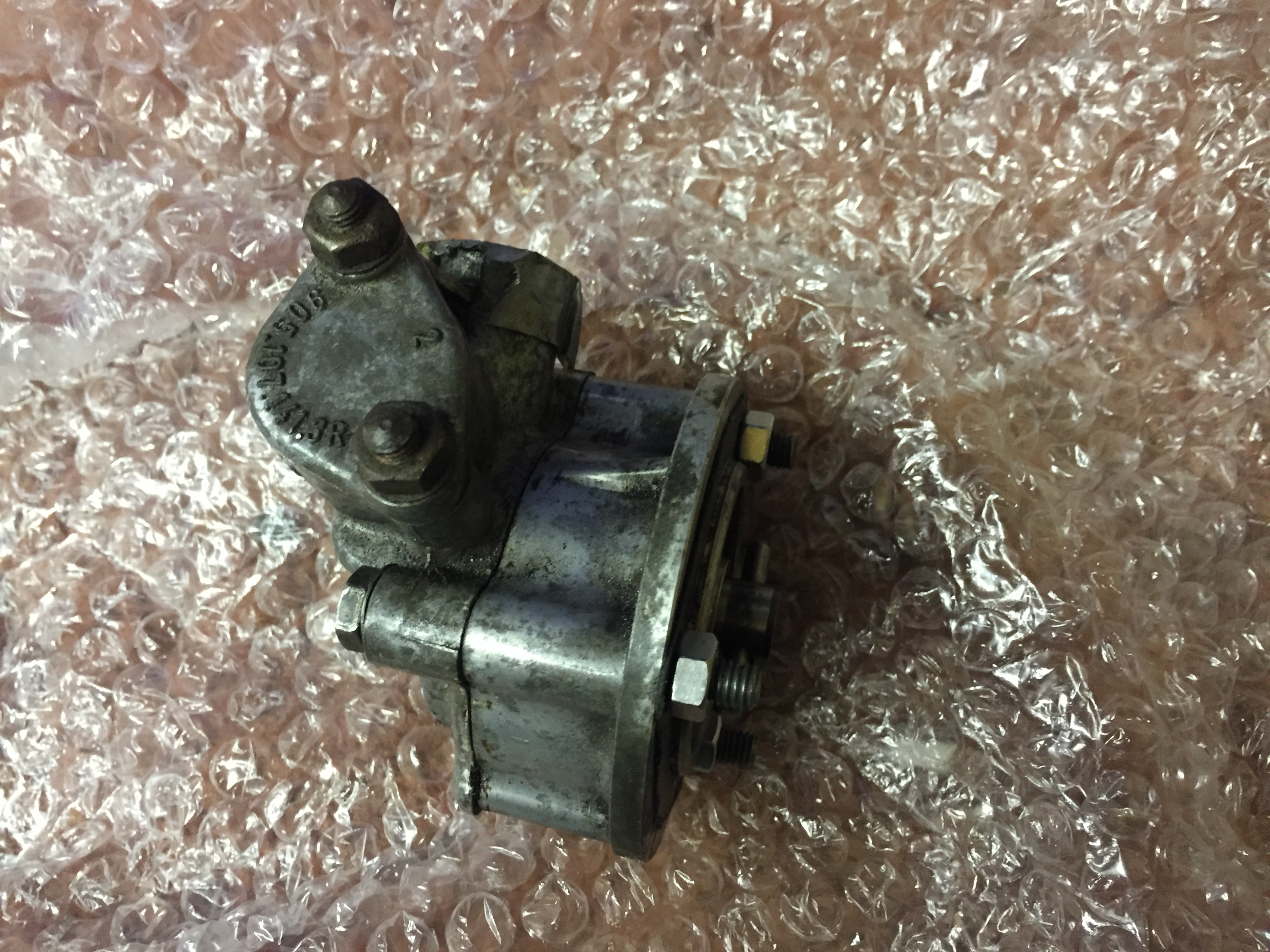

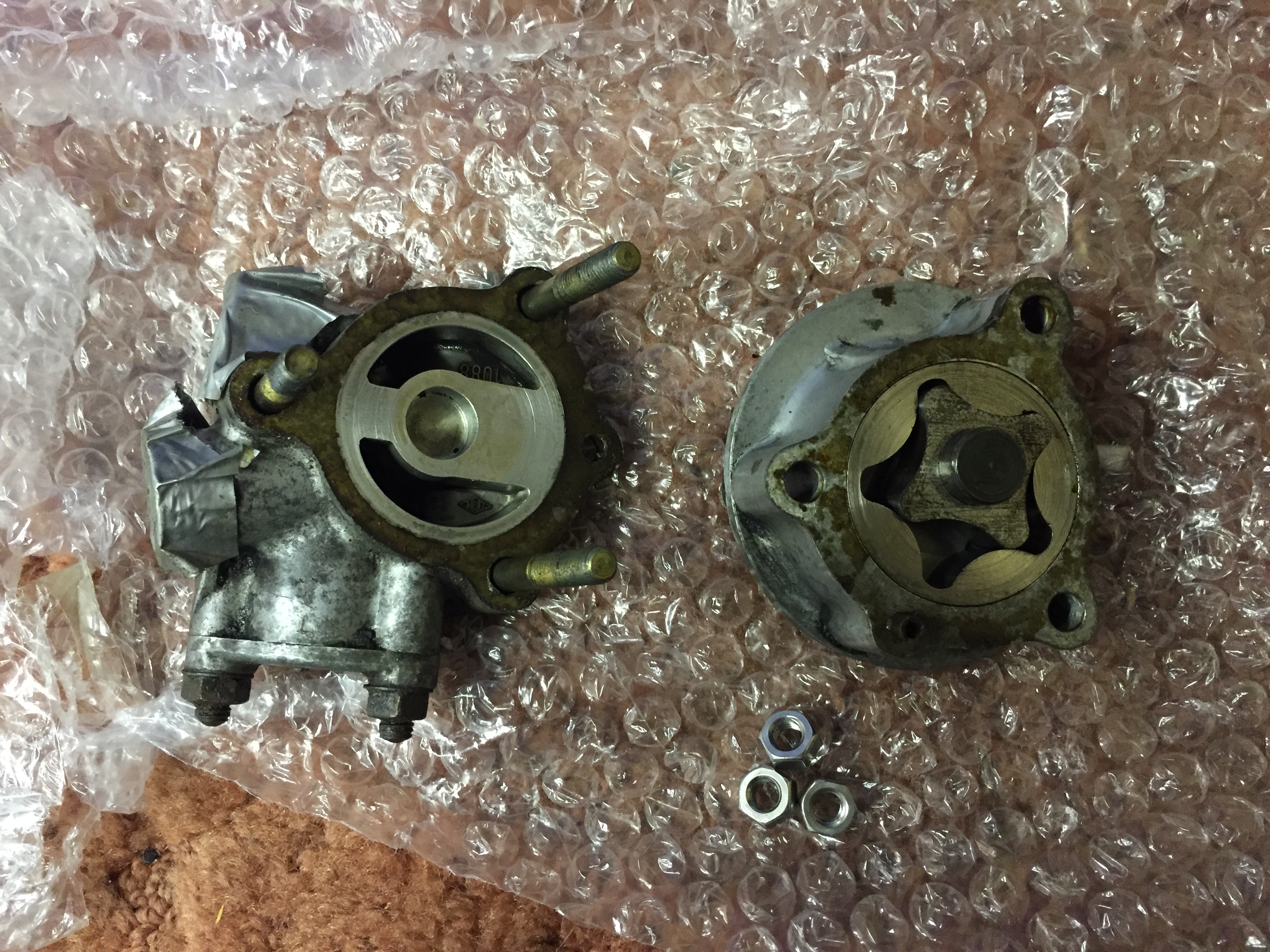

I have an oil pump, fits to the rear of the six engine and powered off the cam (same side that powers the MFI pump pulley. The sporto oil pump was also used on GTs for gearbox cooling

Found this on Ebay.de !
http://www.ebay.de/itm/PORSCHE-914-6-Getri...1cAAOSw-kdXyxoq
rgalla9146
QUOTE(Nutter965 @ Sep 19 2016, 11:46 AM) *
The one in Germany is more like it.
Seems to me that all of the missing parts could be found in the 911 world for cheap.
Many era correct 911Sportos have been converted to stick.
I saw a Sporto pedal assy. at the Pa. swap meet on Saturday.
I sold a rusty '68 911 recently that had the vacuum solenoids still in it.
The rear cover is probably one of the few 914 specific parts.
