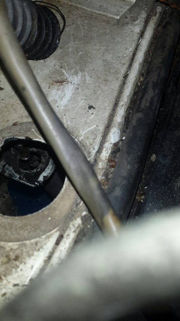

I went with braided only because I could find DOT units and a set of 4 was ~$100. That said even though they were for "Porsche".. the fitting was 11/16ths and not 17mm. I couldn't figure how to get a grip on the clip with vice grips etc. but finally got the retaining clip off by working through the engine compartment and levering with a long screwdriver through the rain drain holes! Hopefully the other side tomorrow!

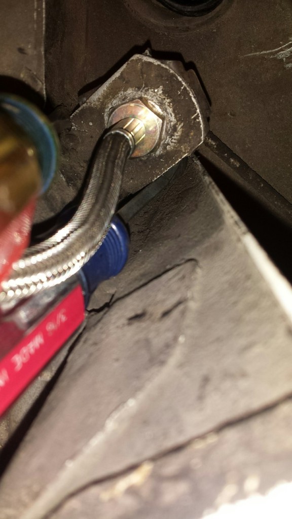

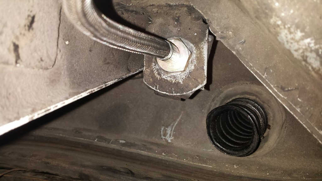

87m491
Doing the other side, I hit on the "best" way so far. It is pretty easy, even in the tight confines to cock the retainer left or right so that the unreachable side sticks out from behind the mounting flange.....
IPB Image
once you accomplish this, you can "walk" the retainer out using a flat screwdriver on each side as the retainer peeks out side to side. Out in 15 seconds. Time to find it after it flew out about 1 minute!
