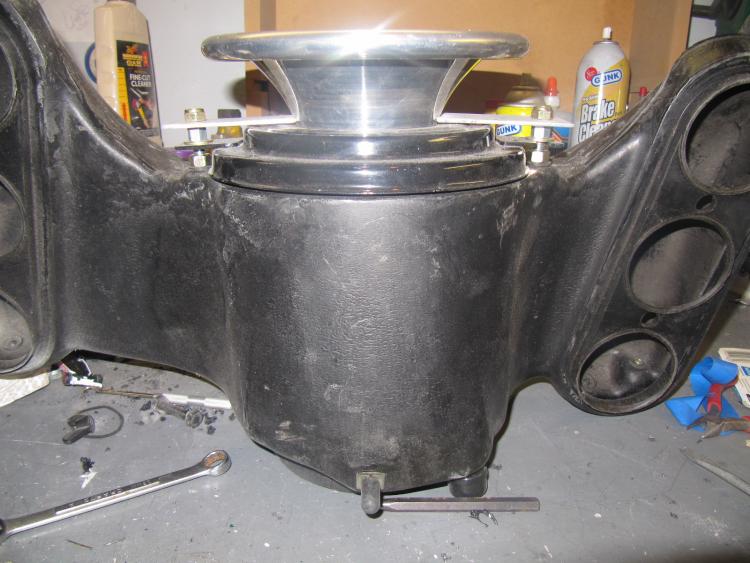

I bought Britain Smith's old carbs and airbox. It has a custom large velocity stack bellmouth on it and he said it makes better tq with it than without. I don't have the dyno graphs and number handy. But I would think making something like it would make for a quieter intake w/o much, if any, power loss.

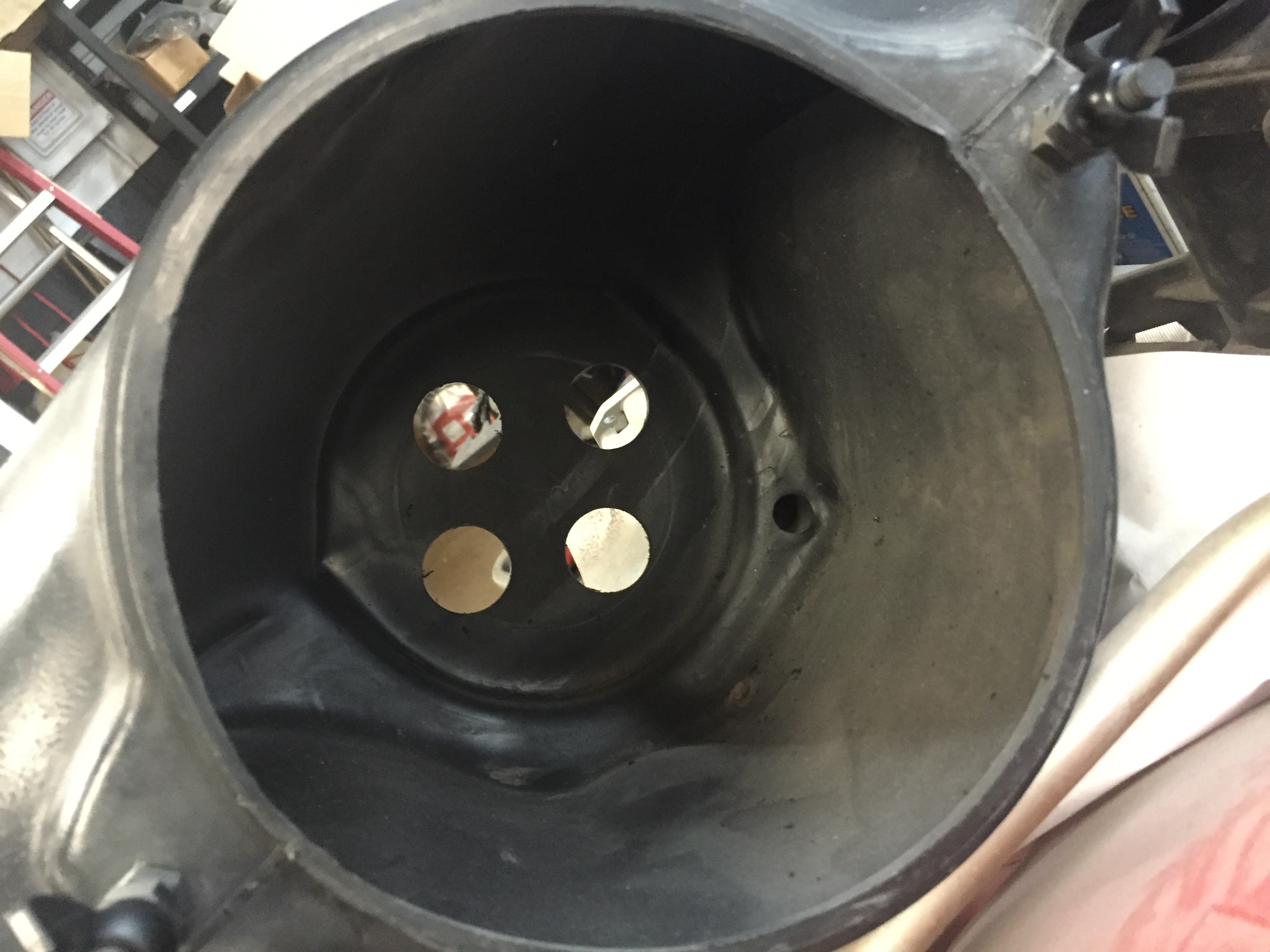

Henry Schmidt told me to bore out holes in the backside of the filter console to allow it to breath better. This was for my 3.0 MFI in the 911. They have to be in the center round portion so the air still flows through the filter. Might be worth a try to watch the dyno numbers.
I'm game. Any pics of how you did yours?

It's too bad you didn't get to try with snorkel and without air filter to see how it compared to the fully assembled box. My guess is that the snorkel is your limiting factor, not the filter and that something like Britain's bell mouth would make up the power difference. The snorkel is a pretty small diameter restriction one of the more important parts of the intake.
