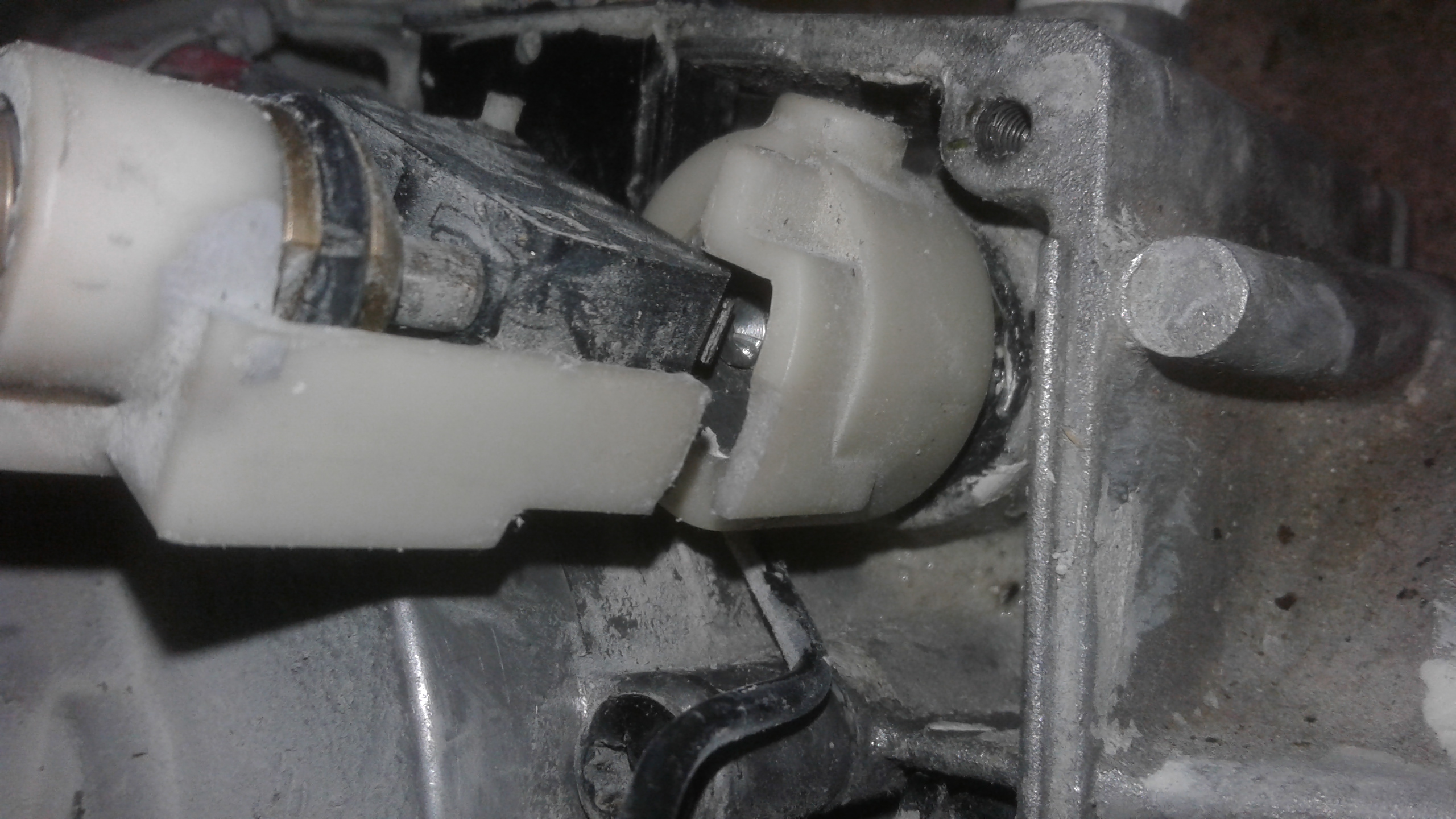

(does that count as Porsche topic? rolleyes.gif )...anyway, I opened it up to find that the pressure switch housing has broken, thus not allowing the unit to shut off, and build too much pressure. I think that may have affected the prime valve, but that's not for certain.
Anyway, has anyone got a solid suggestion for an (unknown) plastic glue? The back of the adjustment stem does get captured in the rear housing, so I think that takes most of the stress.

Interesting. Thanks, I'll give it a try. Would you advise removing a little material to allow for more adhesive to provide surface contact?
A pic
Valy
In this case I would just make 2 wire stitches. I guess that the other part looks the same so more stitches there.
Drill 1mm holes and use 1mm security wire to stitch.

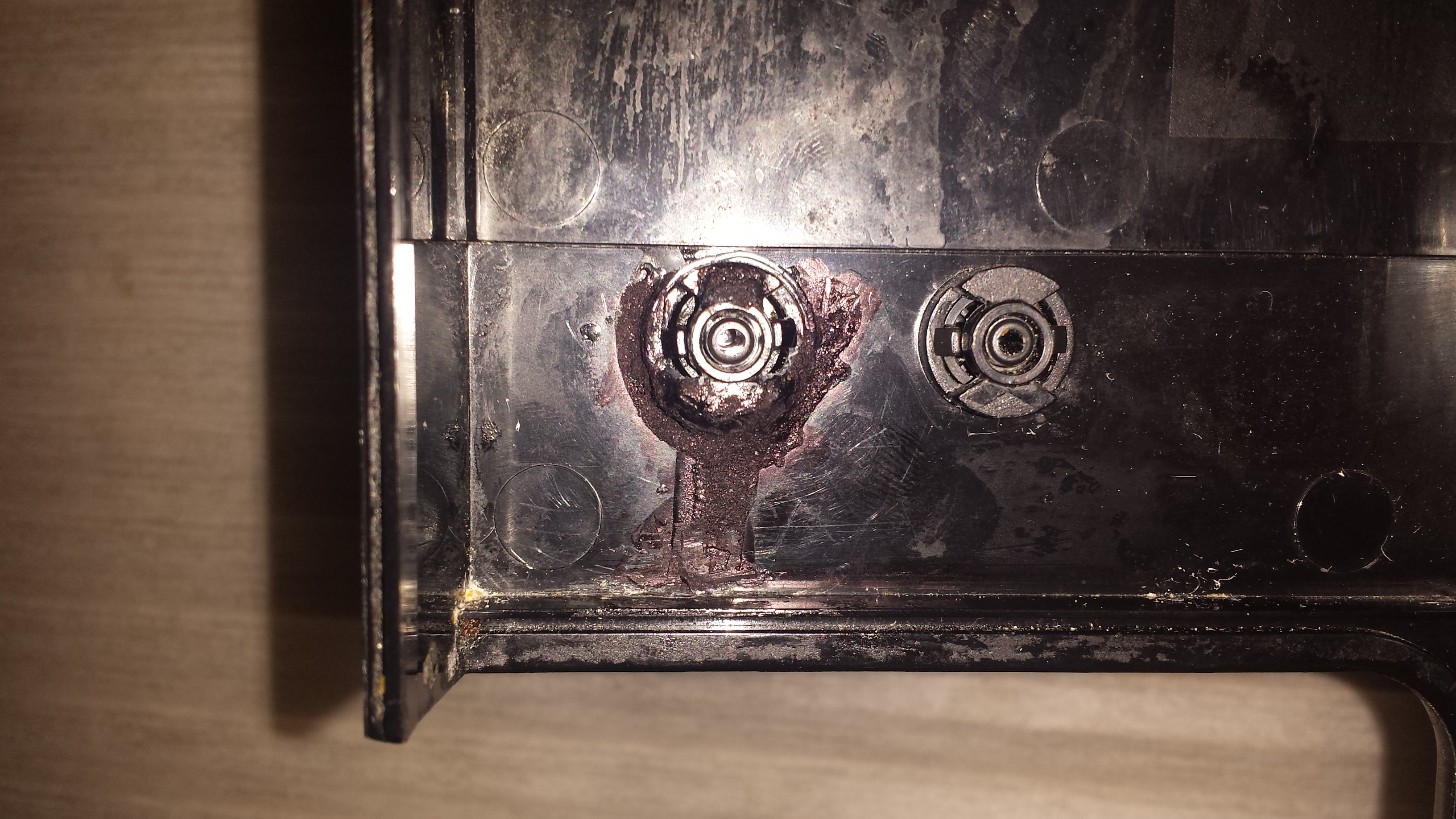

Here is an example of something similar. The left was the same as the right bump before it broke. It is constantly under load as there is a spring and button on the other side.
In this case I couldn't stitch it due to the size. I did make a wire crown around it to help stabilize everything and then built the crown up with superglue and baking soda. It looks a bit messy since it is vertical surface and the glue kept leaking down but the repair is pretty hidden so I painted it black and don't care much about aesthetics there.Click to view attachment
