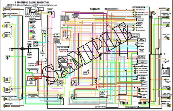

It is tuff for the forum to help with wiring. You are going to get 100 different ideas. If one end of that wire has a connector on it, look for the female (or male) part somewhere very damn close to it. If it is brown there might be a hidden case bolt with 4 or 5 spades on it that are all grounds, they should all have a wire on them, if one is missing.... TA DA. short of that......
I sing this guys praises every chance I get. The one I bought is not EXACTLY perfect, but it is a HUGE help.
PROSPERO'S GARAGE LINK
for $20 even an electrical illiterate like me can get things done. Look for your car in the list and buy one today.
