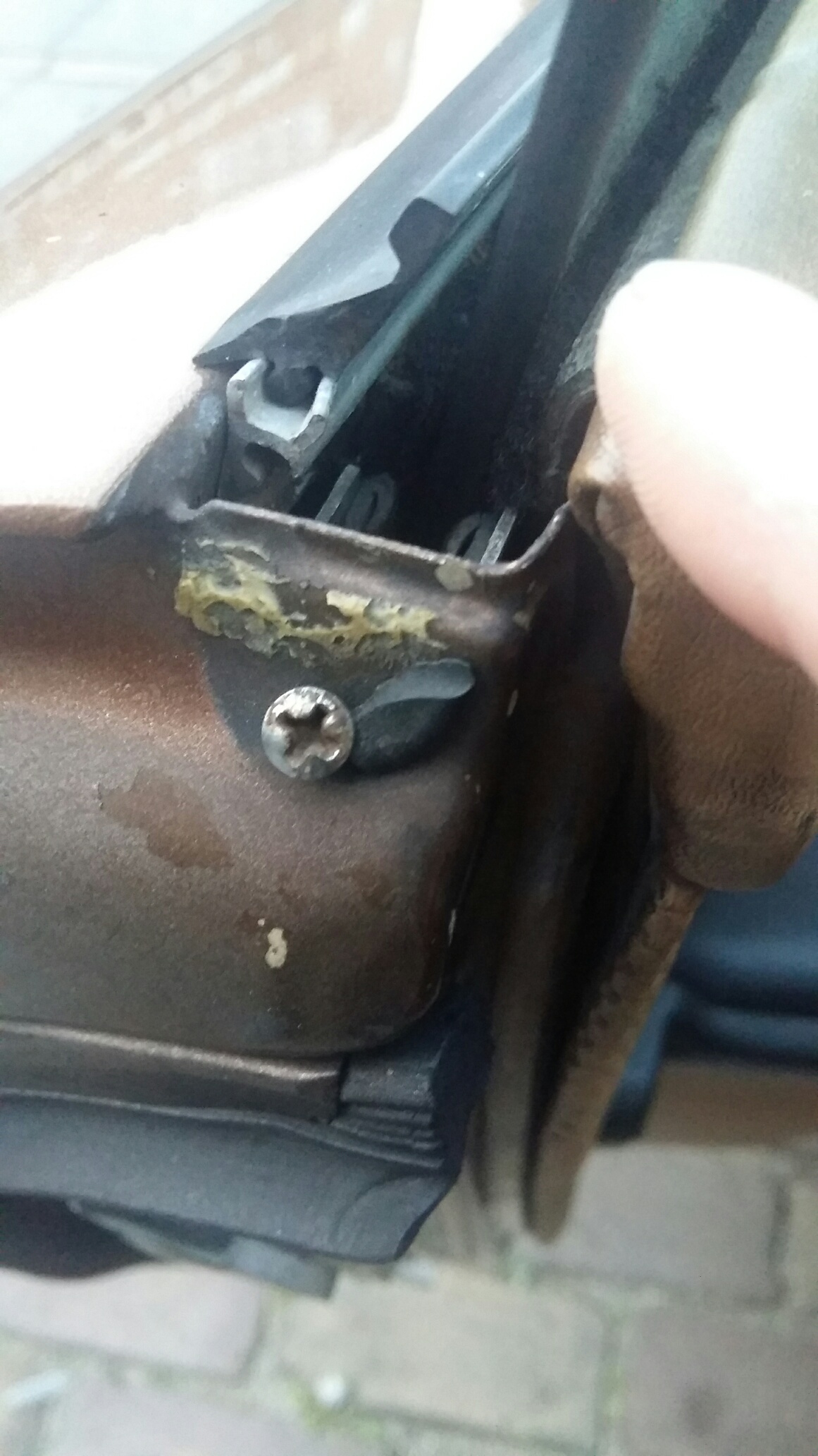

....dumb question....are the attaching screws for the end caps phillips head or flat head type? I've seen both types on various cars.
Frankvw
I have a philps scew in there. Not sure if that is correct...

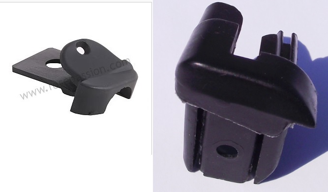

@rgalla9146:
"Pretty sure you'll need the later version."
That would be the left one in the pic?

Mikey914
Late
You need these
http://shop.914rubber.com/914-Late-door-en...ght-914LDEC.htm
Also pick up the correct scrapers while you are there.
http://shop.914rubber.com/914-Early-Outer-...ion-914ODSE.htm

Also screw should be phillips

Your old Cap at the Car are the later one.The correct srew is B2,9x6,5 with a oval head.
(Linsenkopfschraube in german)

Interesting....these two low mileage cars are showing flat head type.
JawjaPorsche
Mine is stock. Original owner. Phillips head.
