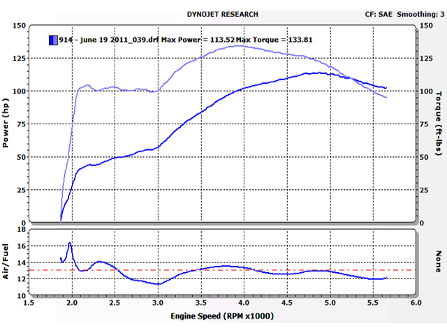

Another key concept (apparently completely lost on the younger crowd on the BRZ forums):
Horsepower measured by a Dyno is really measured at a lot of discrete points of constant RPM in the "curve" as the RPMs are raised.
When you look at "dyno pull results" (like this one from Vans 914 build page: http://www.ephotomotion.com/914engine/page50.html)
IPB Image
It looks like a constantly changing RPM and most people believe that you want to try to do the "pull" as fast as possible and that a faster pull means more HP.
That is not the case, in fact, the SAE requirements for dynamometer measurements are that the dyno is supposed to pause at each discrete measurement point for a specified duration before measuring torque & RPM.
In practice, dyno pulls are done in a dynamic sweep that seems to be one continuous pull, when they are really performing hundreds of discrete measurements.
The most accurate dyno measurements are done as slowly as possible.
What I am getting at is that each discrete measurement of torque is supposed to be done at constant RPM.
So how does the rotational inertia of the flywheel and crank affect the torque measurement at constant RPM (NOT accelerating)?
Answer: It doesn't.
