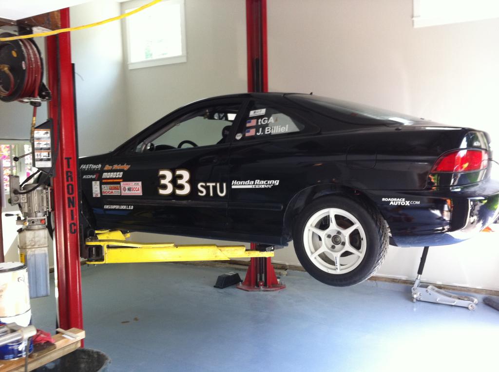

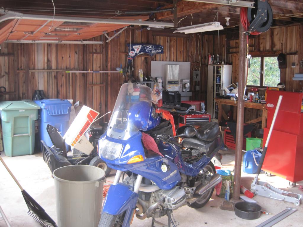

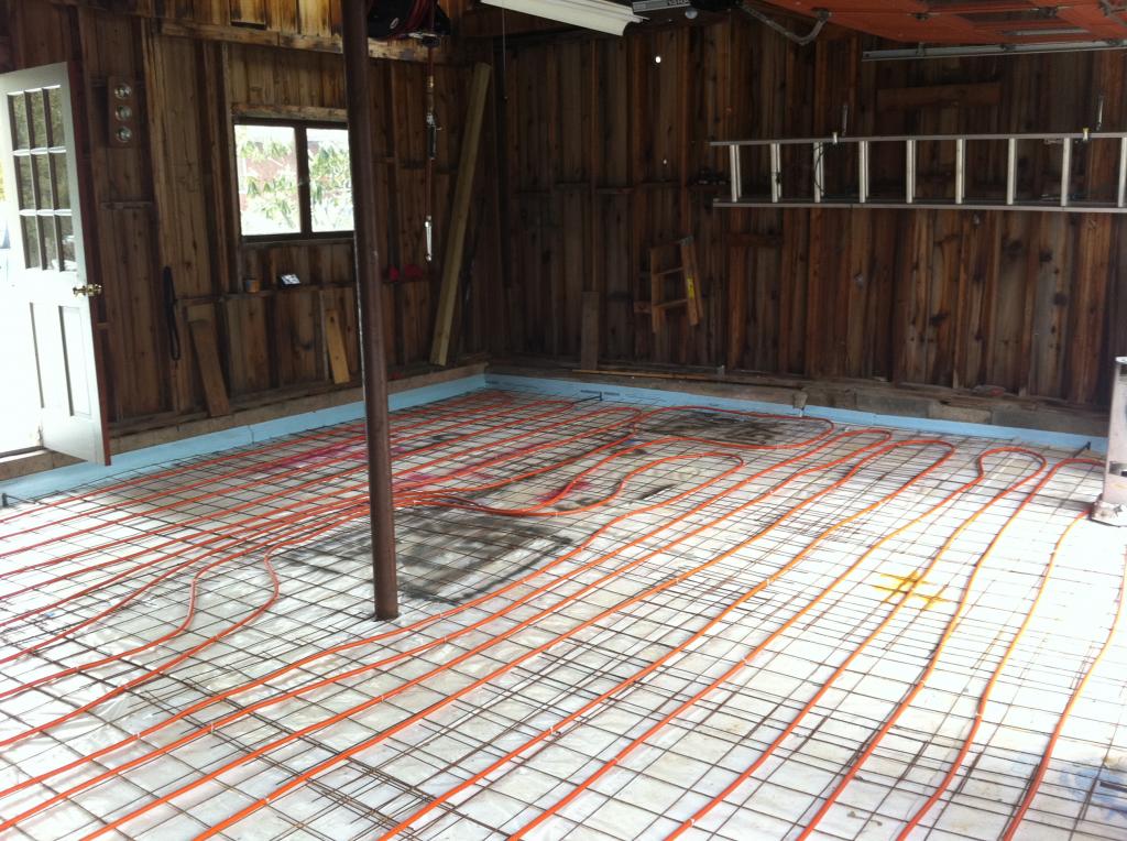

I have radiant floor heating in my garage, with pex tubing in the concrete. I use that to keep the garage to a minimum above-freezing level over the winter. Love that thing when it's working, kinda nice to lay on the warm floor...but I digress...Anyway, that method does not heat up the air quickly. If I leave the radiant heating at, say, 45 degrees, and I want to work in the garage, I have to give it several hours to get to a comfy 60 degrees.
I've had plans for 4 years to install a Modine for quick air heat-up - after all, I already have the propane - but in the interim I'm using a portable kerosene heater that does a damn fine job on its own. It's a DynaGlo I bought from Lowe's, 23,000 BTU. I fire it up an hour or so in advance and it heats the 600-ish square foot 2-level space to a comfy level from 45 degrees. And it's portable, installation was zero, and I only go through 5-10 gallons of kerosene per winter. I'd call that my easy button for now.
On the other hand, your space is uninsulated, so you'll need a lot of constant BTUs. That's where the Modine Hot Dog comes in. If you have the ability and resources to install propane then this is what you're going to want. Contact your local oil/propane dealer and you can rent a tank from them, and if they don't do the plumbing I'm sure they can refer you to someone that does.
And then enjoy the warmth...
Before:
During:
After:
