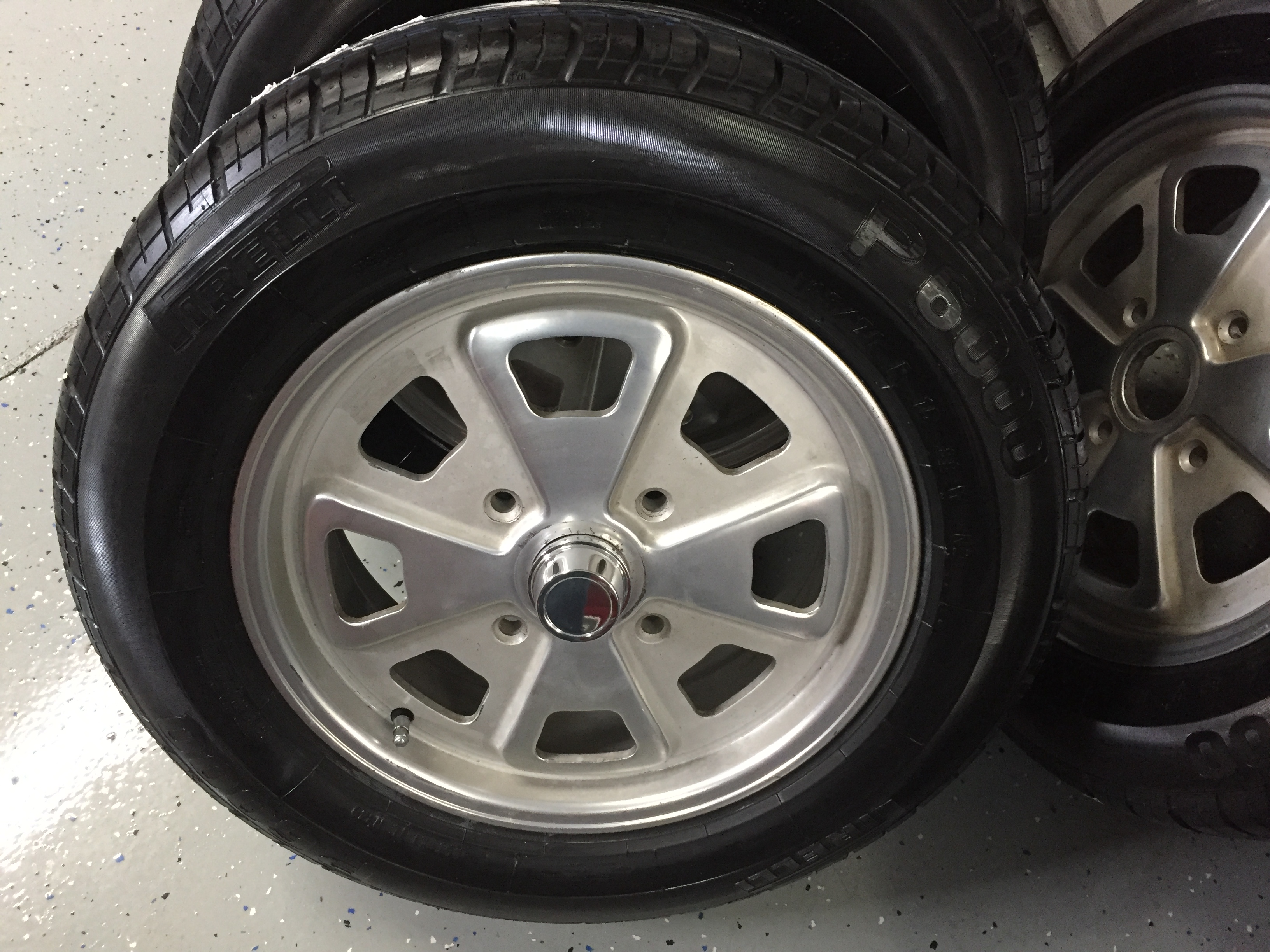

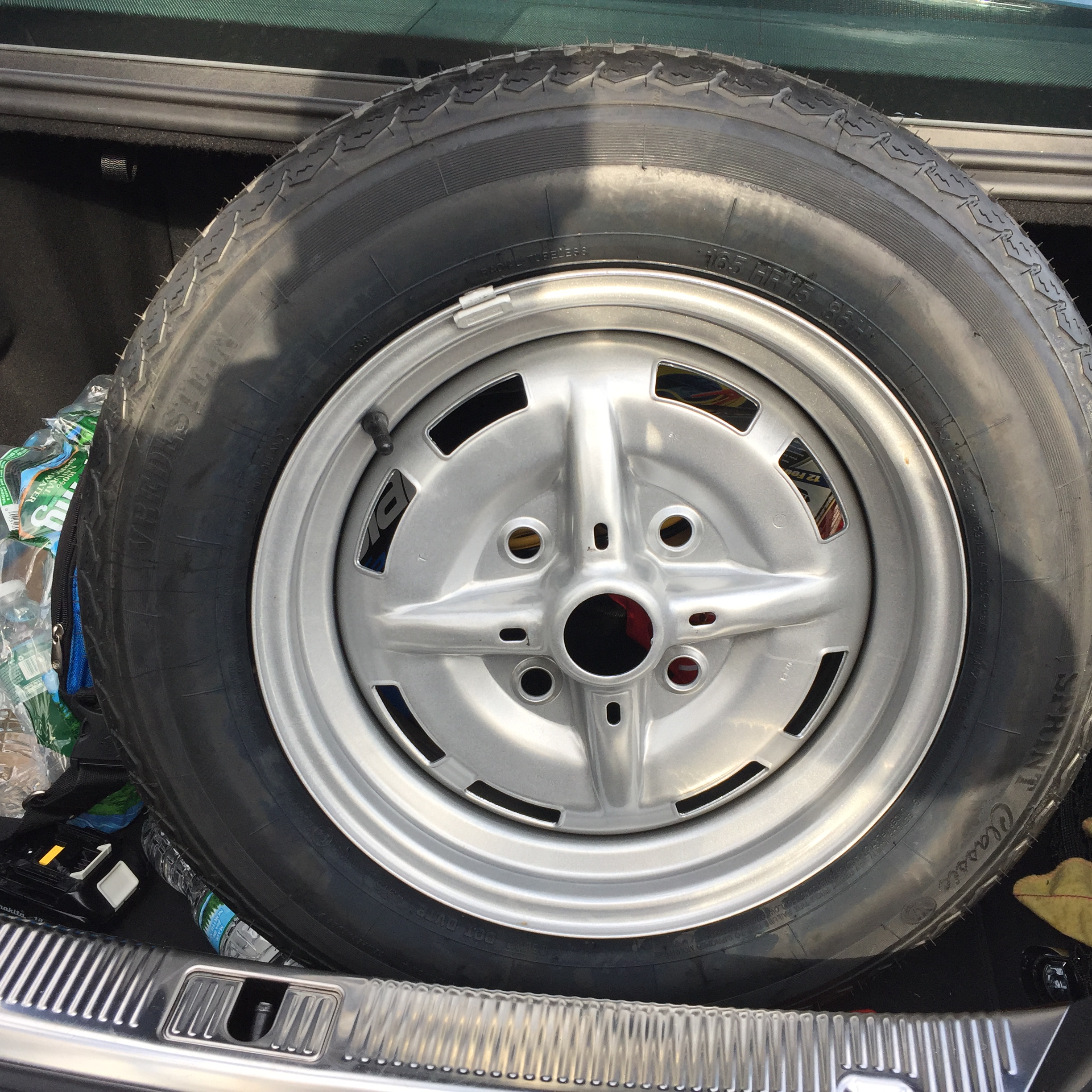

Here are the Pirelli P6000 185 70r15 I got for the Fuchs and the 165HR15 I got for the spare
Click to view attachment Click to view attachment
