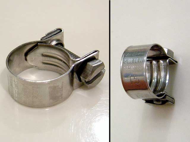

You need the proper size fuel injection hose clamp, IIRC there are two different sizes on the pump and filter, many FLAP sell an assortment kit.
IPB Image
VW used the push-on no clamp braided hose on carb and I believe they may have done this on the low pressure side of FI systems. The cloth braid available from VW shops sucks quality wise and will totally self destruct if you use ethanol gas.
Any aftermarket hose must have a clamp.
BTW the only hose I use without clamps is Parker Push Lok (matching hose and fitting) for oil lines.
