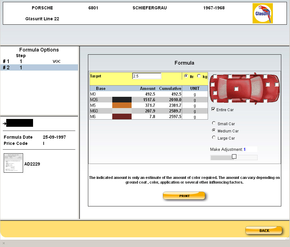

FWIW, Glasurit will provide the mix for their various paint lines. For example, below is the mix for slate grey using their Color Online web site.
http://coloronline.glasurit.com/index.php
IPB Image

QUOTE(howlndog @ Dec 9 2016, 10:41 AM) *
Thanks for that link.
Very cool.

Ah, just the tint bases. Sure, I thought you meant the formula for the base with the color already in it.

The Glasurit site would have been perfect if the codes had descriptions.
