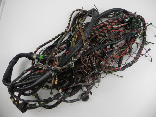

raynekat
I went this route.
Purchased from Aase for USD $1500 an NOS harness for a 1971 914-4 (the same year as my car) and will have some mods done to an engine wiring harness and a couple other additions/deletions to make it all work.
I'm converting from 4 cylinder to a 2.4 MFI 6 cylinder engine.
http://www.aasesales.com/collections/porsc...ucts/f1n-105381
gcrotvik
I considered buying that harness. Nice!
