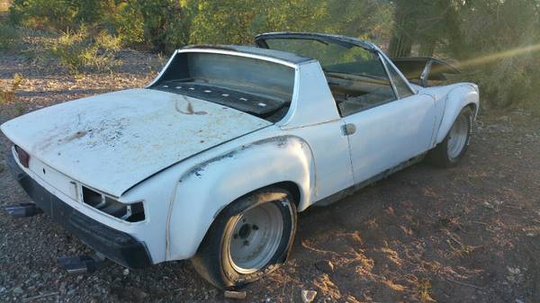

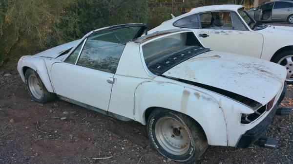

I just purchased this beauty for $500 and am excited to start working on it. I have owned 944's and 924's in the past but this is my first 914. Does anyone know where I can download a Factory Shop Manual? The car has been sitting for approx 10 years so any advice on what to do prior to trying to start the car would be helpful. I will be pulling the plugs and injecting some oil into the cylinders before I try to crank it over by hand. Anything else? Thanks.Click to view attachment Click to view attachment

Your 914 is an interesting start of the hobby. Already with flares.
Before you invest a lot of money to awake this 914 beauty, make sure to check the rust issues first and before you drive it, check the fuelhoses and brakes :-)

I know the longs and the hell hole are the areas prone to rust. Any other areas I need to check out? I gave a deposit on the car and will be doing a more thorough inspection before I give the balance.

welcome.png Cool. I would suggest crawling under and checking the entire chassis for rust. Start at the front, weather strip channels, the area surrounding the brake fluid reservoir, the cowl/A-pillar, the longs (of course) the floor pan, the area where the firewall meets the floor, all of the suspension attachment points, the "hell hole" under the battery (where it may be or was stock), the rear trunk where it meets the taillight panel, the bottoms of the doors, the entire pillar that contains the door latch all the way to the rocker. Heck, I could have just said the whole car....

You are a brave man to take on that one. Why type of engine is in it?

Yes, but no rust issues as far as I can tell so I don't have to deal with that headache. It has the 1.8L engine.

looks like a fun project, wish i could find a project that clean and cheap in the northeast. if you need any parts i have basically an entire 1973 minus the engine and tranny for parts!

Those are some fat tires and wheels on the back. Does it have an engine that will spin them?
Check all fuel lines and replace as needed Start with the tank back. They rot out with age and heat and can cause a fire if one in the engine compartment leaks onto the heat exchangers.

Any info on the 911 beside it ?

I asked about the 911 and it's already sold.

It has the 1.8L so not sure how it will do with the fat tires. Will have to wait and see once it's on the road.

So they're only giving you $500 to haul it away? I don't know if that's a very good deal. You might check the manual for the proper tire pressure. They look like they might be a little low to me.
