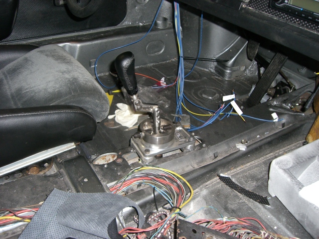

but I use a pair of universal joints, 360degree couplers on my custom shift linkage
I've got a few more tricks incorporated into mine too:
dual rear bushings on the console
a custom cup bearing holder
a custom shifter
and a straight chromoly rod
brass bushings on the rear
and a special delrin firewall bushing
its the best shifting 914 I've ever driven in 30+years of them.

QUOTE(brant @ Jan 31 2017, 10:27 AM) *
the link didn't work for me
a custom shifter

here are some:

I like the shift linkage that Brant has put together. Very neat. I need to learn to weld. welder.gif

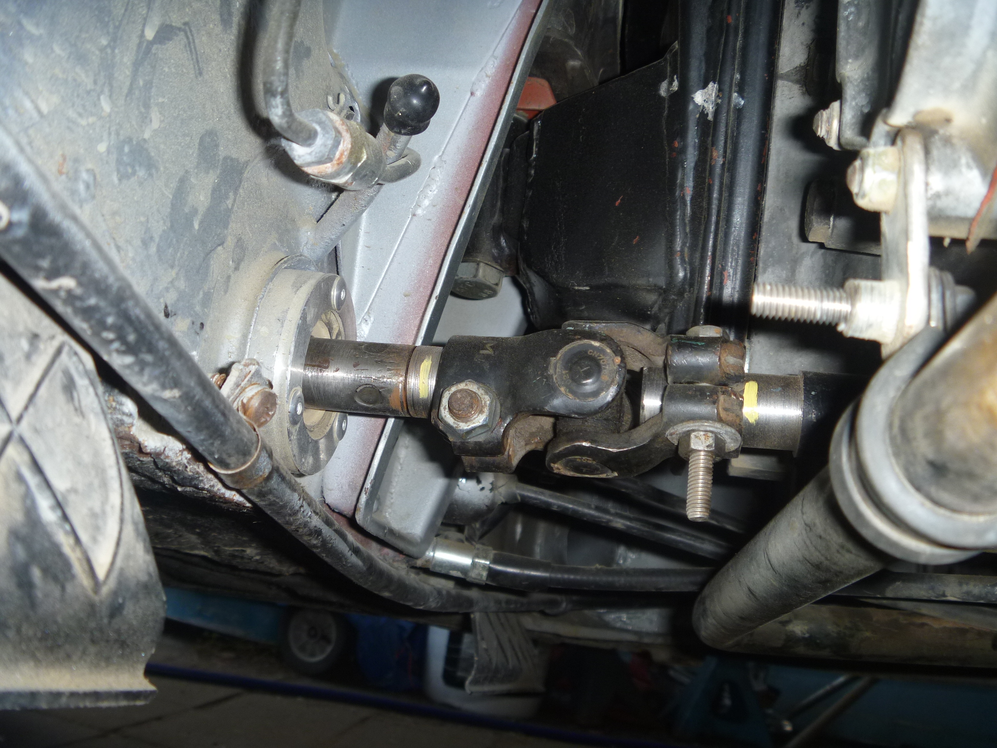

I've done it with a steering coupler, I don't have the car on the hoist to take a pic.
To use them you have to have the twin bushing mod at the console.
Only bad on using the steering coupler is the joint is exposed, but if it's a fair weather car that shouldn't be an issue.

Thanks Brant. That looks great. smilie_pokal.gif I will most likely go a similar route.

QUOTE(Mark Henry @ Jan 31 2017, 01:35 PM) *
So the steering coupler won't fit inside that boot?
Mark Henry
No, I imagine you could figure out something custom that works.

I made my own bolt on double bush console as well, came out good, not a big deal but just for a boot solution I should have made the shaft about an inch longer at the U-joint.
The bolt on console is great for the bolt on crowd, but the next one for my sons 914 I'm just going to TIG weld heavy ears on like Brant has done.
