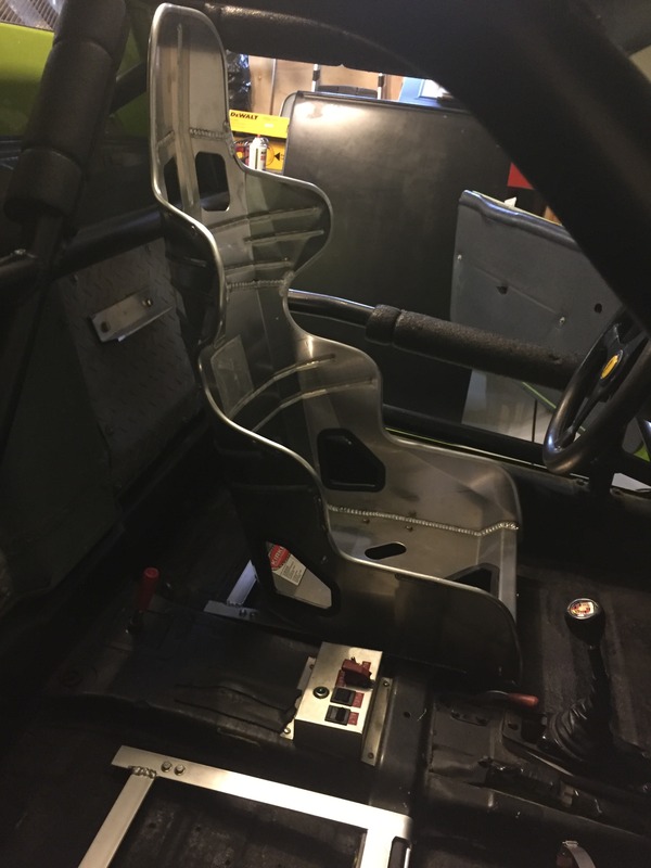

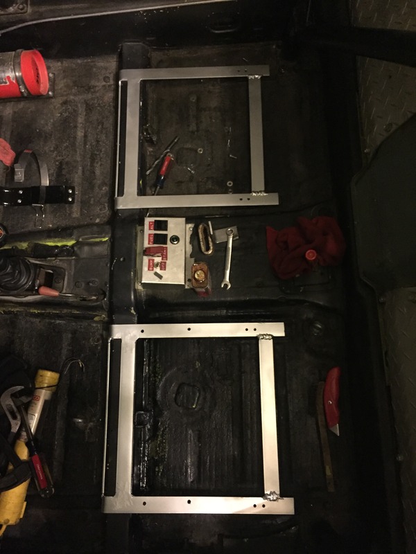

Working my seat installation... I'm happy with the base mounts
IPB Image
but struggling with the back support..
IPB Image
Problem is that there really is not any space to even put your hands in let alone mark you spot.
But my basic question: which is preferred and why?
a. Should belt and seat back mount to firewall.
b. Should belt and seat back mount to roll bar ( i prefer this but I cannot figure a way to do this given the space available.).
c. Should belt to fire wall and seat back mount to roll bar.
d. Should belt to roll bar and seat back mount to firewall.
Please note that I have an eight paint roll cage.
wndsrfr
If you're racing you'll need to find out the rules about seat support. I'm doing DE events only & don't have the seat back supported, just the base. Belts are clipped to eye bolts through bolted to reinforcing plates welded on the back side of the firewall...so the belts hold me and the seat in place I guess.
ThePaintedMan
agree.gif - rules vary per organization. However, I should note something that I feel is important. Unless the seat is specifically designed to be stand-alone with good side-mounts, i.e. most FIA-rated carbon seats, a proper seat back support should really be a consideration. Belts were designed to restrain the driver, but not the movement of a seat and driver combined. On an AX car, no biggie, but on the track, the speeds and forces are much, much greater in the event of an accident. I do believe that Kirkey specifically recommends a seatback brace with their seats as well.

I welded a plate on the cage behind my Kirkey...together with the base mounted, it is the strongest installation I have ever felt. My belts are installed around the cage too. Definitely find out what the minimum requirements are but if it is allowed - pin the seat high (somehow).
