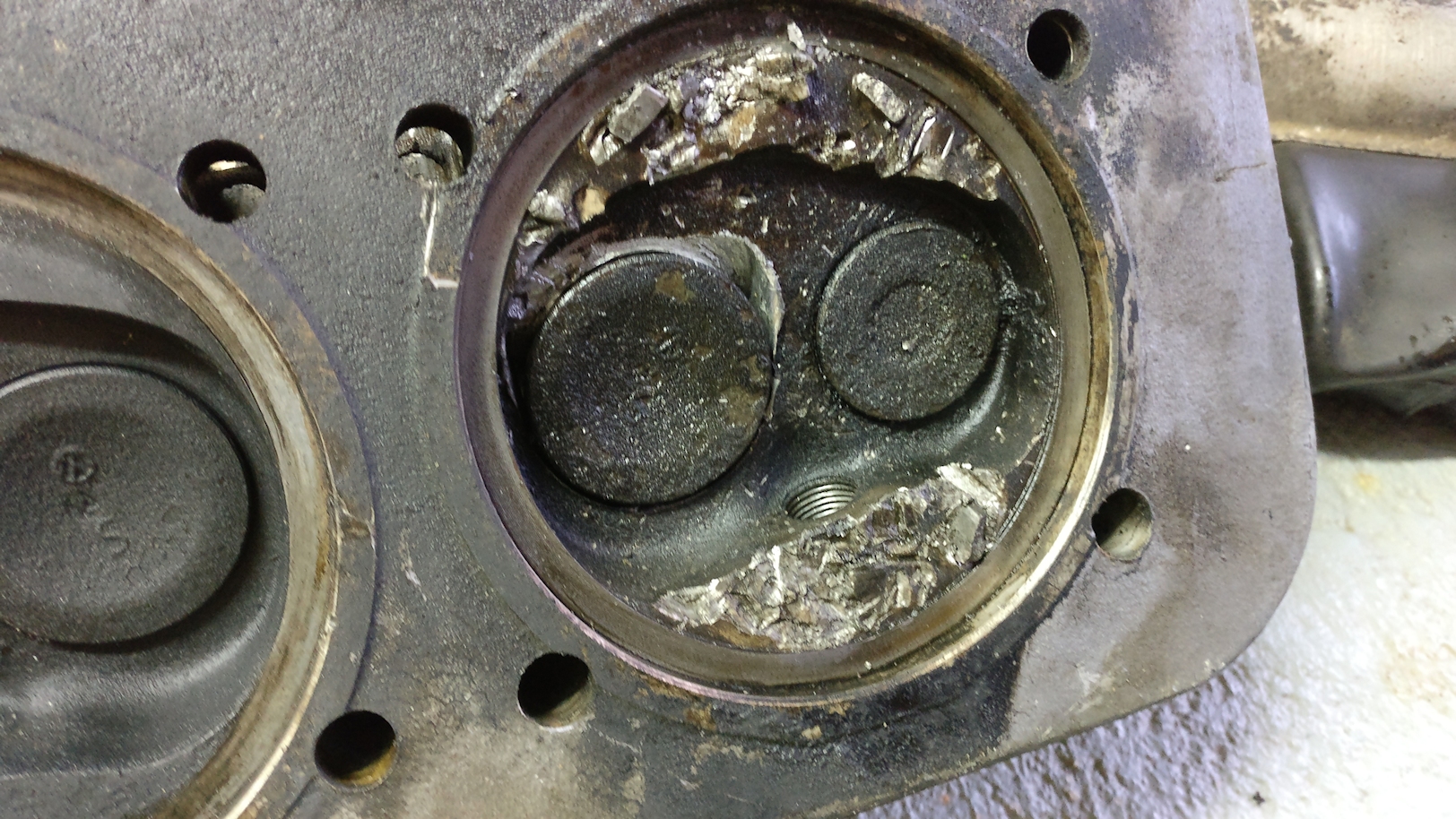

just to update you. Last weekend I dropped the engine - and actually quite enjoyed the process. However my enjoyment was short lived when I managed to get the driver's side head off - carnage. Warning: The following images are upsetting!
I've subsequently been told a valve seat slipped, got trapped and then smashed to bits. I'm also told that the head is salvageable but it may be more cost effective to source a re-con one.

euro914er

VaccaRabite
Mar 21 2017, 07:46 AM
Well, better to know and get it fixed.
The piston is trashed. What about the cylinder?
The head can be fixed if you can find someone to clean it up and weld and machine it back. But you may be better off doing a top end rebuild with a pair of new heads.
Using an old head is a dice roll. You want to be able to closely examine the head to make sure it's not stress fractured and that the valves are okay. Rebuilding a used head the costs will approach going with a new one and not having those issues. But if you get a good used head you can be back on the road with potentially a lot less money. In my experience, used heads tend to be a false economy unless you spend the money to have them fully rebuilt.
