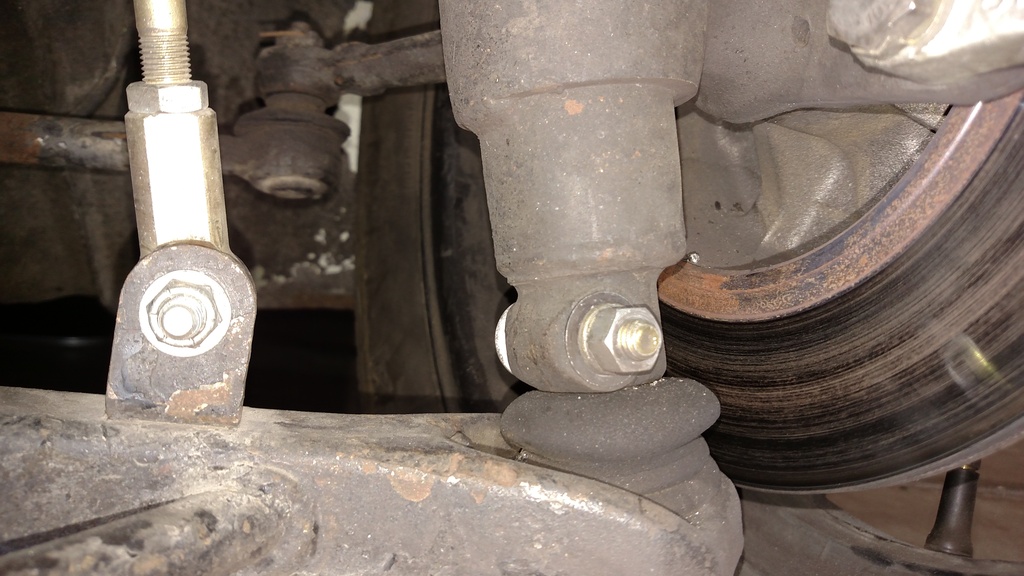

Here is the pass side:
IPB Image

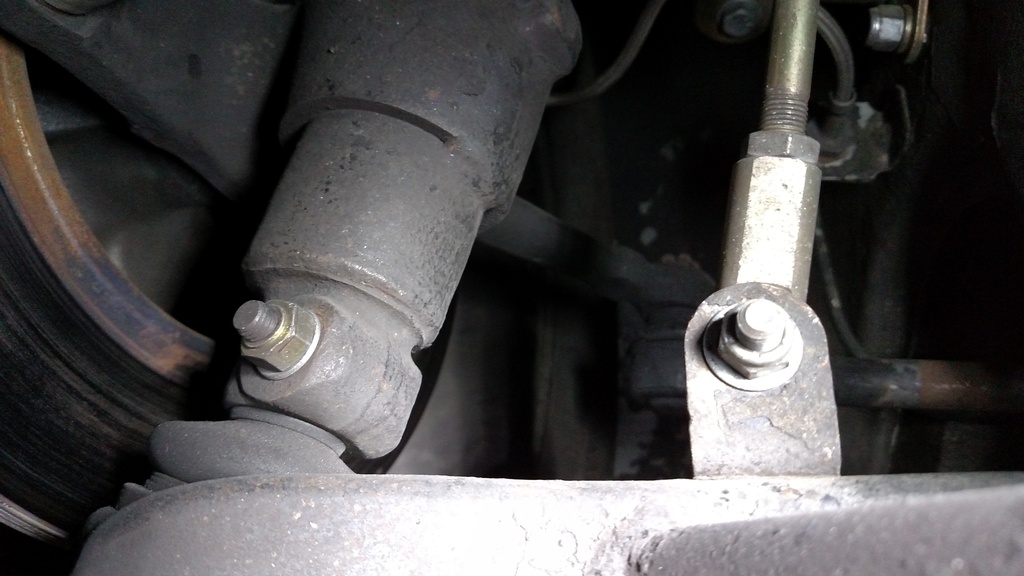

Driver's side:
IPB Image
I cant remember which side, but one side has the wedge bolt, the other side has the round bolt.
So do I have "early" or "late" struts?
And sounds like I need to have late struts for the de-cambered balljoints?

Sounds like you have one of each. Ditch the early one, get a late one, then have them done. The late ones have the wedge pin.

jcd914
From your description, it would seem you have different struts (1 early, 1 late).
But the pictures both look like late (wedge pin) struts. I don't see the split to clamp the ball joint in either of your pictures.
If that is the case you need to pull out the "round bolt" and replace it with a wedge pin.
If you actually have matching struts, you can send them to Racer Chris and get the spindles raised. If you have a mismatch, get another late wedge pin style and then get the spindles raised.

ChrisFoley
QUOTE(jcd914 @ Mar 13 2017, 02:44 AM) *
A wedge bolt strut needs a wedge bolt ball joint and wedge bolt to work correctly.
Mix and match will not work.

stugray
QUOTE(Mark Henry @ Mar 13 2017, 11:52 AM) *
But I don't think I do.
As far as I can tell from those pics, Neither of them have the "split" that would indicate an "early" strut.
Do you see anything that indicates that those struts are different?
Still learning about difference here...
I think the PO replaced a late balljoint with an early balljoint
ChrisFoley
QUOTE(stugray @ Mar 13 2017, 01:59 PM) *
That appears most likely. The trouble is that the pin isn't held firmly with a thru bolt in a wedge style strut, and over time will egg out the hole.
