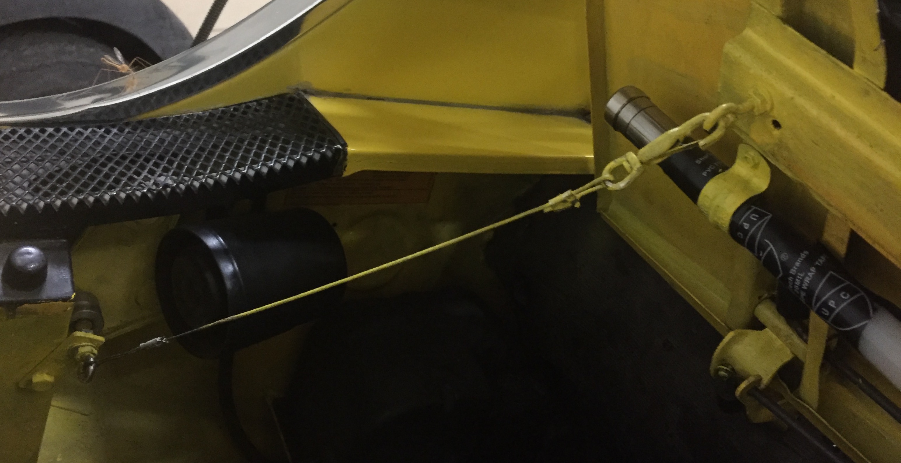

Simple idea. I installed a steel cable from a screw eye in the engine bay to a screw eye on the engine lid. I put a snap on one end of the cable just in case I have to move it to work on anything in the engine bay. The cable is just long enough to allow full opening of the engine lid but no more. I can pop the engine lid from in the cabin and I no longer have to hold my hand on the lid to keep it from opening too hard and bending or breaking the hinges. Works great!

Yep, Blazecut Fire Suppression system, cheap fire insurance. I supported the tightly curved area with a split electrical pvc pipe curve to keep it from kinking there. Here's a pic of it installed.
