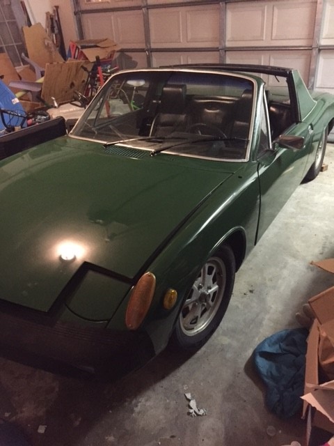

Hey guys,
After almost six months of hanging out here, from selling my old VW, to making a downpayment on a 914, my car was finally delivered last night! However, during the test drive there were some issues with the car, so I haven't made my final payment yet. Instead, I'm in the middle of a prolonged inspection period because of what popped up on the test drive. I'm fairly confident that I'll keep the car because it's virtually rust free, has nice paint and interior, and the engine seems to run and drive well.
That being said, main problems it has that need to be addressed are as follows:
1. The alternator light won't go out. I know how to trouble shoot this. The car appears to be charging regardless, so it might be a loose fuse. I can figure this one out.
2. When I drove it, the brake appears to be sticking. The front calipers were giving the seller problems and it was thought these were lubricated to where they don't stick, but apparently not. I've never rebuilt one, and I'm not thrilled about doing it, so I'll probably buy some rebuilt calipers. But I need to inspect them first.
3. Lastly, I have oil leaks. One appears to be from that plate near the drain plug. I've seen this before on VWs and it's not a big deal. However, when I went for about a 1-mile test drive, when I stopped, a bunch of smoke came forward out of the car. My initial thought is this might be oil coming off the valve cover gasket onto the manifold. But what else could it be? What are some common ("makes a lot of smoke") oil leaks on these little gems?
#2 and #3 are the items that give me a little bit of a stomach ache.
If the picture shows up, its not very good because it was in my garage late at night. I plan to pull the car out this weekend and work on it...I'll get new pix then.
Thanks in advance,
Mclovin

Great ! Alternator max 250 $ for a new/rebuild one plus the voltage regulator. Could be a loose wire fix for 1$.
The brakes...add 1000 to the project for all new stuff to be on the safe side.
Oil leaks can be many things so more details are needed.
Hope you get the car for the price you want....but rustfree means that you have a great basis and you know what they say....buy the best one you can affort ! Good luck !
Ps nice color !
76-914
The caliper rebuild is simple if you buy the kit from PMB. They include great instructions. Nice color on the 914. Reach on top of the HE's to check for oil pooling. If the compression is good I wouldn't chunk it to the side because of oil leaks. beerchug.gif

No alternator light means the system is not charging. Find and fix the problem.
PMB for calipers. No questions.
Smoking from under the car is almost always due to pushrod tube seals leaking, dripping down onto the exhaust manifold (AKA heat exchanger). Fix the leak, clean everything thoroughly, and then let it smoke for a while until the stuff you couldn't clean off finally burns off.

3. Likely the valve cover gaskets or push rod tube seals leaking onto the exhaust pipes. Or spilt oil from refill. Could turn into a full days work but definitely not a deal breaker.
2. Could be a couple of things, all minor. Pinched piston seal, old and swollen hose, old fluid. Won't know until you get in there.
1. Don't rule out wired wrong.
