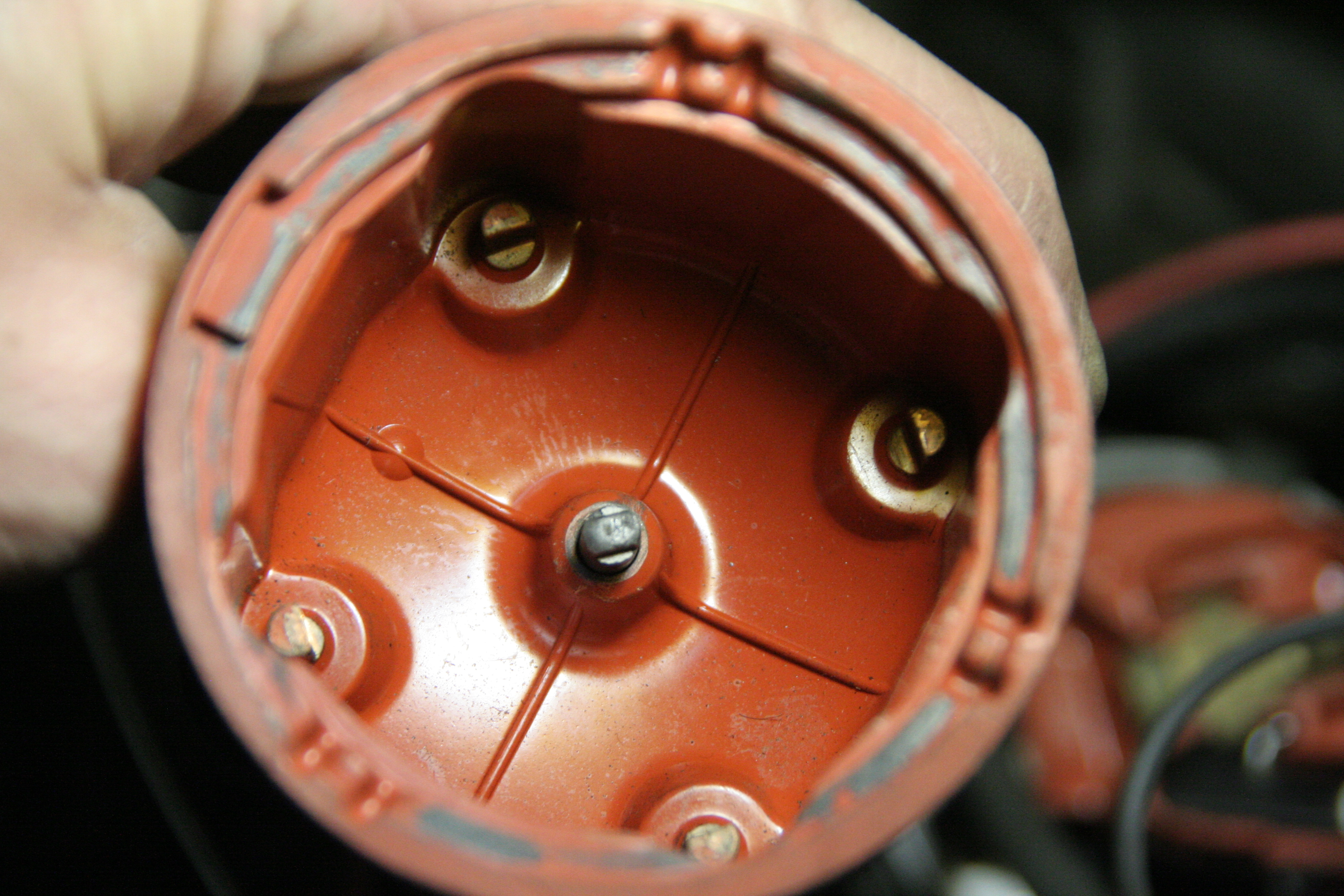

Here is a pic of the cap:

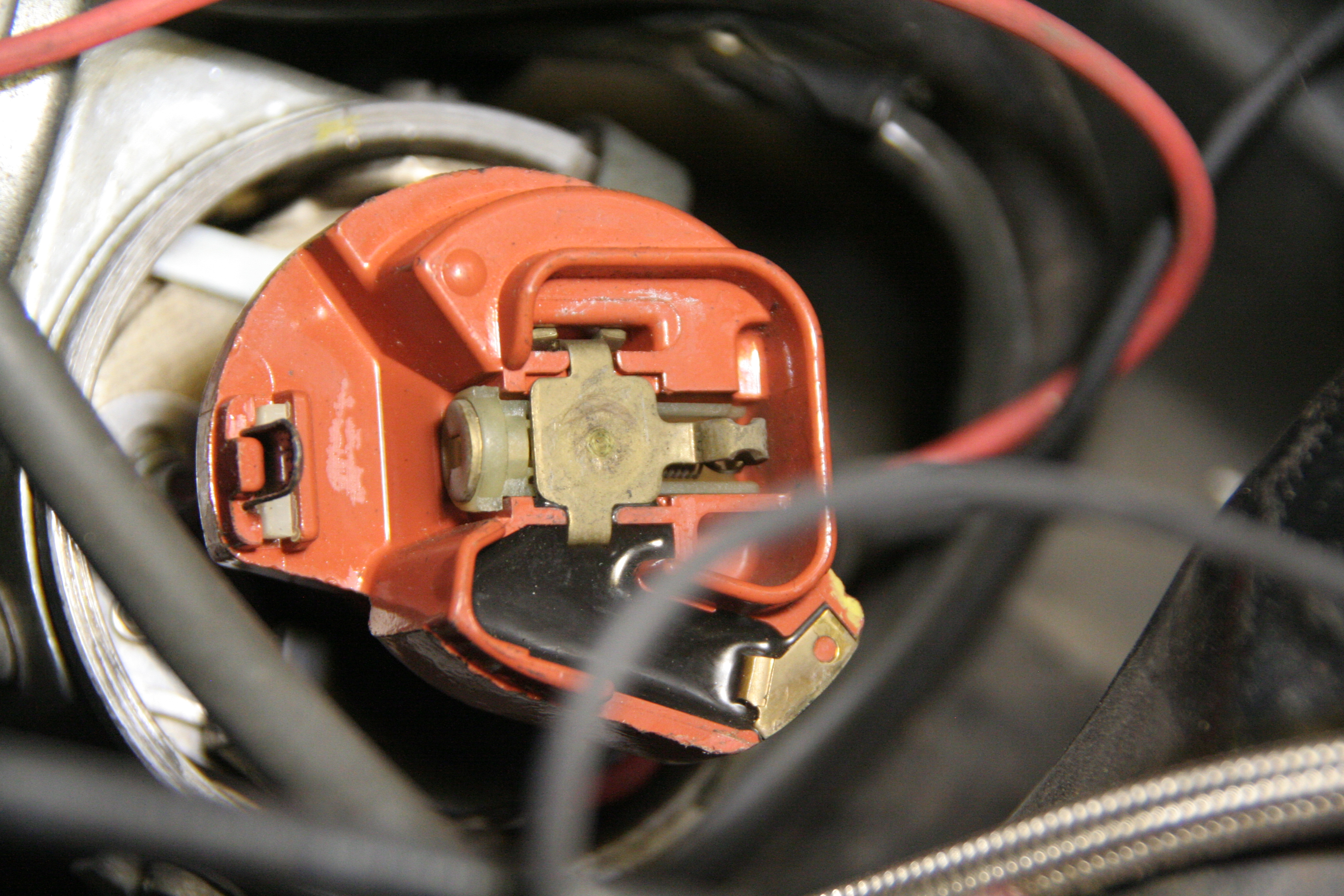

Rotor pic:

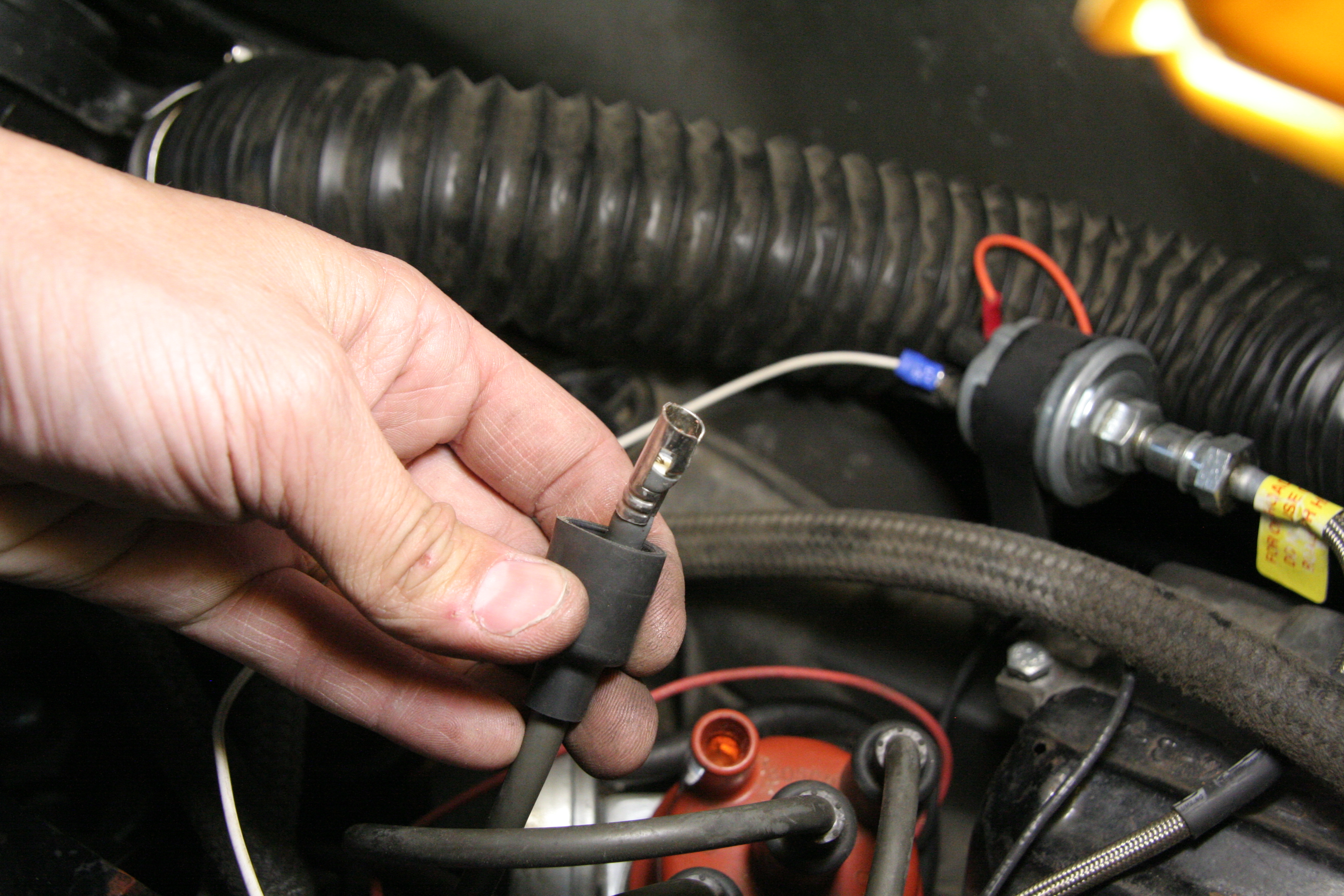

Pic of end of wire that goes in distributor:

3,4.: I posted pics, but these seem to look good. Let me know. I ordered new ones from Pelican anyway.

I got a little tool that you hold on the plug wire and a light goes on if there is current. #1 had no light, so I switched #1 and #2 plugs to see if that made a difference. While testing it, the car started! I thought it might have to do with having the air cleaner off and the 2 big hoses into it unplugged, but I re-attached it and it worked fine.
In the meantime, I found out the tool needs to be held a certain way (seems really stupid, but it will not work upside down). I got a light for all 4 plug wires and the center one when I held it upright. The light was not really blinking steadily; seemed more erratic. I tried it on my 2010 Chevy truck and the light blinked more regularly.
I think I will drive it, while waiting for my parts from Pelican and see what happens.
