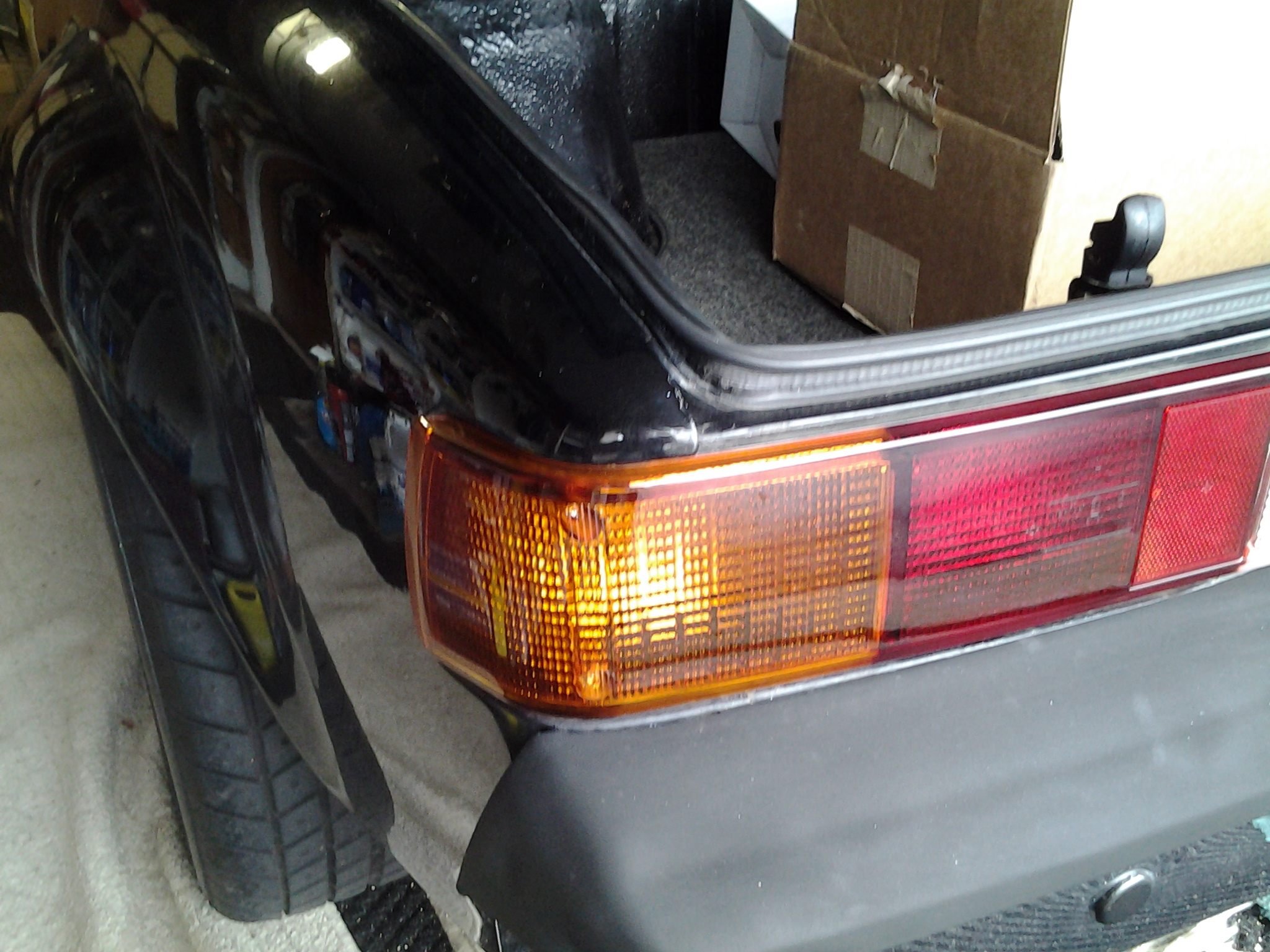

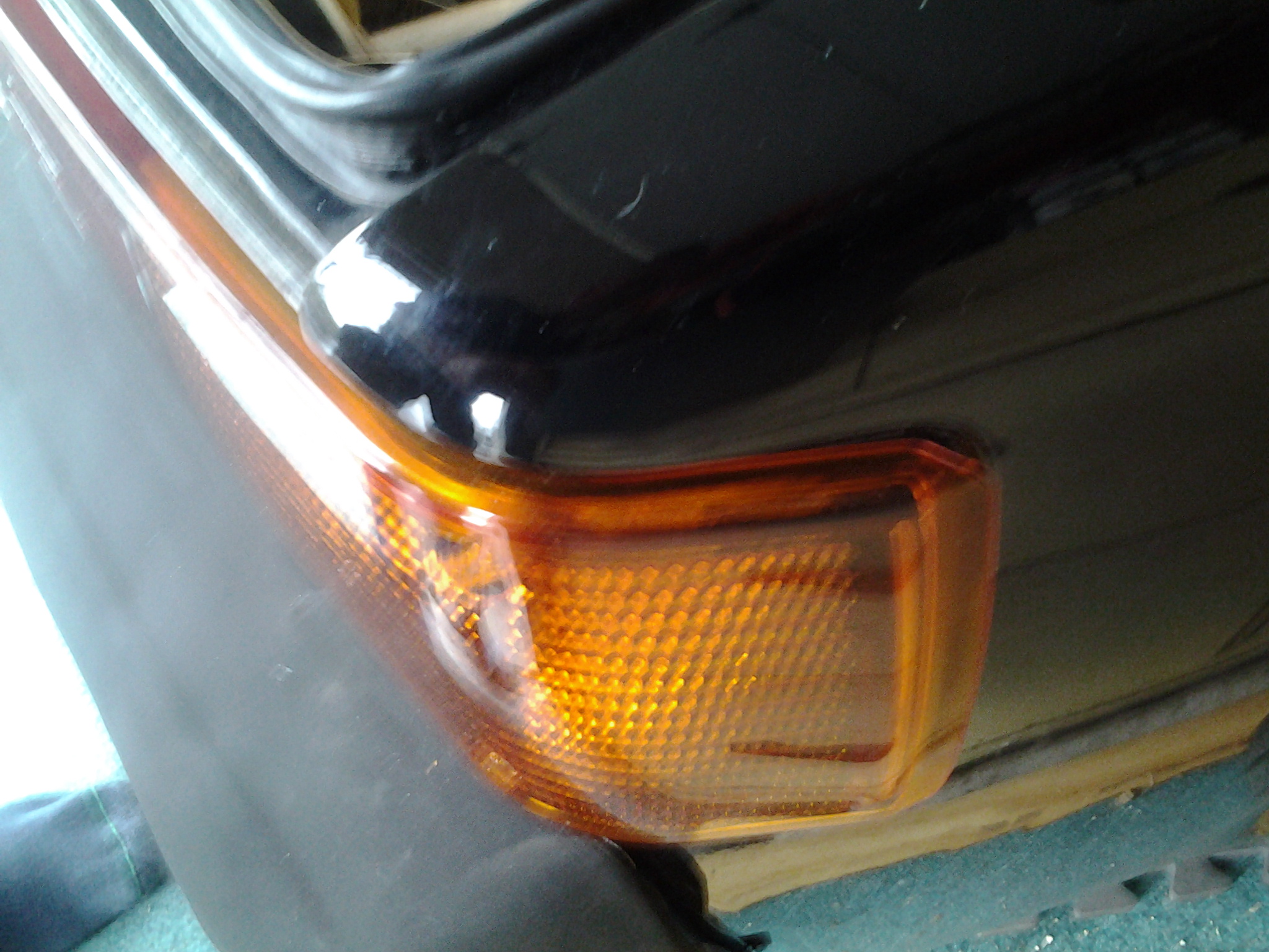

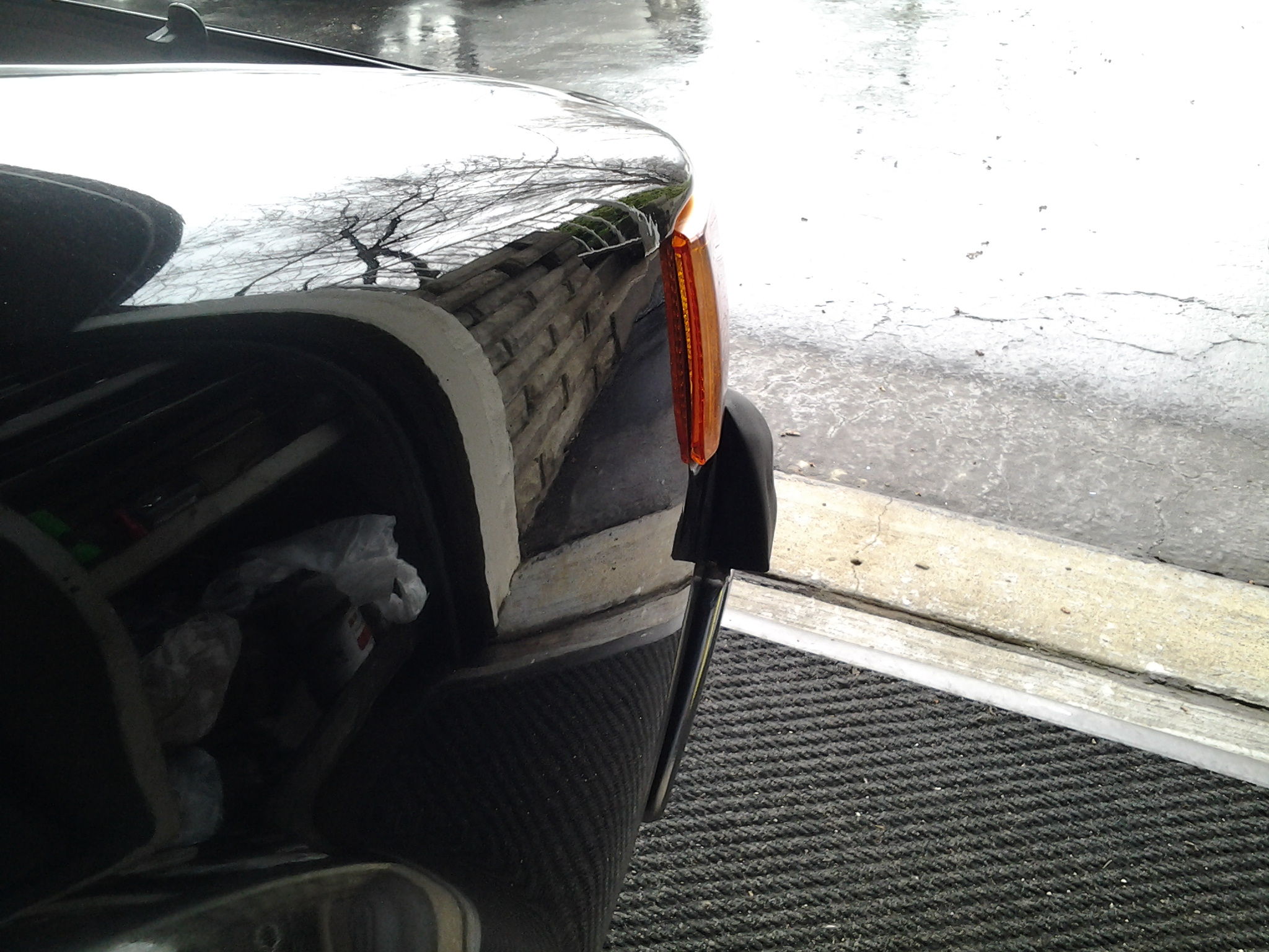

I bought a pair of taillight lenses from an advertising vendor here on the forum. They look nice but they do not fit flush on the quarter panel sides.
It seems the bend angle of the lens is not correct.
Has anyone else had this problem

I don't know who made or sold them - but regardless,
I suggest you send those pix to the seller & ask them if they're all that way, then ask either for an exchange for a proper fitting pair, or a refund - cuz that looks like crap & will leak into the trunk! dry.gif
Tom
That's why guys, me included, still pay big bucks for hella lenses.

swap them left to right? right to left?
porschetub
Didn't someone on here have to heat and bend them slightly??,think they were the AA group buy ones......
Anyone talked to them about the poor fitment I wonder.

Impossible to install left to right or right to left.
No, the name of the vendor did not begin with"A".
I phoned the vendor and explained my situation. He said to email him photos and he would forward them to the returns department for evaluation. He also said they were extremely busy and nothing could be done until Monday.
Is there more than one manufacturer of these lenses?
Thanks for the responses.

I have the AA ones and they have the same fitment issue....
Mikey914
As far as I know AA is the only repro vendor for these. We have started working on these using the silicone molds, but these have to be poured individually so gluing is problematic.

Yeah, I bought a pair. They're not terrible, but I did end up baking mine in the oven to allow a little extra bending. Worked ok...but I wasn't thrilled. dry.gif
