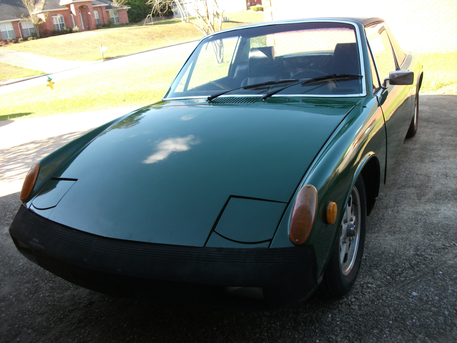

So below are some pictures I took this afternoon. That's the reflection of a cloud in the paint in the first picture. However, you can tell I need to reglue a sail panel in the last picture. Tomorrow (or Sunday) I'll figure out why it's leaking oil, why my Alternator light is glowing, and order some front brake calipers. I'll probably reglue my sail panels too since that's easy. After I tackle those issues, I'll be moving onto deeper reliability and appearance issues.

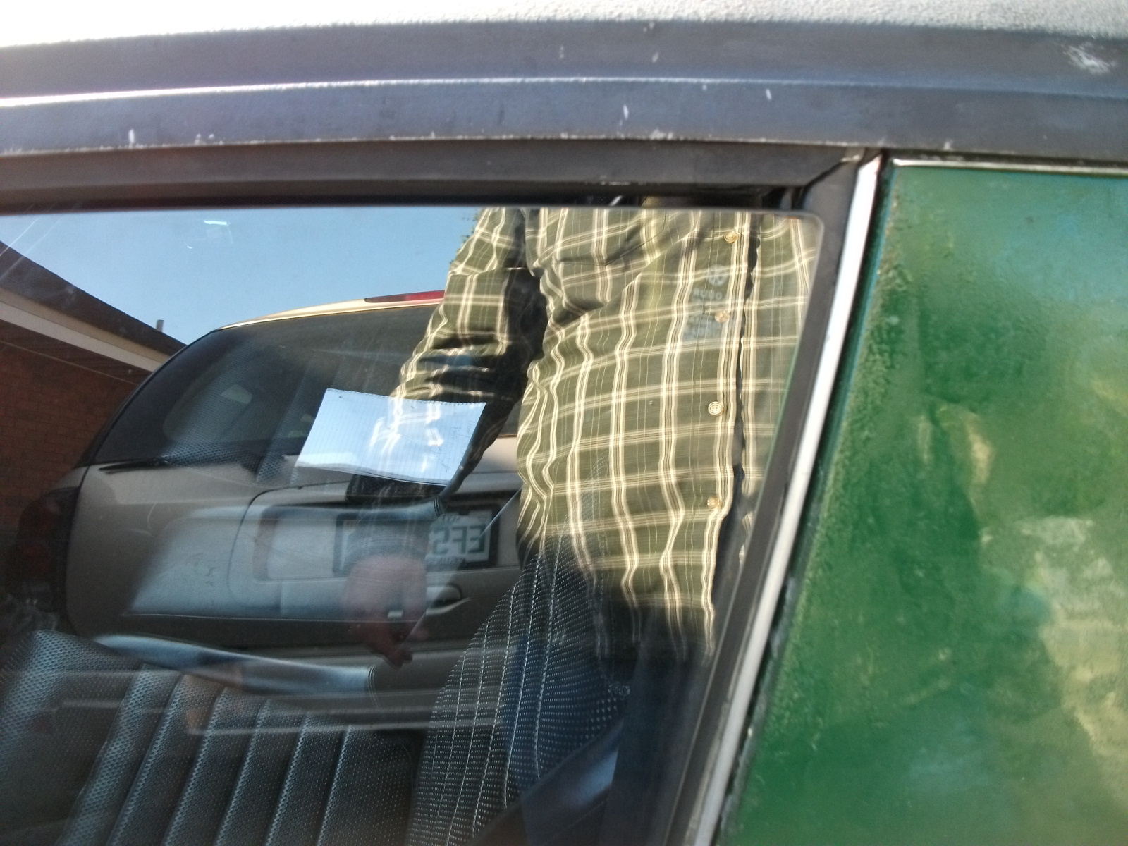

So check out the pictures. Notice how the window doesn't fit? It is rolled all the way up but it seems to sit cock-eyed and doesn't go high enough. It's very tight against the seal on the right. Pardon the reflection of the dopey looking guy. Anyway, the window is the first cosmetic thing I want to tackle. Seems like the door is bolted up crooked, and maybe the seals in the door frame were put on crooked or missing? If anyone has pictures of how those seals are supposed to go, I'd appreciate a photo.

Re the window seal, I hope somebody answers, cause mine looks the same.

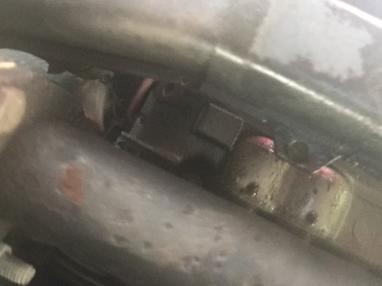

Next issue: My cloud of smoke oil leak is definitely push rod tubes. I was able to get my cell phone under there and saw the leak (see crappy picture below). It's also in the right place. Happily, it's only leaking from one side of the car, which cuts the job in half.
The $64,000 question is this: Do I need to remove the engine to swap out those push rod tube seals? I don't think I had to do it with my old bus, but it's tight in there!
Thanks for all the help!
Dave_Darling
You only have to pull the pushrod tubes halfway out of the head. Let them hang by their middle on the bore in the head, and you can replace the seals.
Actually, most can slide all the way out, but there are some where the suspension mount gets in the way. Those you just leave halfway out, no problem.
