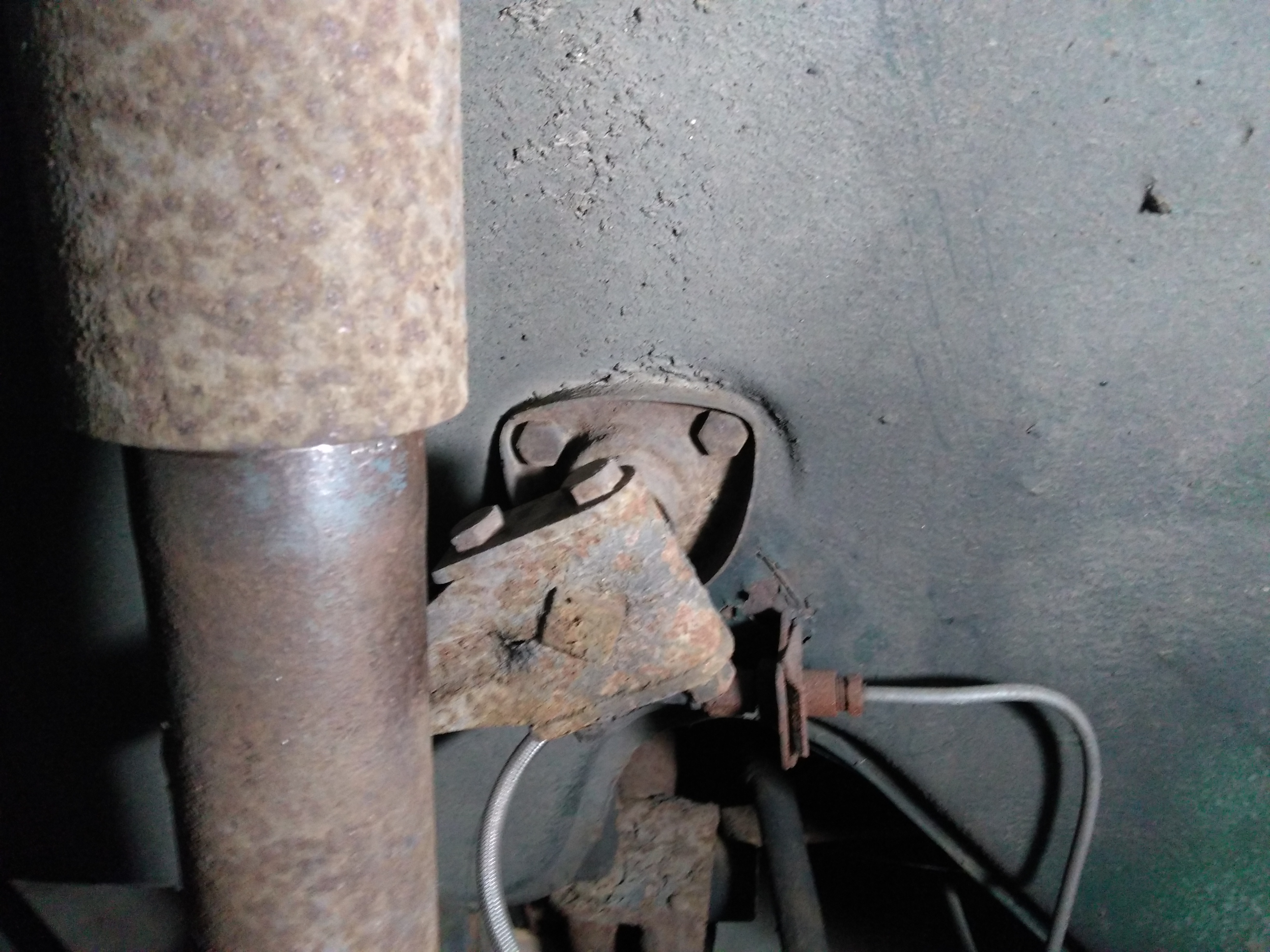

There is another thread on here, not quite so old, about this. Here is an old picture of mine, before I cleaned them up. 70 '6, purchased used in July 1977. These were on when I bought it, so can't say if factory or dealer, but my understanding is they are 'factory correct'. Only the front installed, not the back.
mate914
QUOTE(fixer34 @ Nov 17 2023, 09:54 PM) *
I can see mig wire from moving brake line tab.

QUOTE(fixer34 @ Nov 17 2023, 05:54 PM) *
This his helpful. Thank you for posting. I am trying to see what the factory welding looked like (i.e., was it tack welded or bead welded). Perhaps it is not possible to see it when everything is assembled?

QUOTE(DennisV @ Nov 18 2023, 07:26 AM) *
IIRC, welding is only done at the tab on the inside where the gas tank sits. The outer tab then bolts to the inner with the wheel well sheet metal in between.
914werke
If you are going for OE concourse install there is NO welding done in the tank cavity. The (mount) plates were spot welded only inside the wheel wells.
wonkipop
QUOTE(914werke @ Nov 20 2023, 02:55 PM) *
yep. thats right. there is an outer plate for the sway bar mount that bolts to factory reinforcing plate.
top two bolts had nuts where accessible from tank cavity.
bottom bolt on the triangular shape goes into a formed thread that is part of the mount area sheetmetal in the wheel well. pretty sure that is how it goes. at least that is what i can see on mine. the bottom bolt is inaccessible from the tank side. all done at the factory when the body was fabricated. not done at a later stage in assembly. cars built to order with the sway bars.

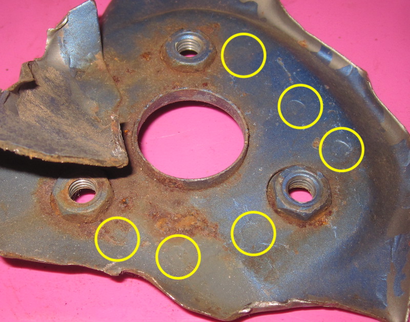

Wheel side / tank side
DennisV
QUOTE(rgalla9146 @ Nov 29 2023, 09:31 PM) *
Very helpful photo. Thanks!
Best I can tell, no seam welds. Just a few spot welds in not so precise locations, as suggested by Rich / @914werke ? welder.gif
