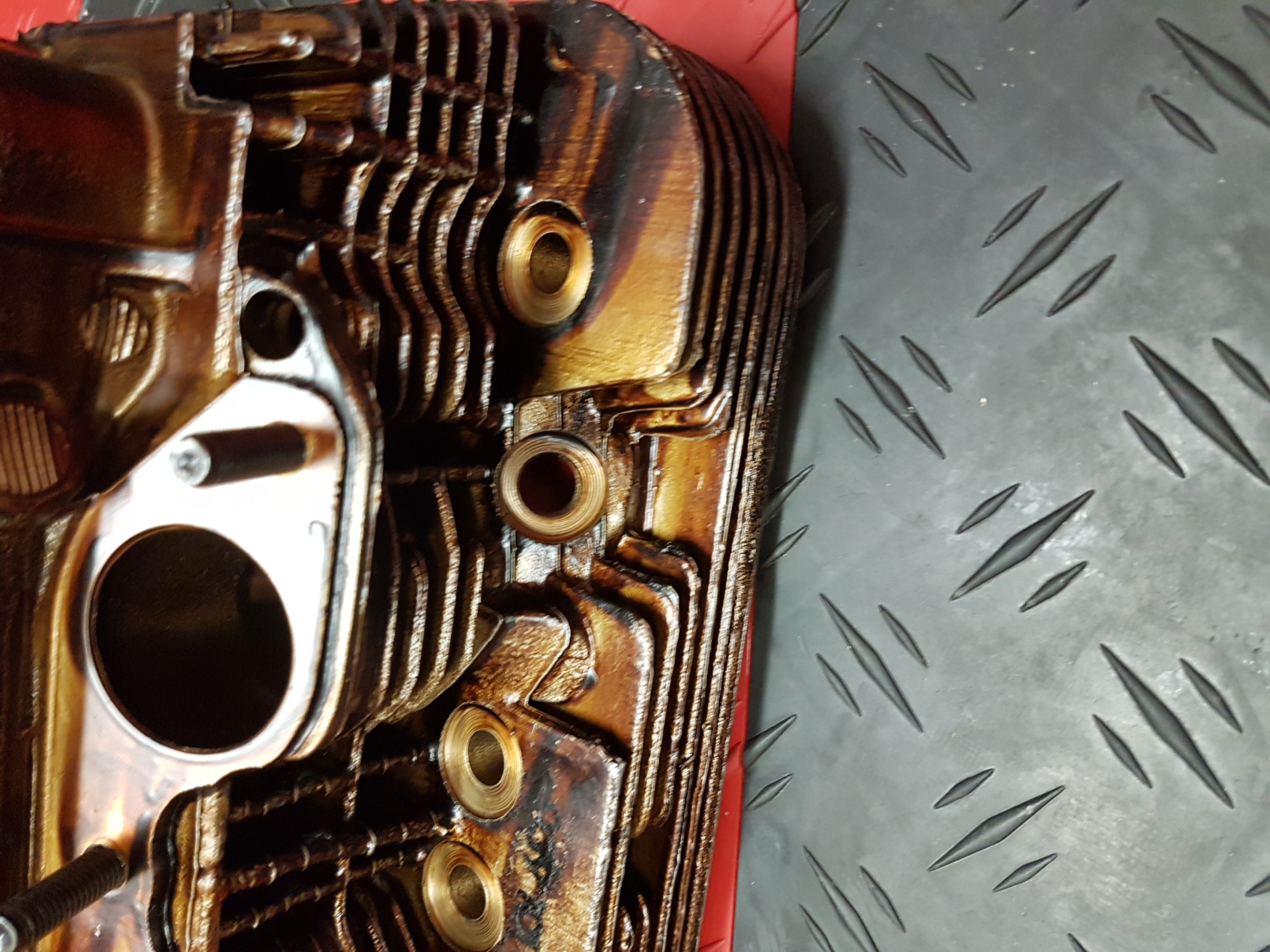

Got mine. I could've sworn I replied to this thread, but I guess I got sidetracked.
At this point I've only inspected them visually. But comparing them to stock 2.0 heads, everything looks the way it should. You would be hard pressed to identify these as reproductions. My next step is to ship them off to a machine shop that I trust for a more thorough inspection than I'm set up for. But I don't see why the bare castings shouldn't be a good starting point. The first few sets I end up usings I'll expect to remachine the cylinder spigots and then I'll know if their machining is correct. Installing the seats and guides should be the same as having a stock set rebuilt.

Click the pictures for the full size versions if you want a closer look.

Are you going to install Timeserts or Helicoils for the studs?

I don't see why you have to on a new casting.
One thing I do see is no step in the cylinder seating area. It would be interesting to know what the chamber CC is.
914werke
Apr 27 2017, 02:55 PM
notice the CHT location isnt drilled/tapped either.
HAM Inc
Apr 27 2017, 03:42 PM
Overall they don't look bad at all for a first genertion casting run. I'll be porting a pair this weekend. I'll also use my cnc to reverse engineer and check critical features to see how they compare.
I wish they'd copied the later smog version which has more material around the exhaust port. My contact at AA said they plan to add material in several areas to the next batch for more aggressive porting. Wasn't able to get alloy info., but I'll be able to tell a lot by the way it machines.
They aren't as beefy as the AMC heads we've been modifying for years, but if AA works on that like they said they are they could have a solid product at a much more affordable price.

As for the knockoff heads, I've just finished a pair. They machined well and critical deminsions are a match, for the most part. The pushrod tube bores are a couple of thousanths small, which is good since the machine work to them is rough as a cob and require honing to smooth them out so they don't tear o-rings. The flycut finish is okay, but the work from chamber to chamber varied by a couple of thousanths. Our finish work is with .0005"
The intake ports are awful as delivered. Rough as cobs (and I like rough, but this was a bit much) and don't line up at all with a factory gasket. But that wasn't a big deal for me as they do have the same corkscrew shape, and are undersized such that with port work they lined up fine and flowed the same as our ported heads.
The exhaust ports are pretty much dead nuts copies of the O.E. heads in rough shape and after polishing and blending flow about the same as an untouched stock port, which is good when comparing to other O.E. T4 heads (1.7&1.8) but bad when comparing to what we get out of our AMC heads, which have tiny ports as delivered from AMC and lots of meat around the outside of the port that allows us to carve a far superior shape that we've developed over the years. There's not much that can be done to improve the knockoff ports as they are bulged out where it doesn't help and don't have meat enough to port where it does help.
As for the machining characteristics of the heads I ran them on the cnc at the same feeds and speeds with the same tooling as we use on AMC heads. The chips and machined surfaces were identical in appearance to the AMC heads and the machined dimensions were with .0002" of what we get with the AMC's. That tells me that they at least have similar machinibility, which is encouraging regarding alloy characteristics, but hardly conclusive in predicting durability.
Because they are lightweight castings of an unknown alloy I am sending this pair off for thermal coatings. After which they will go on a 2270 being built by a freind of mine and Jake's for some serious road use. Not screaming high revver, which would actually be less challenging, but in a 412 that is going to be lugged to the ends of the earth, something aircooled heads hate!
My verdict is still out on these castings as far as durability goes. My hunch is that they are going to do at least as well as a 40Y.O. casting that's been run through the ringer. That said, I'm willing to build them out with quality parts if people are interested, but I'm not willing to put
any[i] warranty on them beyond my workmanship.

I've been very impressed with the consistency of the castings. So far they have all machined very nicely and the dimensional consistency of the machine work has been spot on, ie, valve guide bore sizing and spacing, chamber heights and volumes, I could go on.
I have now done a fair amount of flow testing with different valve sizes and port mods and found some specific details that these castings respond very well to. Not willing to share those specifics here, but our customers will benefit from this knowledge. Like all other T4 heads the AAP's are capable of making impressive power with the right mods.
Still too soon for me to speak of long term service life, but we have gotten nothing but positive feedback regarding valve adjustment consistency on the heads in service so far.
To date, every pair we've prepped has received ceramic coating to the chambers and exhaust ports. This will extend the life of any T4 head.
World member Shane Sparks got a seriously bad-ass pair of these heads for his ChumpCar. Shane has agreed to share his experience. Endurance racing will be an excellent test of these and any heads.
Overall I feel pretty good about these heads, so far, and think they are a much better choice than 40+ years old O.E. castings. Time will tell.
