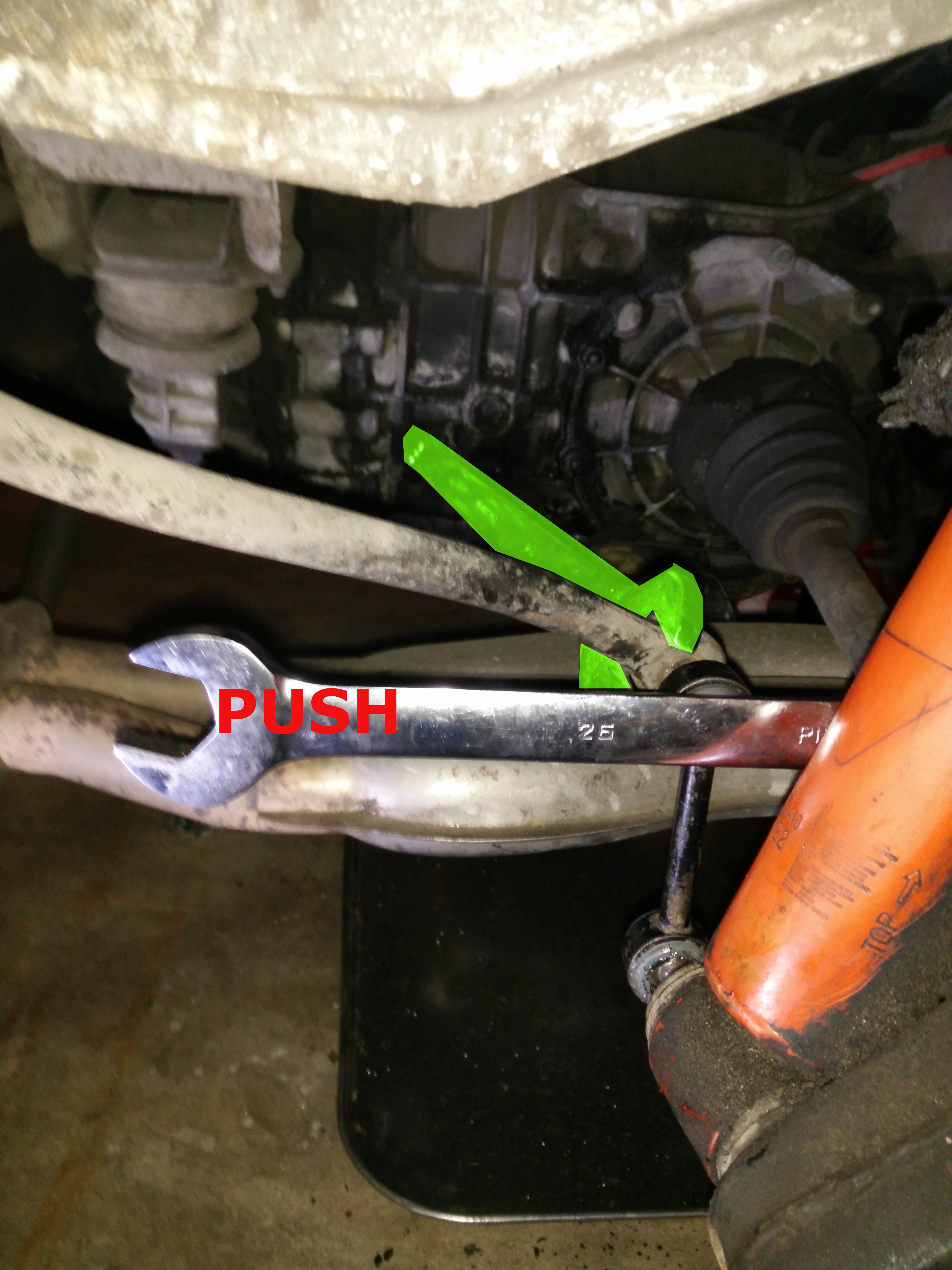

The top bushing was easier. I used an open-end wrench to hold the sway bar in place. Then placed another wrench in front of the link but behind the rear strut. Pulling with my right hand, using the strut body as the fulcrum, and pushing with my left hand I turned the wrench into a lever. The bushing popped right onto the sway bar with little effort. This was for the passenger side, the driver side was opposite, so I pulled with my left and pushed with my right.
I hope this helps. Oh, and here's a pic, for the visually dependent.
