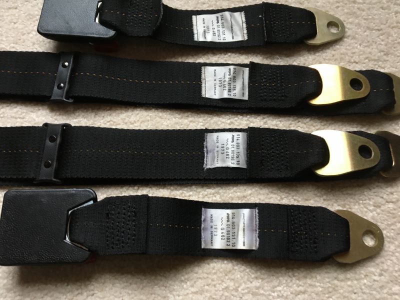

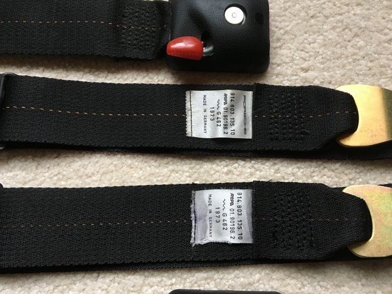

Link to Mike Fitton's post on his NOS set of Euro 73 MY ones:
.... (My guess is that apparently they kept the non-retractable belts longer there, or else these are 73 manufactured replacements for the early 70-72 type belts with the holster.)
http://www.914world.com/bbs2/index.php?sho...=NOS+seat+belts

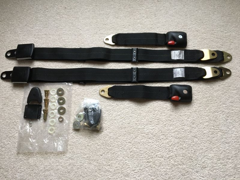

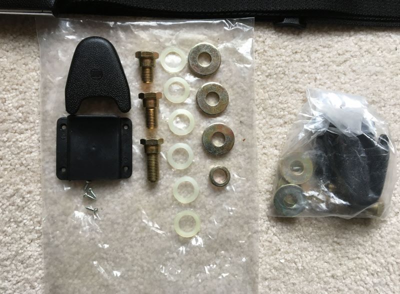

The NOS Holster is in the bag with teeny-tiny screws in this pic from his post linked above:
^ More photos added above as later edit for clarity on the full contents of the ealry 70-72 era seatbelt kit's contents. IMHO, the fact that the single seat belt holster & its 4 small mounting screws are packaged in the bag with the rest of the seatbelt hardware, is yet another indicator that it was a standard issue item which was - or should have been - included on all 70-72 914s within the date range noted by my 914 expert.

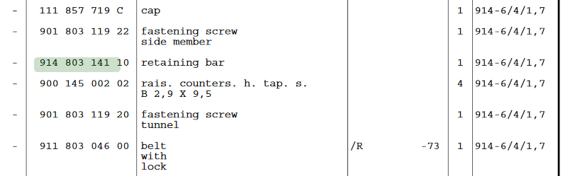

As a further indicator that it was intended for the 70-72 914s as a factory item - not a dealer accessory as some have contended, the pic clipped from a parts manual posted in post #14 below by SirAndy - it indicates the 914-6, /4 & 1.7 sub-models of the 70-72 MY era, & is similar but easier to read than the small pic of it where it's called a "holder" from Glenn S's. pic above. ----v

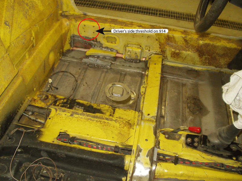

Another pic from the above topic of Paul's 70 914/4 with the seat belt holster holes location called out:
