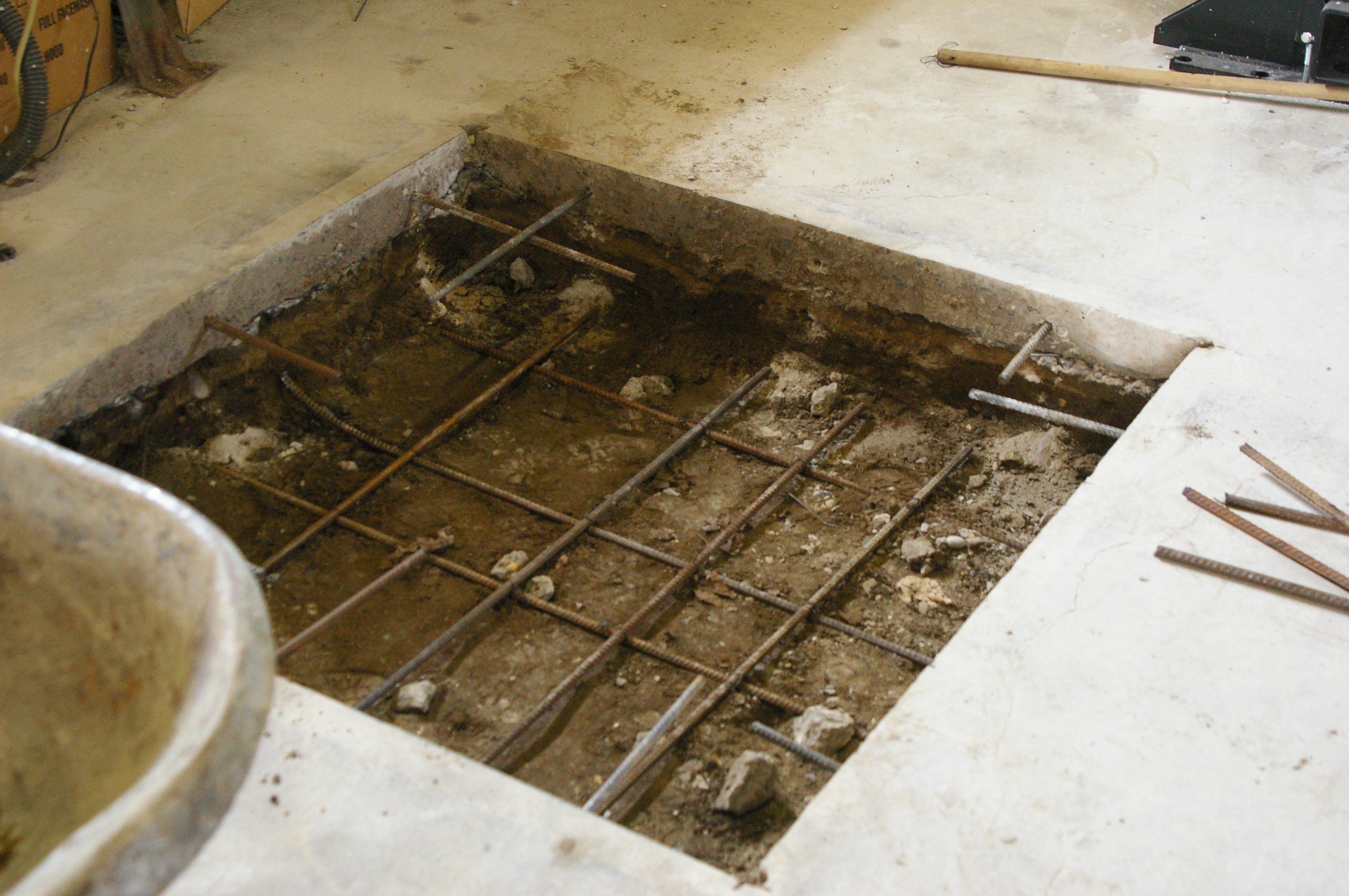

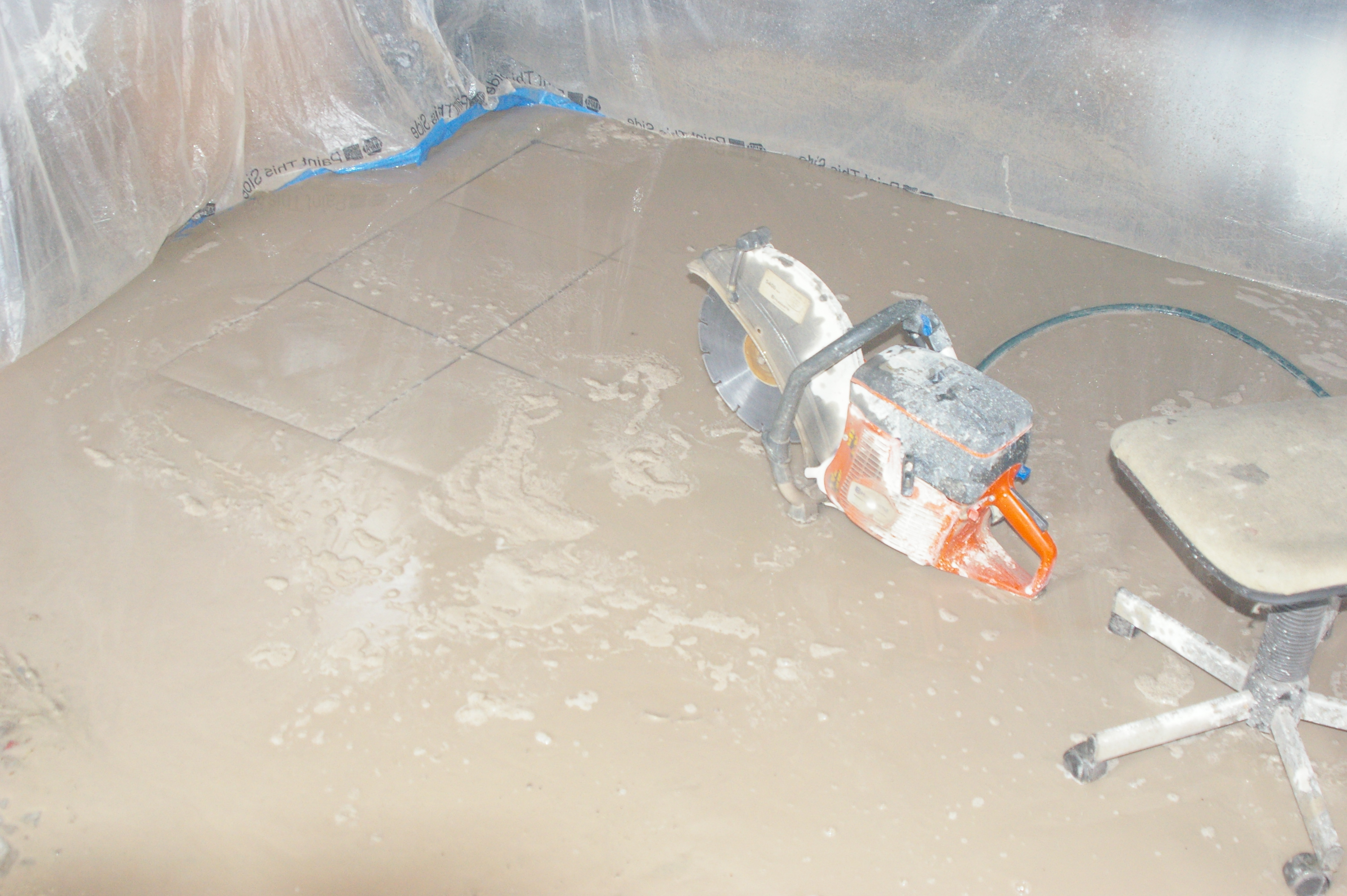

when I cut the floor for a thicker pads I used a concrete saw with water, made a mess but didn't create any dust. I used floor anchors that were epoxied in, they are not going to pull out

my floor was also only about 4", IFIR they recommend at least 6". I poured 4' x 4' pad about 8" to 10" thick of high psi cement

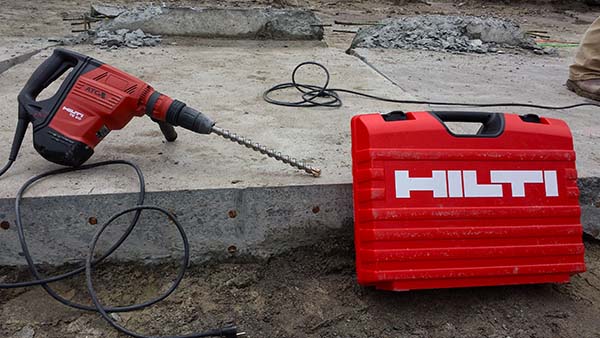

Nope, being good had nothing to do with it. That's why I rented a Hilti, which is a big ass pro hammer drill.
14 holes, seven per side, I don't even think it took me 15 minutes to drill all the holes.
I think it was $40 for 4 hours. I bet it would even go through rebar. The right tool for the job.

You are right. The OP never said he used a hammer drill.....can.t imagine using a regular drill....but that is just me.
No wonder it took him so long.

There was a picture somebody posted which showed rebar in the concrete but it was flush to grade. Ideally...the rebar should be dobied off the grade at least a couple of inches.
......and use a hammer drill for the holes or wet set j hooks on templates for the lift.
