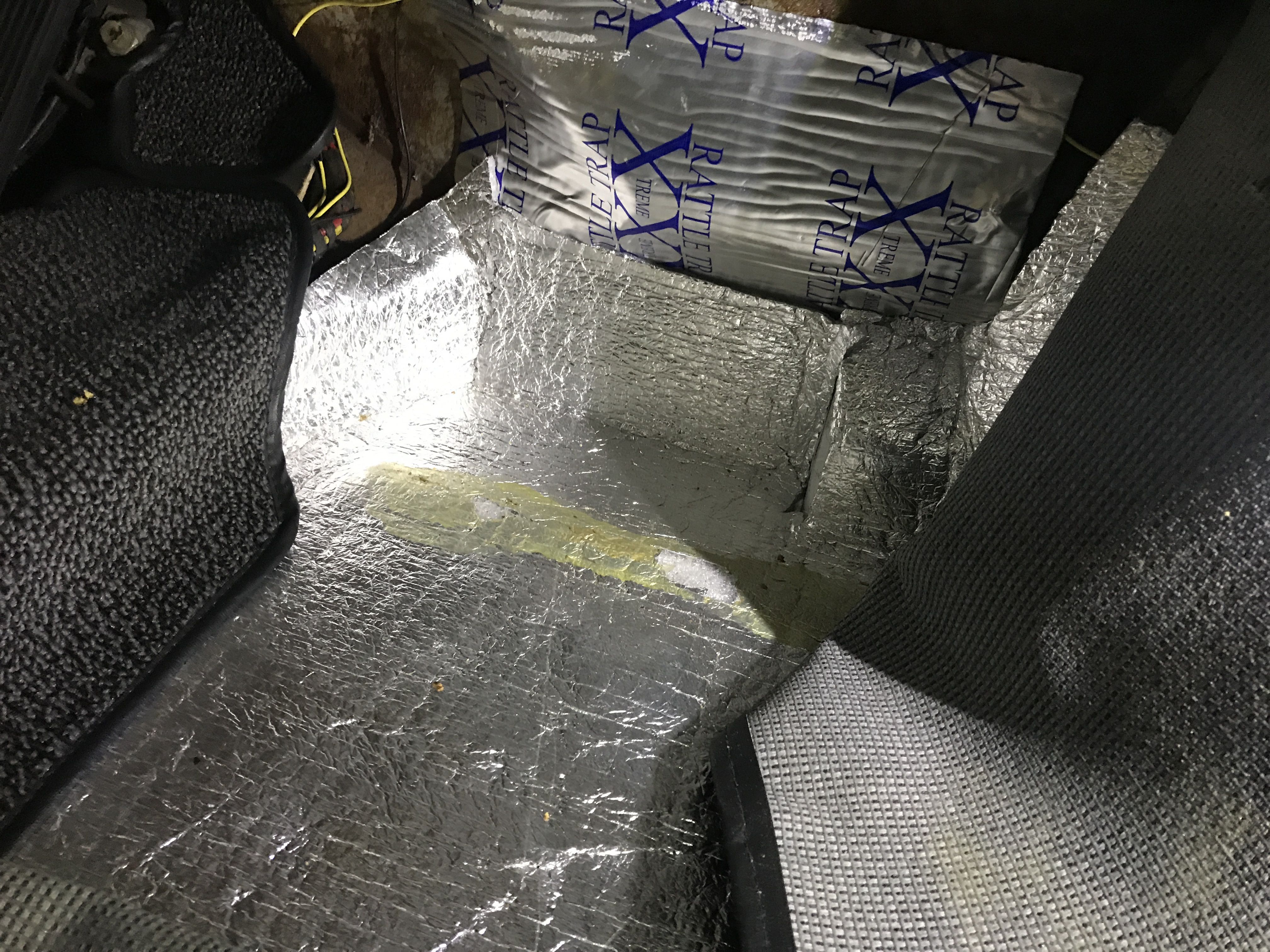

Garland
I have reduced the size by cutting it down, and would like to finish it off with the same look where I cut it.
A thick varnish may work?
Tom_T
QUOTE(Garland @ Jun 16 2017, 12:13 PM) *
You can't use anything solvent based, or it will melt the foam.
Maybe a brush-on water-based urethane varnish from the DIY might work, but test a small area 1st.
Tom

porschetub
Its not polystyrene so won't eat away with solvent paint,appears to be the same as spray foam but done in a mold.
You could always test with the cut offs to see if you have a reaction but you should be ok.
Garland
QUOTE(porschetub @ Jun 16 2017, 03:19 PM) *
Thanks for all the fast responce, I did try solvent on a cut off, held up fine. Now on to paint, and the color. Here a pic of what Im doing. Full story will be shown in my Michigan Build link, soon.
