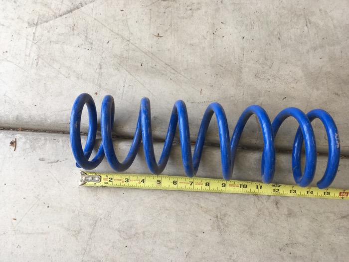

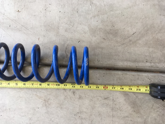

I got a pair of these in a batch of misc. 914 parts. Or rather, we think these springs are for 914. Very blue, 1/2" wire, 14" free length, about 7 coils (allowing for the flattened ends), correct diameter for 914 at 4.25" (110mm?). Seems like they'd be rather stiff. Anyone recognize them? Need to figure out what they are before I offer them for sale.

Those are similar color, but lots more coils and thinner wire.

Look like Weltmeister 140# springs... Mine had the number 140 on the outside of the spring coil.
arne
I looked again at both springs carefully, Rob. No marking at all. Drat! The Weltmeister 100 lb. I put on the rear of the car are black and well marked, both brand and rate.
The 100 lb. springs are 11mm wire, these blue are a full 1/2" (12.7mm). so probably at least 140 lb., perhaps more.
Would be nice to know for sure though.

I have a similar set, mine are black with a gray stripe.
14 1/8" long and 7/16" wire.

You can calculate the spring rate pretty easilly. you need the free length, , number of sprung coils, wire diameter, coil diameter, and end style. You can guess on material since all of the steels are pretty close.
Http://www.thespringstore.com/spring-calcu...calculator.html

Look like the 200lb springs RH was selling back in my day.

OK, that sounds likely. The guy I got these from has had them a long time, and had no info on them from the guy he got them from. I've used a few online calculators and all have come up a bit over 200 lb/in.
