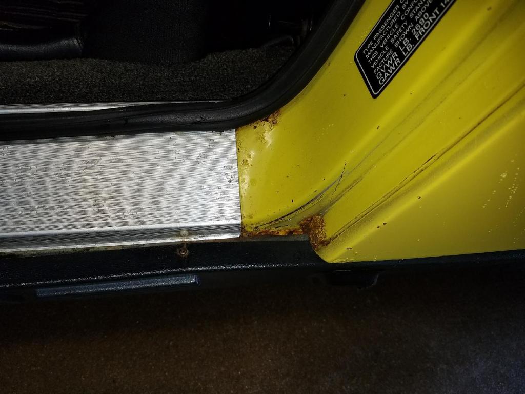

Not looking for a concours car, just one that I can drive and slowly fix over time. The troublesome spots include the jack point on the passenger side, both sails seem to be "crunchy", driver door jamb has a little bubbling at the bottom.

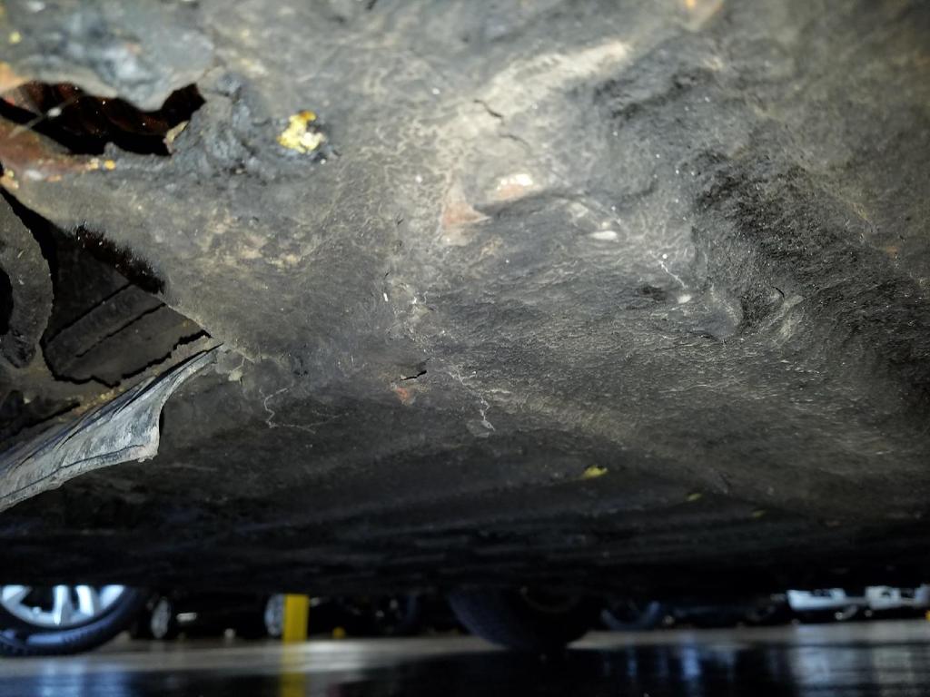

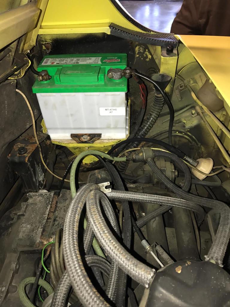

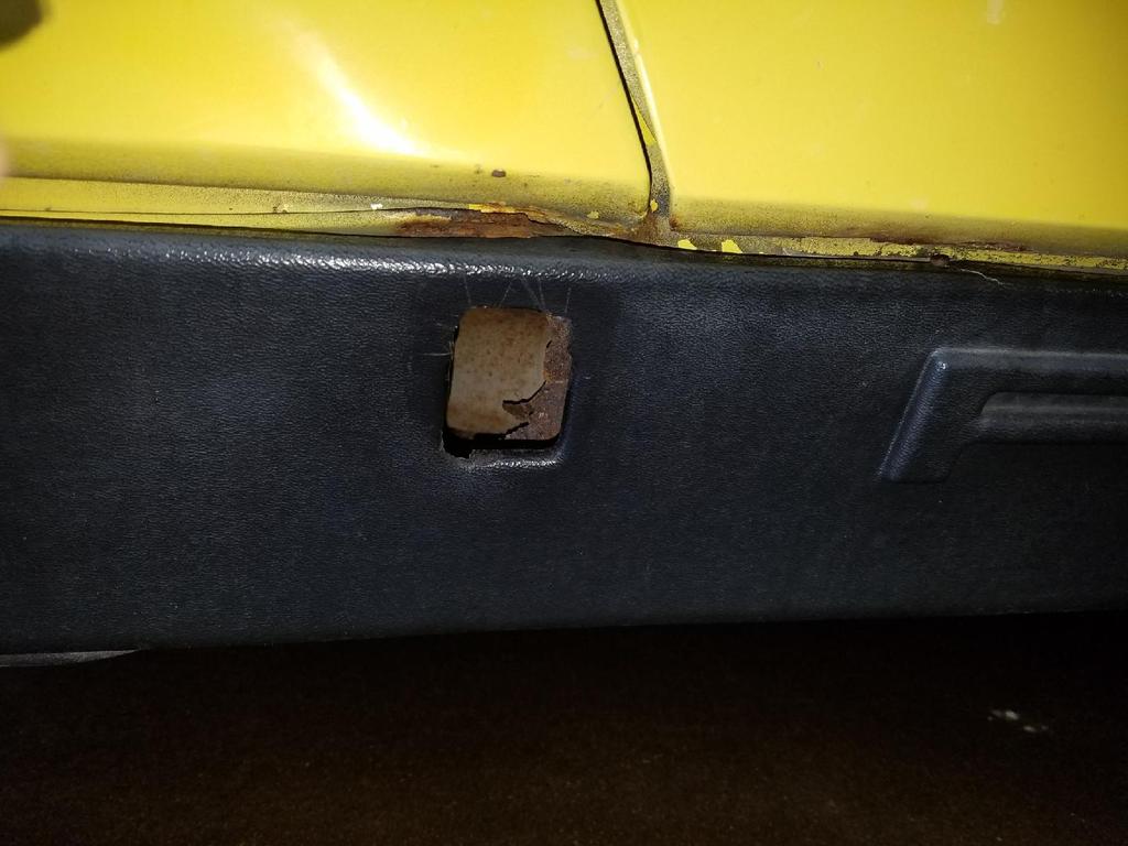

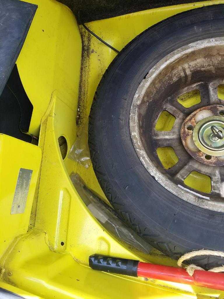

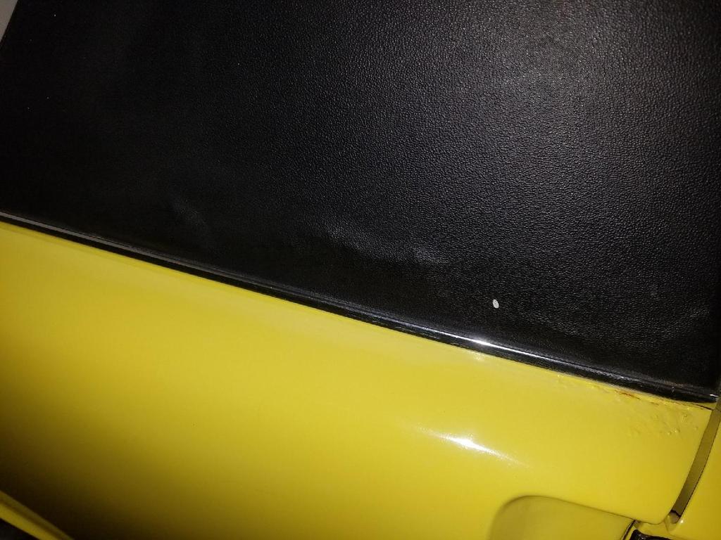

Additional photos:

PS - From the pix you've added above while I was typing, it's got definite rust issues - the question is how deep - & the hell hole repair may not have done it all properly which could just be a new tray+support with POR over the rusted wall - can't tell from pix inside, but last 2 pix of jack support & underside indicate a rusted out longitudenal, & who knows what else hidden under the underbody coating! More rust is growing elsewhere too - e.g.: the pic behind the door handles is always rusting from inside up-n-out due to the factory foam inside, so it's never simple surface rust - I know, I've redone mine 3x since 1975! dry.gif !

Even as a 2.0 car, based on the photos of the underside, make sure that you get the car up on a lift with the rocker covers removed before going any further as well as getting an independent PPI to evaluate mechanical.

Looks like the one jack point is pretty gone. Makes me very suspicious about how much rust is in the longitudinal around it. Which leads to questions about the integrity of the suspension console.
The bubbles in the paint near the sail panel are either really awful body work starting to fail, or rust coming through from the underside. The stuff in the corner of the door frame might also be coming through from the back, or might just be some surface rust.

Rust. They're showing you the best of it. The pass door side handle recess is pretty suspect to me. You know they're not going to give you a peek behind the rockers. Unless replaced i'm will to wager the heat exchangers are rotten. Smart move flying in. Be prepared to turn and walk away.
