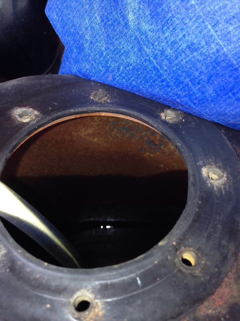

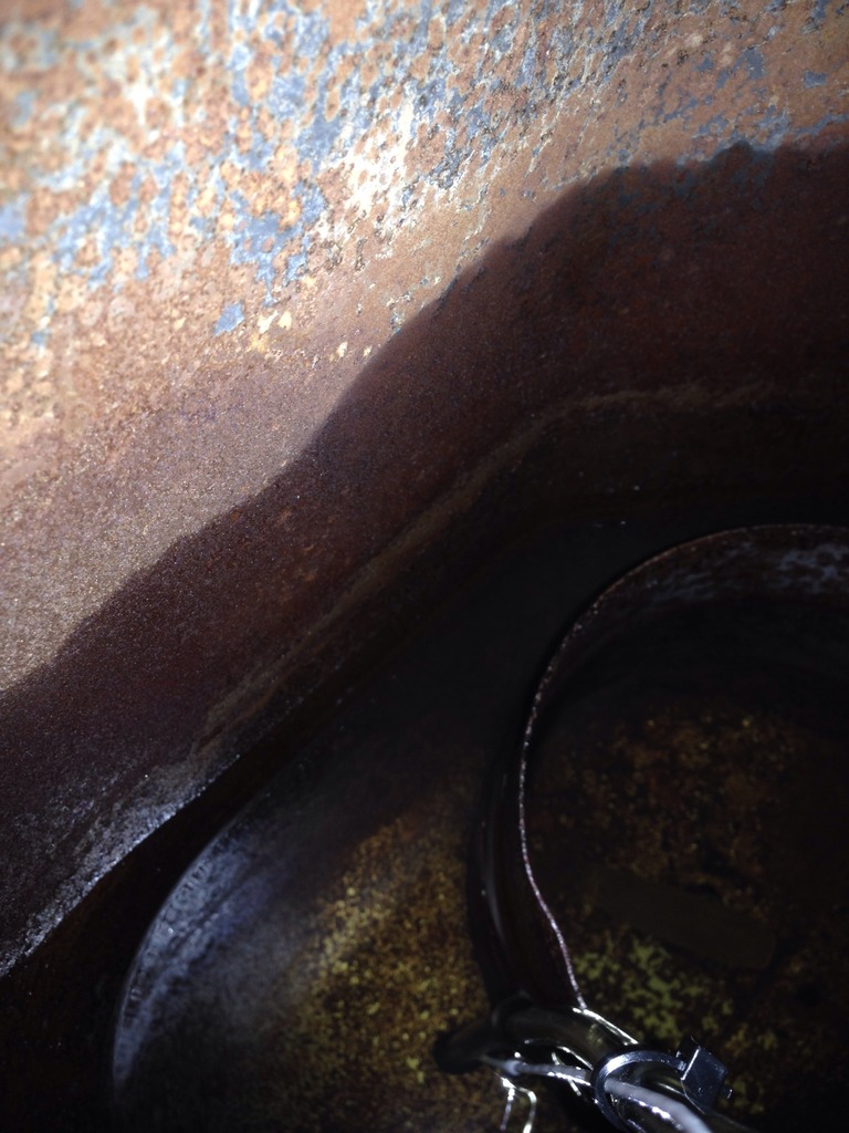

I pulled the tank this weekend. There's a decent amount of surface corrosion in there. And it looks like something took a dump in my filter. Just ordered the POR15 fuel tank repair kit. I imagine that's where the issue came from. I'll post up some pics soon.

Here's some pics of the tank so you can judge for yourself.
IPB Image
IPB Image

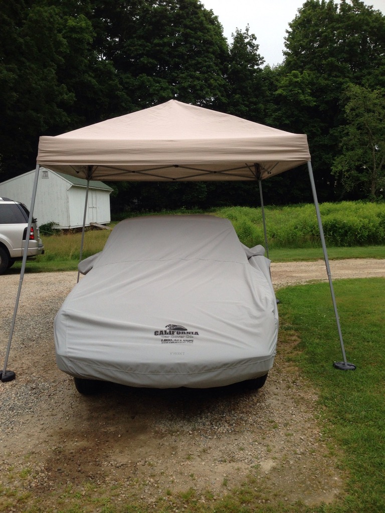

The "garage"...
IPB Image
IPB Image

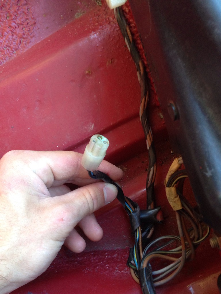

PS can anybody tell me what this plug on the driver side of the rear trunk goes to? I presume it's for some optional component I don't have...
IPB Image
JeffBowlsby
D-Jet injectors should measure about 2.4 ohms.
The rear trunk plug is for the CA-only model accessory CAT light indicator relay/probe.
