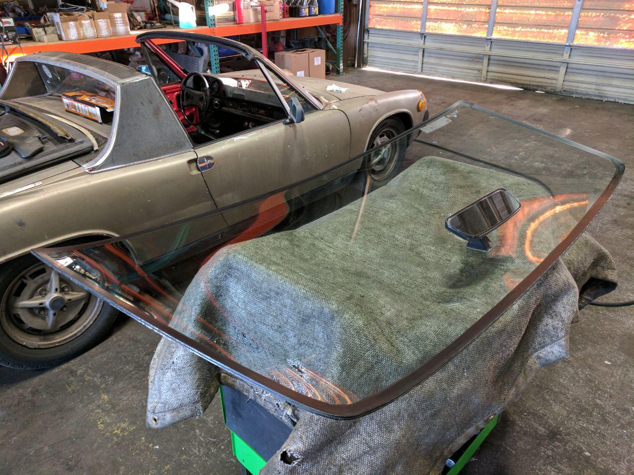

Here's the windshield itself, cleaned and scraped and wiped as spotless as possible with ammonia free cleaner, alcohol, and finally dried before the primer was applied.

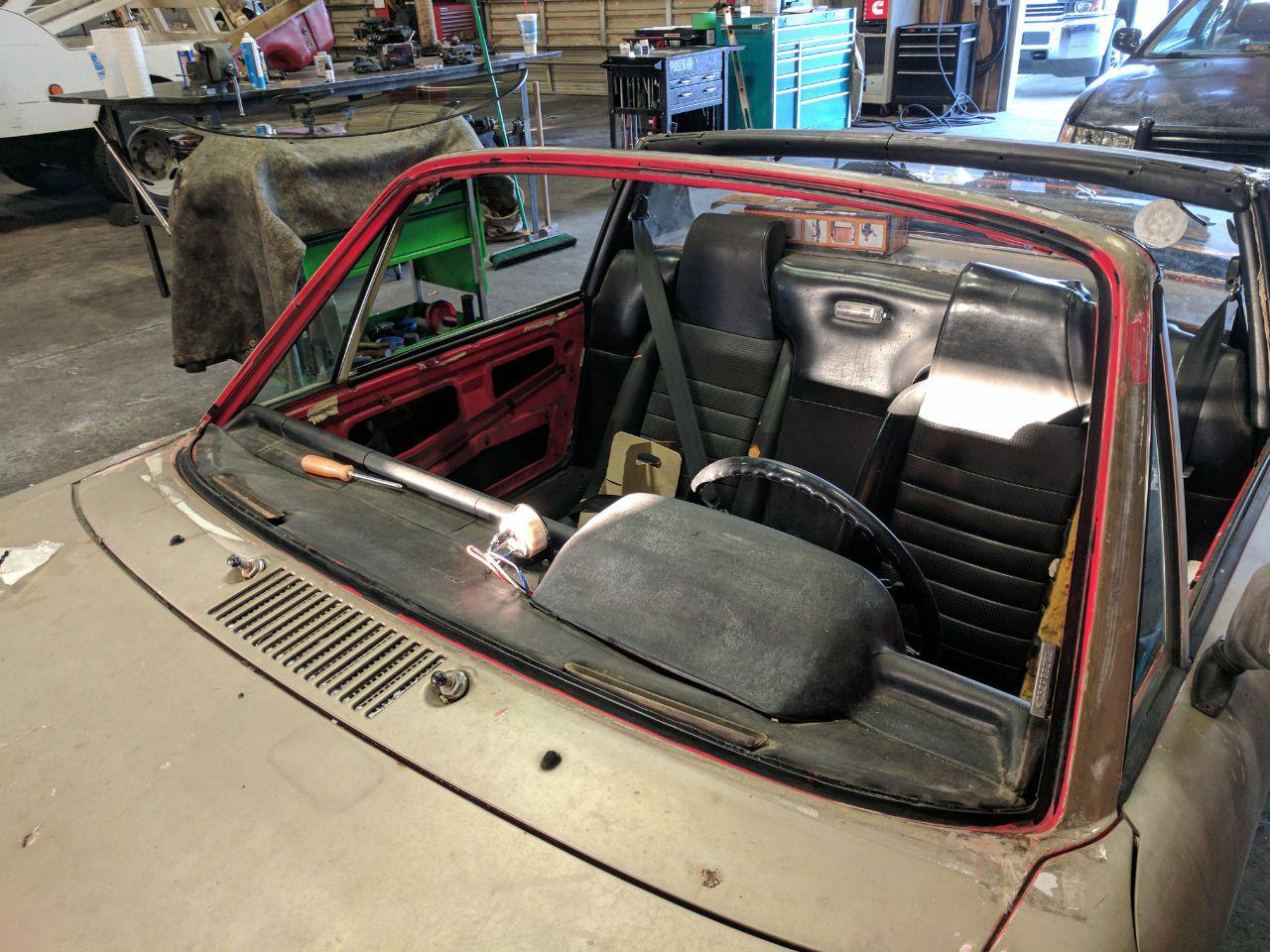

And here's the windshield frame, similar cleaning treatment was given with alcohol.

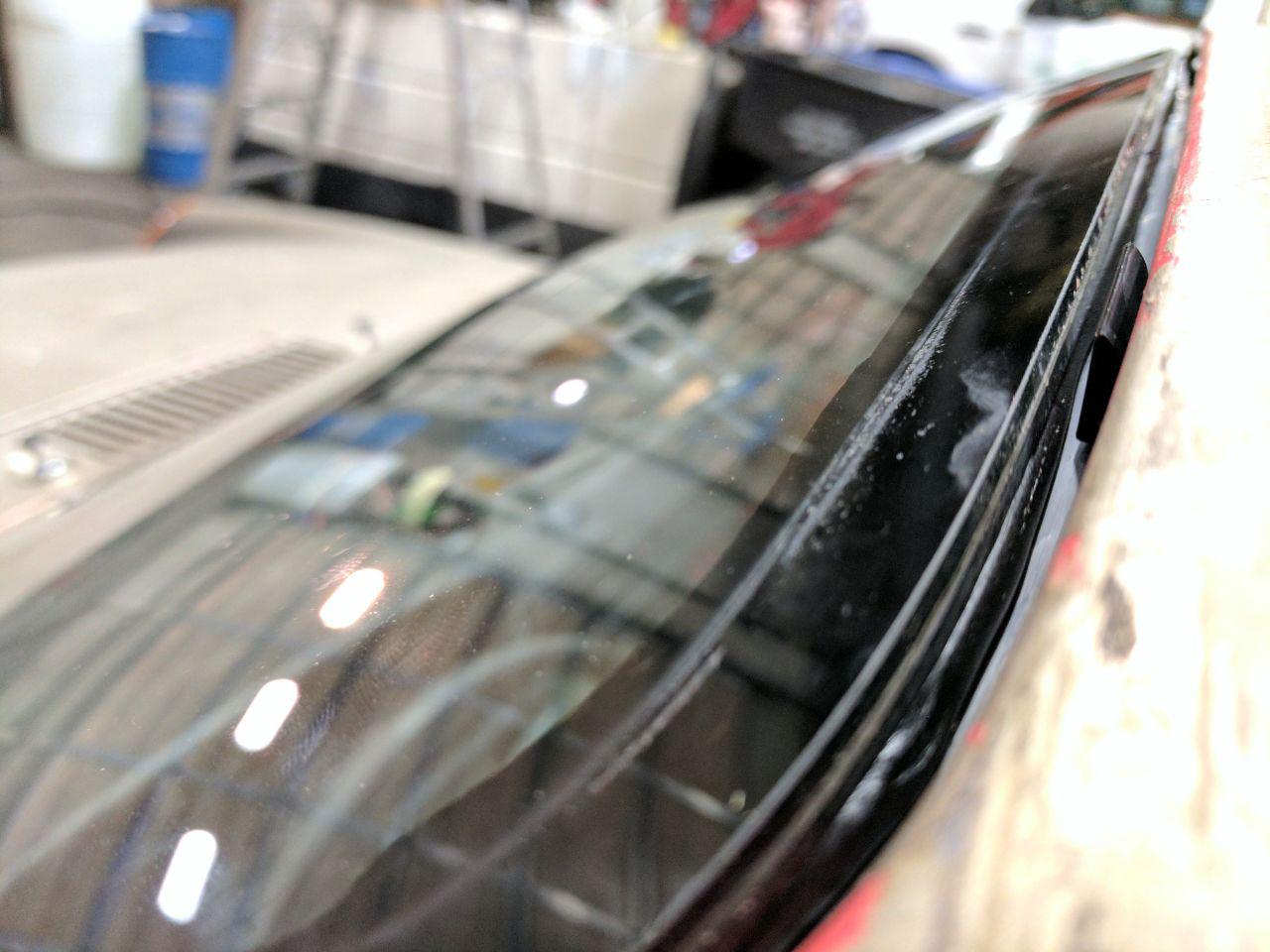

Work slowly and CAREFULLY when pressing it into place, especially around the corners to avoid cracking, should look something like this when it's all set in place.
IPB Image
Use the spacer blocks and preferably a buddy to help you guide it into place.
The warmer the better. Mark / Mikey explained the original butyl strip had a thin wire in it to heat it up.
