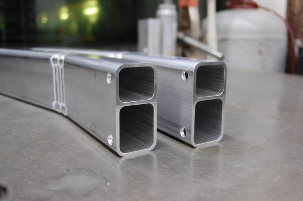

hi guys,
i'm working on a bike project and are looking for "bridged" rectangular tubing for a swing-arm design.
I have been googling high and low and can't find a source in the US.
Any advise where I can get in the US or Europe?
Thanks,
dc
Elliot Cannon
You can try these guys but they might not have what you need. http://www.aircraftspruce.com/categories/b...e/aluminum.html
Chris914n6
Extruded aluminum. Usually made to order for a specific purpose, like car bumpers.
You'll likely have to weld 2 normal stock tubes together.

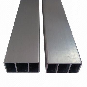

The tube in the first pic is filleted. Most likely aircraft grade. The tube in the 2nd pic is not. Most likely non structural.
914_teener
Aluminum Shapes in Montebello California.
Try them. Looks like you are looking for a custom extrusion. Something in their die lots should come close. T6 is a post hardened condition and may not be available on certain shapes.
Good luck.
