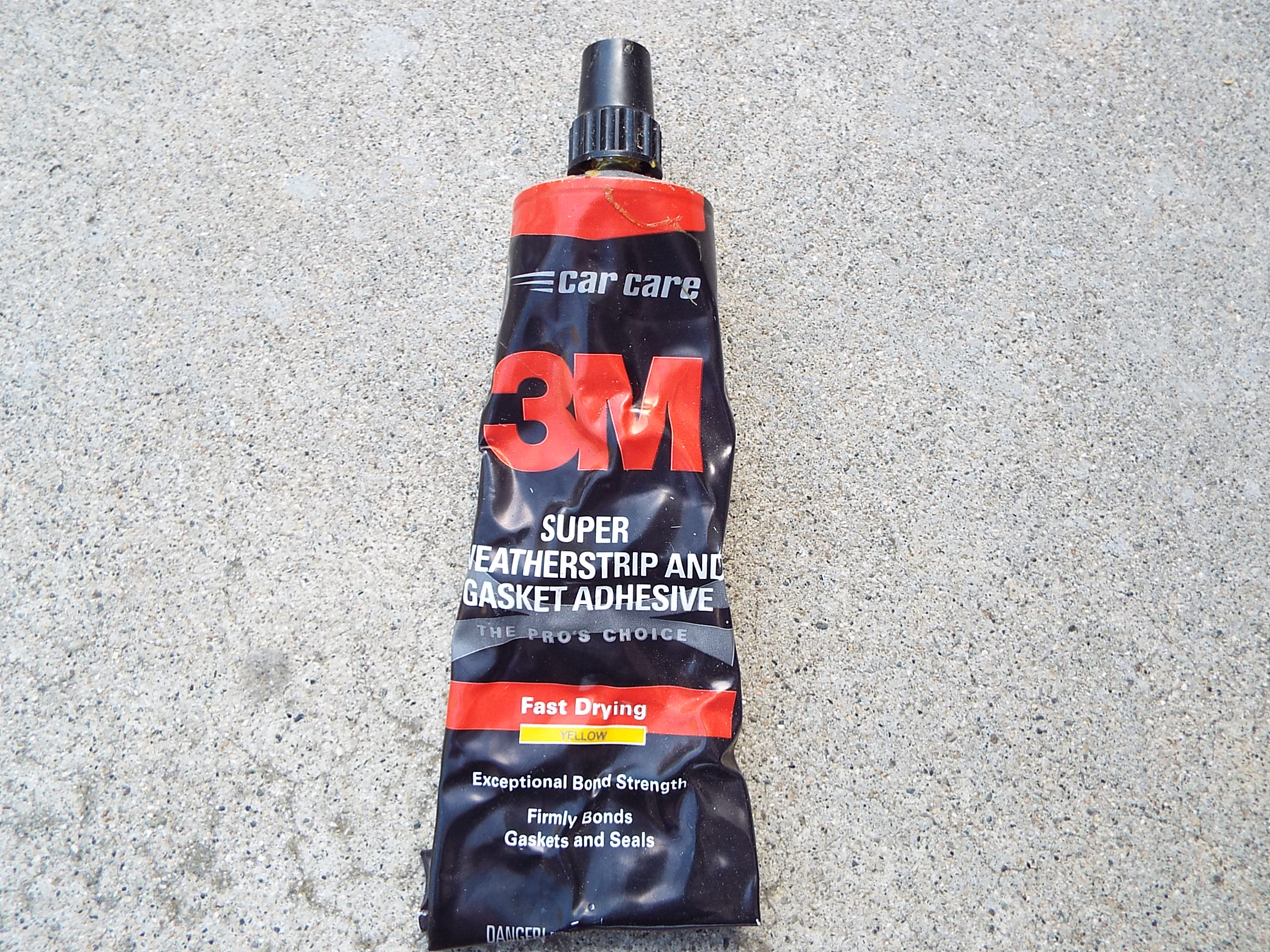

I used this. 3 M Super Weatherstrip and Gasket Adhesive. Yellow. Commonly referred to as "snake snot" worked perfect on mine
Good luckClick to view attachment

QUOTE(Lucky9146 @ Jul 5 2017, 09:31 AM) *
I think that there are black gasket adhesives out there which will do as good of a job & not scream YELLOW around the edges of your gasket.
Permatex makes a good one which we used on our 88 Westy's pop-top seal, which has a lot of pulling forces when lifting the top up.
And what mark/Mikey914 said - whether his 914Rubber repros or factory seals - the bottom is usually flat(-ish), & IIRC the 914 Factory Repair Manual says to run a small bead in the tray on the body [not on the seal bottom].
If not adhered, then the seals tend to pull apart at the 8 corners - especially the front corners ones around the headlight buckets.
If yours tear/separate, then you can use that same Permatex gasket/seal adhesive to repair them with a dab inside the joint at the corners, then adhere in place in the tray.
Further to my earlier post. You should not see any adhesive as you only place it in the very bottom of the channel the gasket sits it. Be careful not to get it all over the place when applying in the channel and you may want to mask off while applying. I do not know about the black suggested above but I do know this adhesive works well and I have used it with good results over the years.
Let us know how it turns our for you what ever you use.
