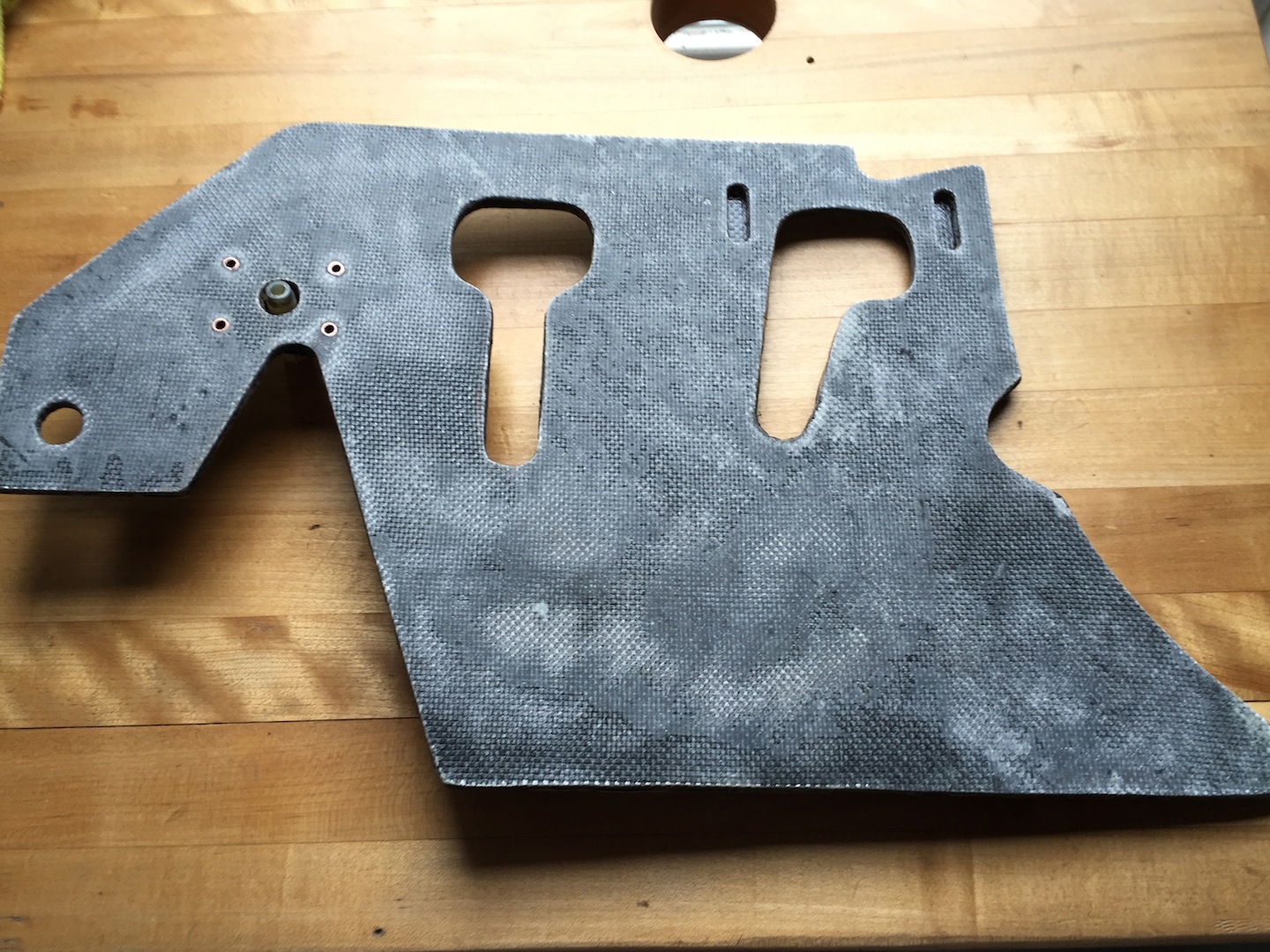

Check 914Rubbers fiberglass backpad and backpad vinyl.
Looks like this when it's in:

The biggest problem you'll find with the 914 Rubber back pad is that's it's made of fiberglass so staples won't go through it. MPITA. I repaired my fiberboard original the best I could using a fiberglass repair kit but the repairs were not where the staples go. I'll put a couple of pics here in the coming days.
Not saying anything bad about the 914 Rubber part....it's just not easy or straight forward to work with.

I worked with an upholstery shop (and coincidently, now, so is 914Rubber) that made that same suggestion. On mine we attached a tack strip and we sent Mark a sample of it. Look for the next-gen backpad fiberglass to have that improvement.

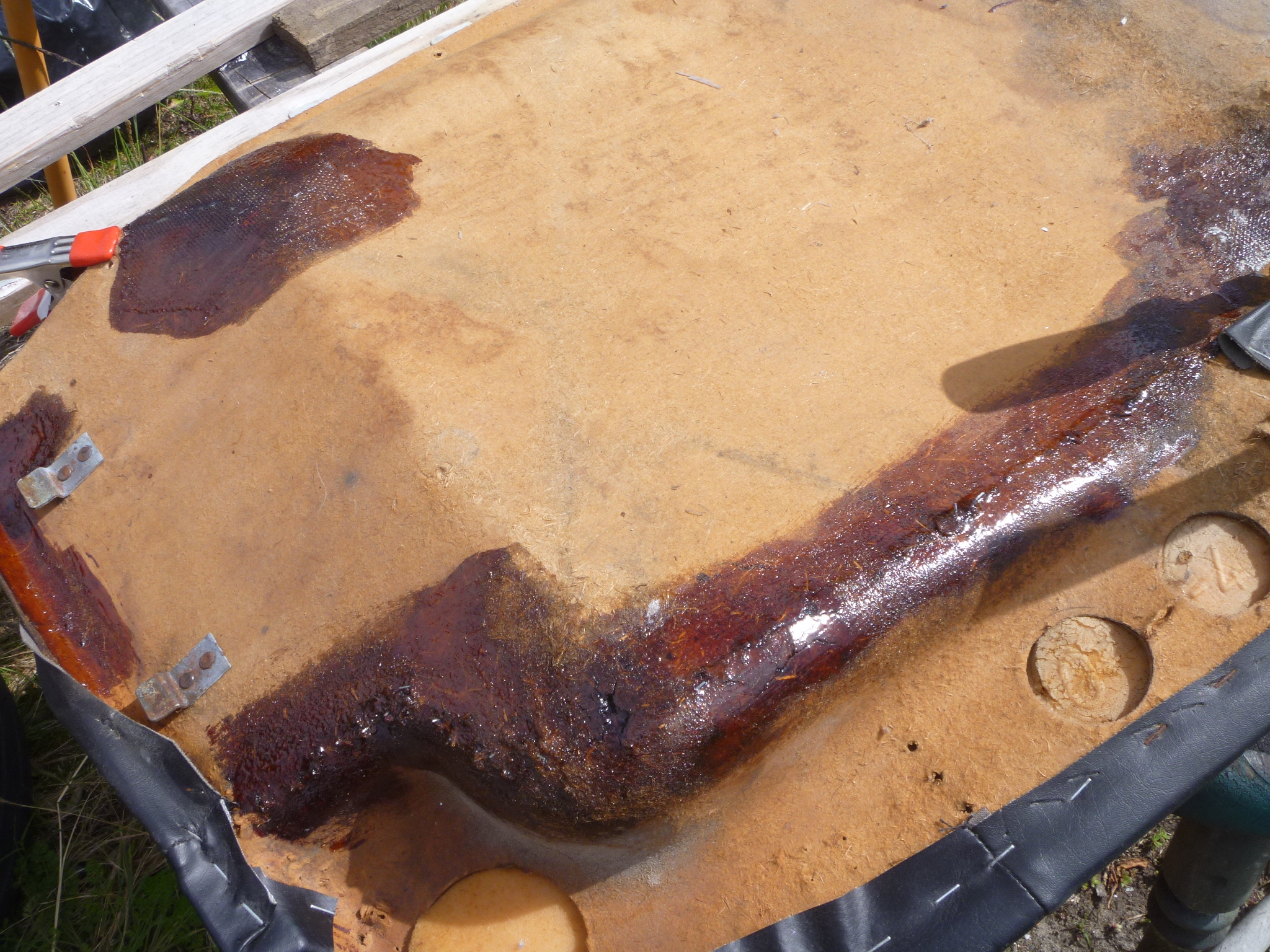

i did my own repairs on the fiberboard backing using West System epoxy and some
e-glass cloth. I happen to have this stuff around for marine repairs. No photos of the back pad repairs, but I did a repair on pedal board; glass on the backside & carbon on the front:

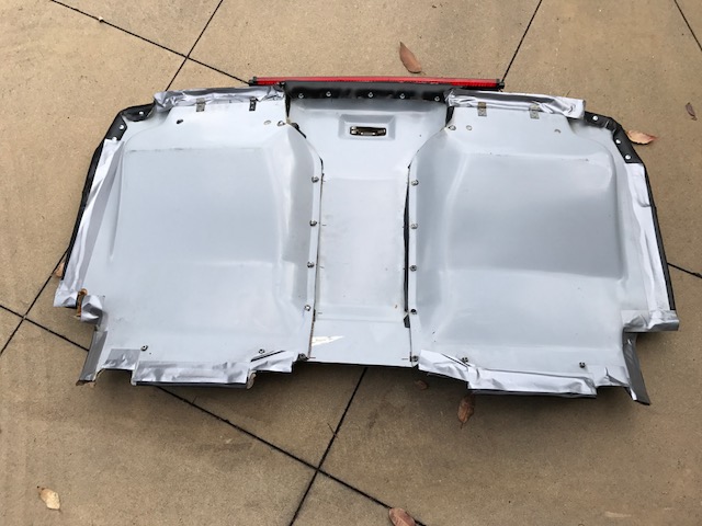

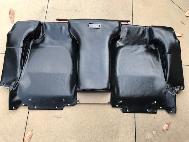

I used the 914 Rubber fibre glass boards and glued with 3M upholstery glue and screws with clips in critical areas. I ground off the sharp screw ends and covered with strips of duct tape. I learned the hard way to protect myself from the drill cuttings/dust when working fibre glass!Click to view attachment Click to view attachment Click to view attachment
