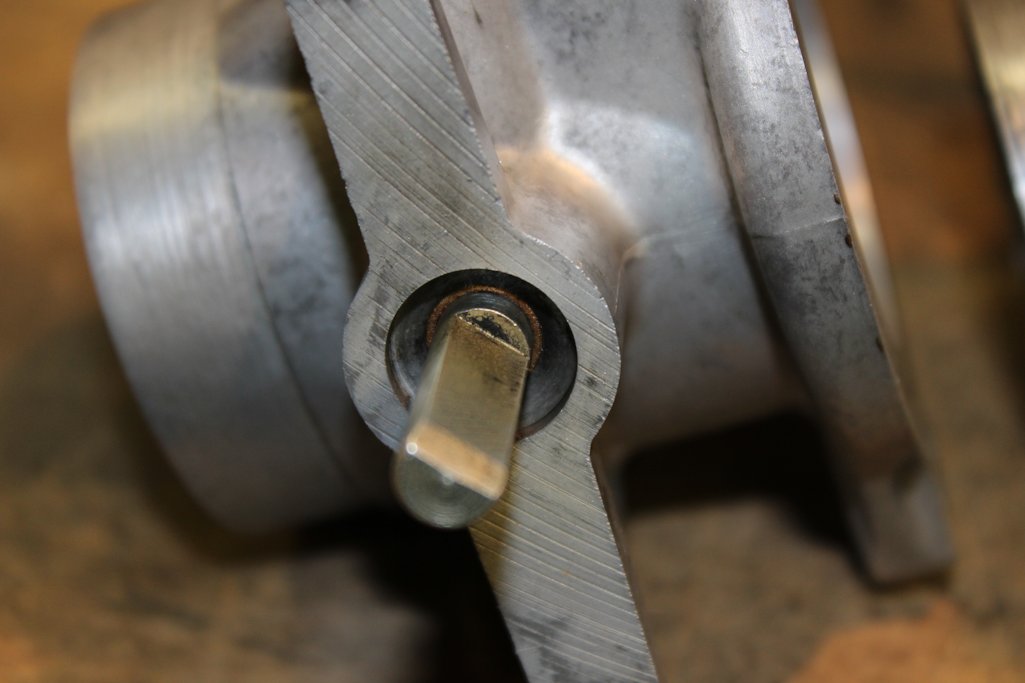

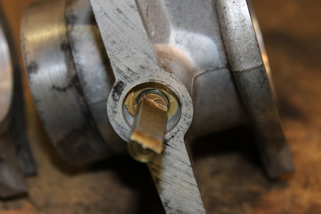

Recently I got tired of my sticky uneven throttle body. I was stuck in construction traffic and inching forward became almost impossible. I decided to repair mine. The throttle body shaft has no bearing. It is steel against aluminum. In time the round hole becomes an oval one. This makes the throttle plate operate erratically. It even sticks when in the closed position.
I made a setup in my machine shop to repair these. I accurately locate the shaft hole and boar it to fit an oilite bushing. I have done a dozen of these so far. In my car, the difference was incredible. I expected the operation off idle to be improved which it did but I also found the operation was smoother through the operating range.
I decided I could offer this as a service. In this, I will clean the body and install the new bushings. This operation requires special machining in order to keep things aligned properly. At this point, I am not plating anything. I am only cleaning the steel components. I may offer plated parts later but not at this time. I will need a core in exchange for one I send out or I can repair yours but there will be a delay in doing this. There are some that have 2 ports and some with only one. Some have a built in return spring and the other does not. You can see the differences in the ones pictured.
If you are interested in this service, My starting price is $125.00 plus shipping

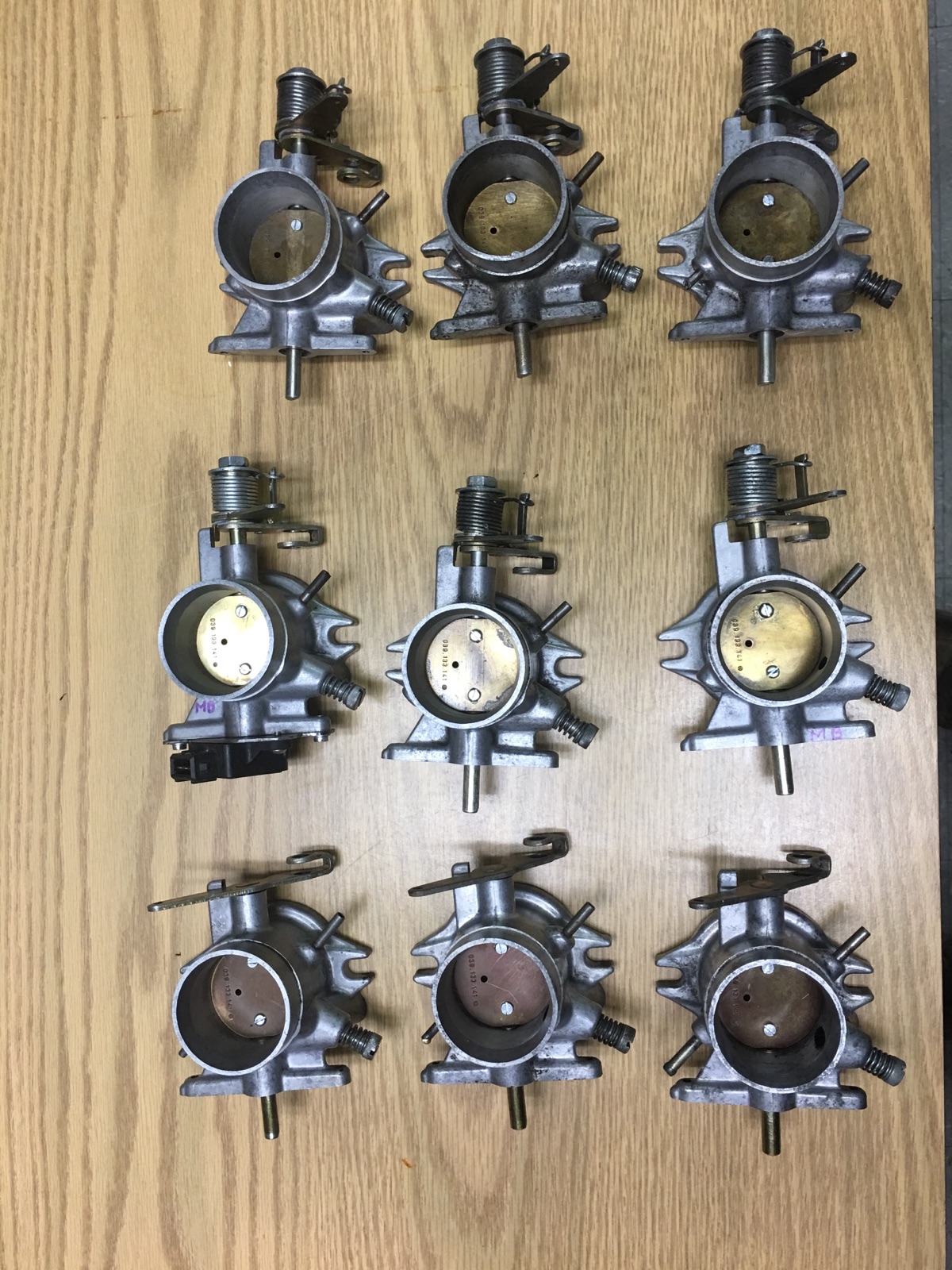

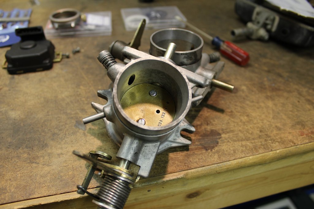

McMark
Sep 12 2017, 10:43 AM
Got mine back a little while ago and finally took pictures. This'll be going on my 1.7 Turbo engine when I have time for that. I thought the part I sent in was in great shape. I didn't even think it really needed rebuilding...but what I got back was even better.
Bottom line is that pretty much everyone needs this service.
Pictures- I sent my own parts for zinc plating, and the TPS is for my MicroSquirt setup.
