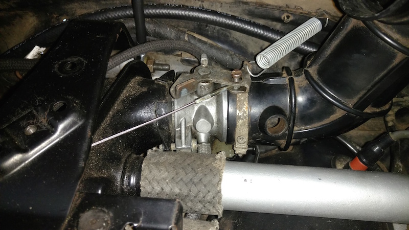

clapeza
Aug 13 2017, 05:49 PM
I did some voltage testing, all at the battery:
Car off: 12.26v
On, not running: 12.1v
Running, idle at 1000 rpm: 12.6v
Running at 2500 rpm: 13.2v
Running at 2500, with throttle cable and return spring disconnected: 13.6v
One thing I forgot to test was voltage between the throttle body and chassis with the cable and spring disconnected while running, just for completeness.
Here's the picture of my throttle body, with the throttle cable and return spring in place. I did remove the air filter assembly, for clarity. (The fuel line is not as close as it appears to the return spring.)
Spoke
Aug 13 2017, 07:04 PM
This is really weird. The entire engine case, FI components, spring, and cable should be at ground potential. The FI plenum should be connected to the engine case. The engine case is connected to the trans which has the ground strap to the chassis.
I'd never think of testing this but what is:
1) engine case voltage to chassis ground?
2) FI plenum voltage to chassis ground?
3) fan shroud voltage to chassis ground?
4) Pull alternator adjustment cover and measure alternator case voltage to chassis ground.
There should never be a voltage from the return spring to chassis. That whole lump should be at ground potential.

clapeza
Aug 16 2017, 08:08 PM
I did some quick testing this afternoon, and came up with a theory afterwards.
First the data:
Engine running, throttle return spring disconnected:
1) Engine case to chassis ground: 0v
2) Fan shroud to chassis ground: 0v
3) Alternator case to chassis: 0v
4) FI plenum/Throttle body to chassis: 12v !!
My theory: Obviously, something is introducing 12v into the plenum/TB. What if it is the AAR? If the wire is wonky and it's not letting its current into its innards, but rather passing straight into the case, through the plenum, into the throttle body, and then through the throttle return spring...which is acting like the heating coil that normally resides inside the AAR?
I haven't had time to test it yet. All I have to do disconnect the AAR wire and see if I get a voltage through it and heats up the spring. I'll try it tomorrow and report back.
What'cha think?
Possible?
Spoke
Aug 17 2017, 04:02 AM
It is possible that AAR wire is shorting to its case or shorting to the plenum. Absolutely disconnect the AAR wire and make sure the wire is not touching anything. The wire is always 12V.

clapeza
Aug 17 2017, 05:46 PM
GOT IT!!
I disconnected the wire to the AAR and started it up. I checked the voltage to the plenum and the throttle body with the return spring disconnected. With the wire connected, I got 12v. With the AAR wire disconnected, it read 0v.
I connected the spring, and it stayed cool. I wiggled the spring a bit, and where previously I'd see a little sparking, now there's none.
The fresh coat of paint on the plenum must be enough to electrically isolate it from the engine case. When I take it out to replace the AAR, I'll clean off where it touches the engine case.
Thanks, everyone, for all your help on this problem. I couldn't have solved it without your guidance and input!
