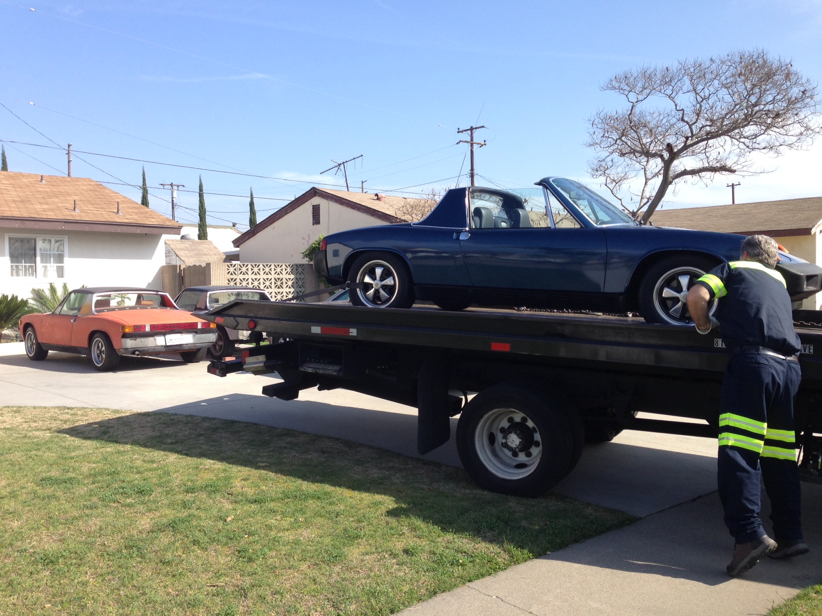

Hence the flatbed thread. Congrats! You've now graduated to the next level of 914 ownership. Extra pain points for your wife being in the car.
Add your pic...
http://www.914world.com/bbs2/index.php?sho...=175444&hl=The way you've described it, sounds like an electrical issue. The same thing happened to me and it ended up being a dying coil which would get hot and quit. I'm sure the brain trust here will help you get back on the road soon. You'll have to work on your wife's confidence yourself. Jewelry helps.

If you weren't in a state of rage and happened to take a pic, post it in the "flatbed thread". Glad you two (3) made it home safe. It happens with old cars. Some of us are on a first name basis with the tow truck driver.
I was lucky enough to break down as I pulled into my driveway a few years back.
