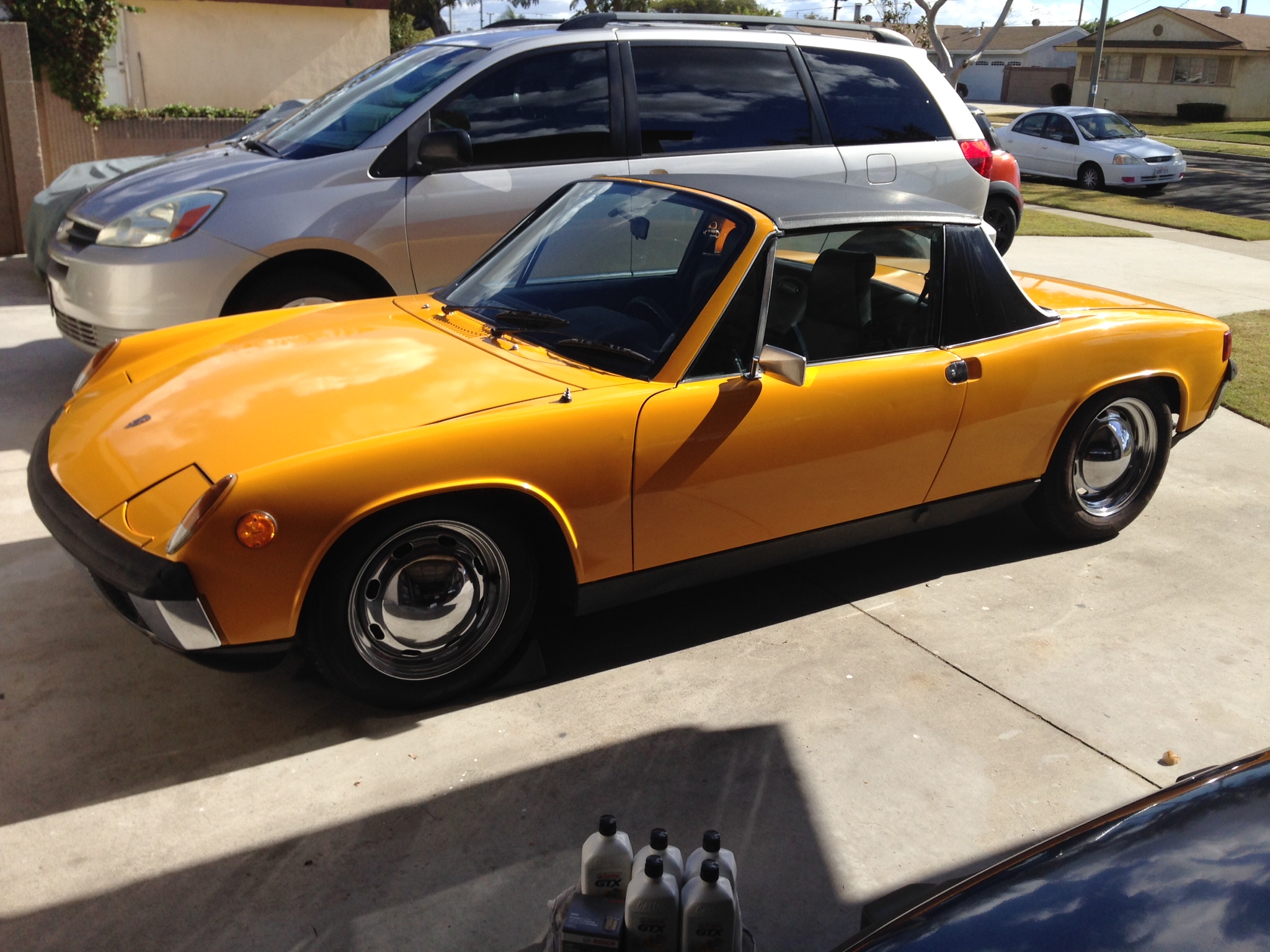

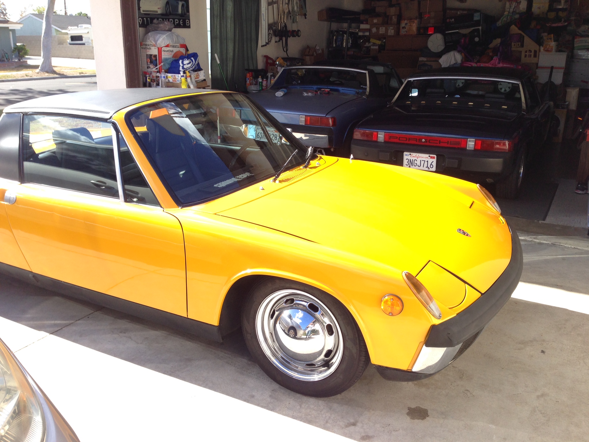

I sold my friend's 73 1.7 yellow last 2015 thanksgiving day to an Ohio member (now my facebook friend), the car has #1 cylinder low compression with single weber carb. He and his wife drove it from SoCal to Vegas and all the way to Ohio for 2,500 miles trip within 5 days (i think) and with no issues.
