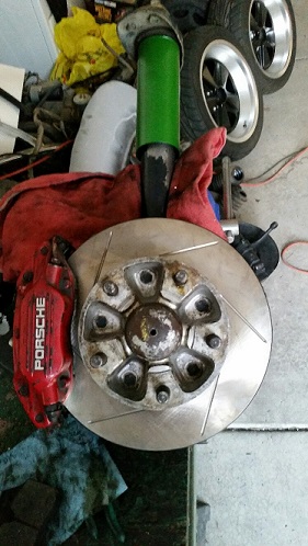

Click to view attachment Click to view attachmentTest fitting the rears - already have the fronts dialed in. Still using the pressure limiting valve with a 19 mm master. Things should be interesting...
