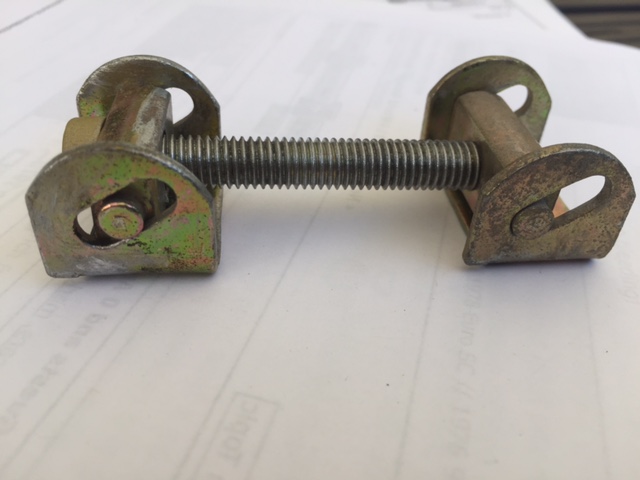

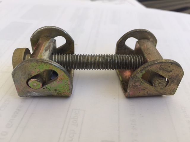

Which way around do the buckles go that holds in the tank strap? I have shown them two ways below below. Same direction and alternative direction.

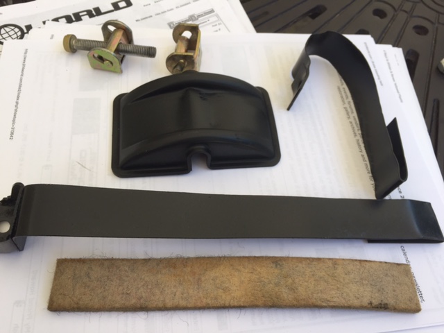

Also, does the long felt piece go under the longer metal strap?

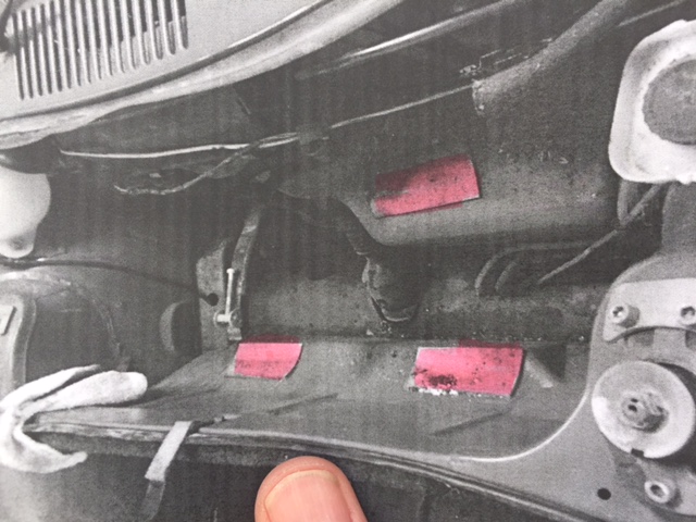

And finally, does anyone know the size of the larger 3 pieces of felt shown in the photo attached to the body? mine are missing

They go the opposite of your second picture, so the bars go lower as the screw is tightened.
There should be a short felt under the short strap too.
Not sure of the dimensions. I think I have a whole stack of them around here somewhere but haven't been able to locate them so far.
