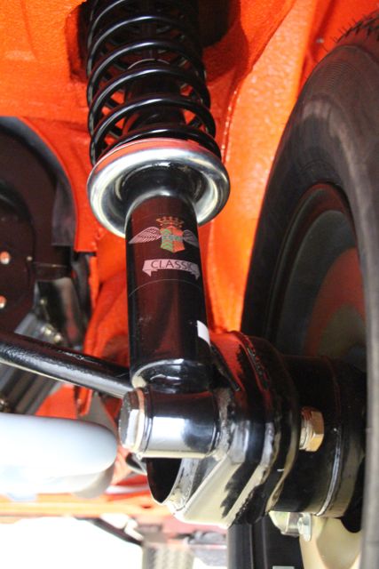

I have installed Koni Classics in my /6. Half a year ago they were available from Porsche Classic.
