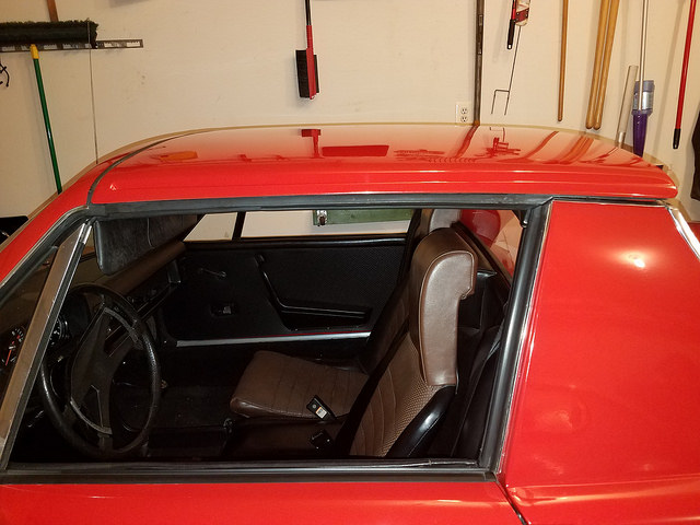

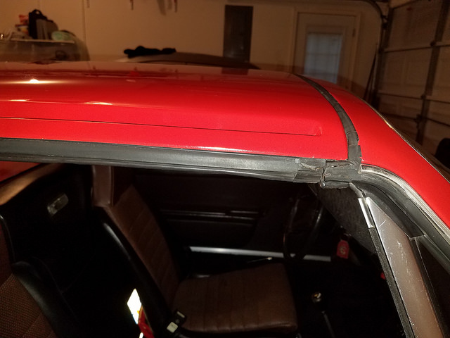

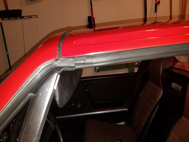

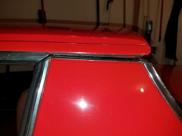

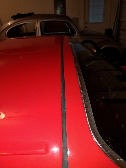

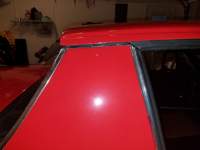

First off I am wondering if my 73 914 started its life with an early targa top and later it was replaced with a late one. I need to post pics of the fitment which I believe is not great. I rarely have the top on, but it is something I need to ensure is correct. I have checked and can say I currently have a late style top. The front has good fitment, but the rear latches do not pull the top down at all. The top is not loose, but looks kinda high in the back. I also have a book that states the factory moved over to the late style targa after my vin number (book says after 473 292 6222). Has anyone seen where adding a late top to a car that came with an early top would have an adverse affect. The doors/windows/rear latch hooks are all late style.

Here is an update of the fitment and what it looks like. Thoughts?

Any comments about my top fitment?

Something about the figment of the top seems off. I can’t comment on when the early/late top change took place. But what looks odd to me is the fitment of the front targa seal. The front targa seal goes across the top of the windshield frame and then down along the ‘A’ pillars. Where they meet the door vent window cap (the triangle plastic piece) there is what I’d call a nub of rubber. That piece on your car looks abnormally long. If that’s the case, it seems like it would be pushing the whole targa top towards the back of the car. And if THAT was the case, then the front would seem to fit fine but it would cause the back to pop up or bind a little when trying to latch the rear targa latches.
I’ll take some pictures in just a bit of what it should look like and see if my pics match your pics.

Can you show us a pic of the windshield/A-pillar seal with the top off?
Is the seal one piece or three pieces?
